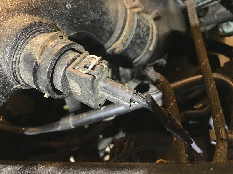

hmm pulled the sensor cable off and the can has power again and is alot quieter... but alot more smoke and still louder than usual under acceleration... sensor seems to be
working though, correct amount of ohms for the temperature....

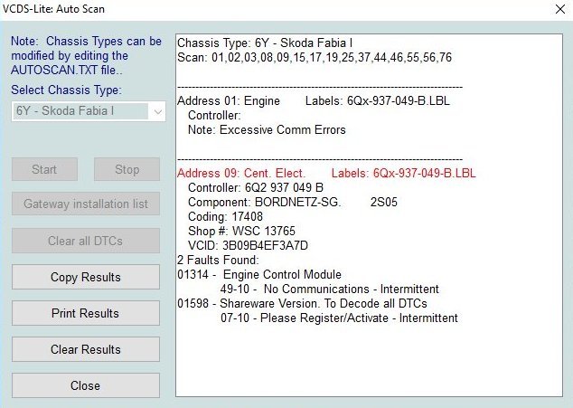

ordered a new usb cable reader thingymbob as my new laptop aint as clever as the vagcom software.... even after searchin for the old 409 version its still havin commincation issues... and  these little clips can do one!
not my actual photo... but i think if it wasn't broken before... it is now... flashing glow plug on dash after putting it back together... ugh - i don't wanna have to scrap my car because of stupid electric gremlins!
