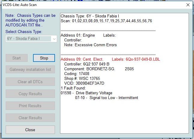

A scan with VCDS should show faults.

Plugged car in.. Only fault is intermittent battery voltage - aka squeaky belt - will post pictures after work...  pipes look pretty perished... Slight suckin noise - never listened to fuel filter before so unsure if usual??  Hopefully just bad cable or change of pipes!
vcvdsds lite
