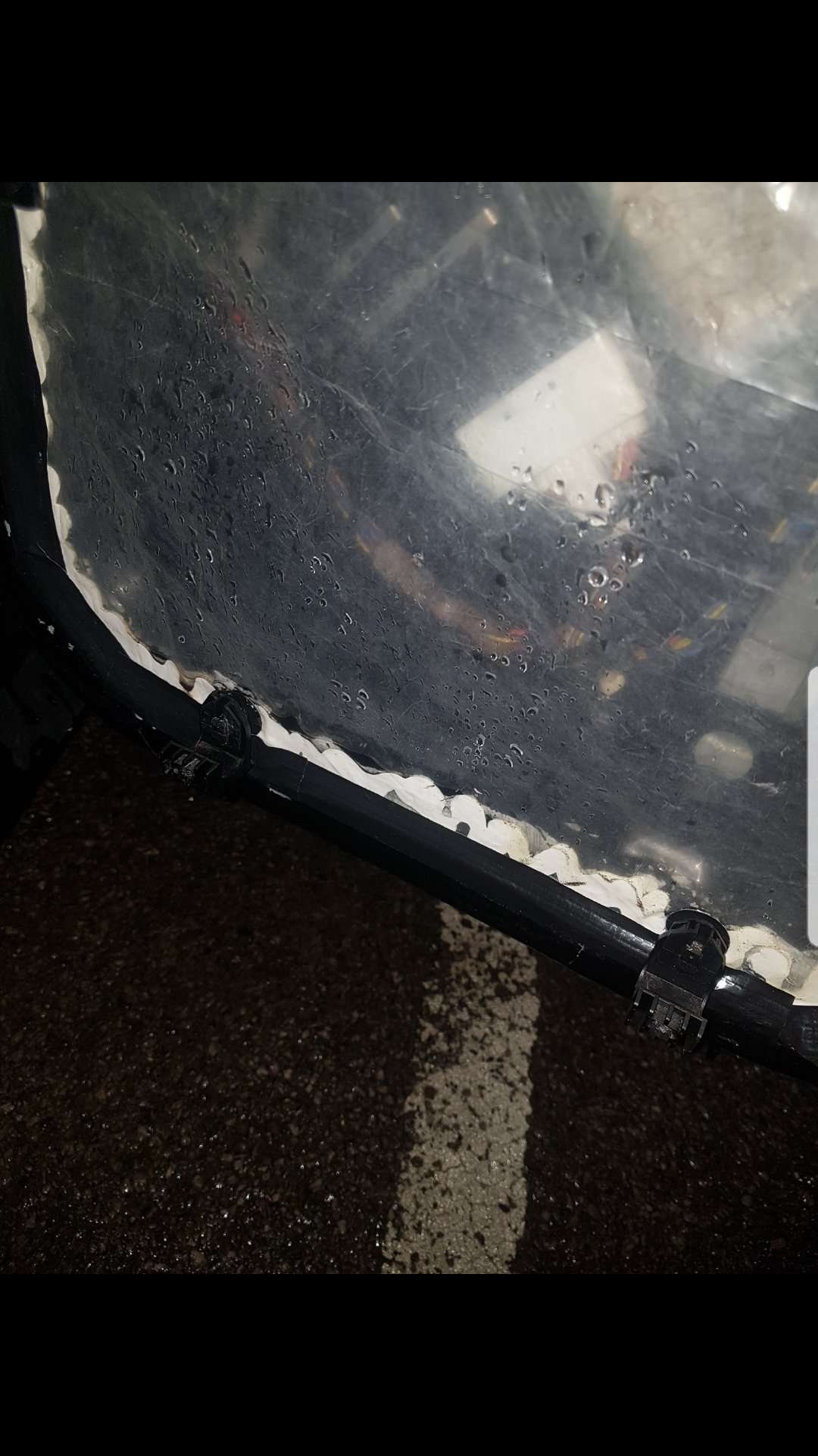

Thanks for the reply. Yes I just figured there is no panel behind the membrane. I recently put a new door membrane to avoid water getting through. Unfortunately I am still getting water behind the door membrane, no idea where it's come from

I used butyl strip and definitely no gaps left. yes I accept water is always going to get in the door card but in my case its  not draining through.  its almost as if the water is getting in from some where and running along the membrane and getting stuck there. I am 99% sure the membrane it self isn't a issue at all.

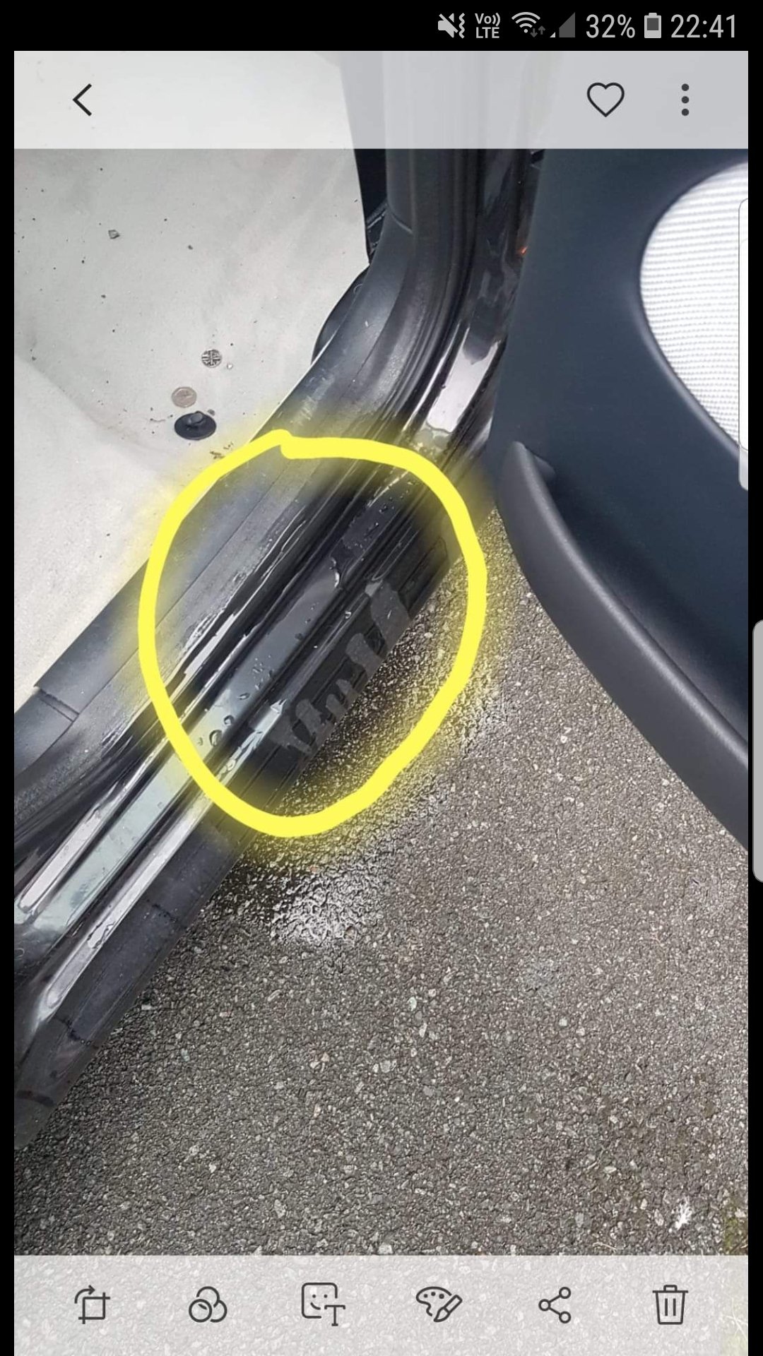

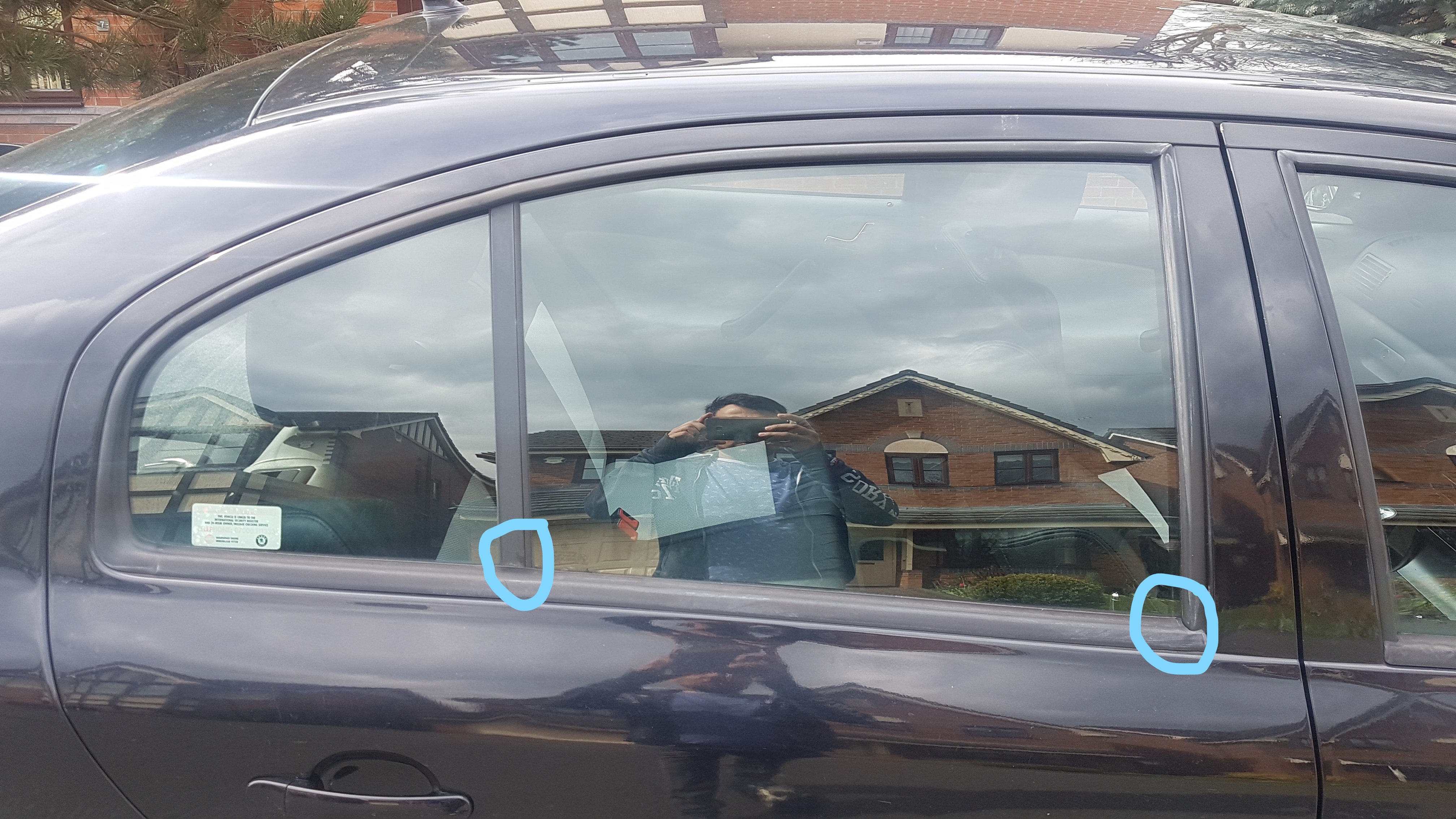

hi mate,
I have done what you suggested . I poured water from outside . the water is leaking through the door seal as circled in blue in the picture. so take it its new door seal time?  I wanted to put a video up on here but I cant unfortunately as it says file size too big

Thats actually normal :D
i know it sounds ridiculous, but its essentially impossible to completely seal the window and have it openable.
the water getting into the door should get out through the drain holes located on the underside of the panel.
if its getting out higher than that, theres a hole or gap in the plastic/sealing of the door membrane.
i used 1500 gauge plastic and sealed it in place with liberal pvc pipe jointing adhesive (plastic waste pipes under your kitchen/bathroom sink)

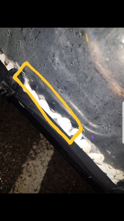

Im pretty sure looking at the pics and video again though, the problem with your water was the thickness of the bead of sealant you put on, left a little "pocket" between the plastic and the frame for water to run down into. The sealant also didnt look very flattened, so i guarantee there was gap. Any wrinkle/gap even teeny tiny ones can let a surprising amount of water through.
If it was the drin holes blocked there wouldve been a swimming pool of water the whole way up from the bottom of the door frame, which isnt the case.

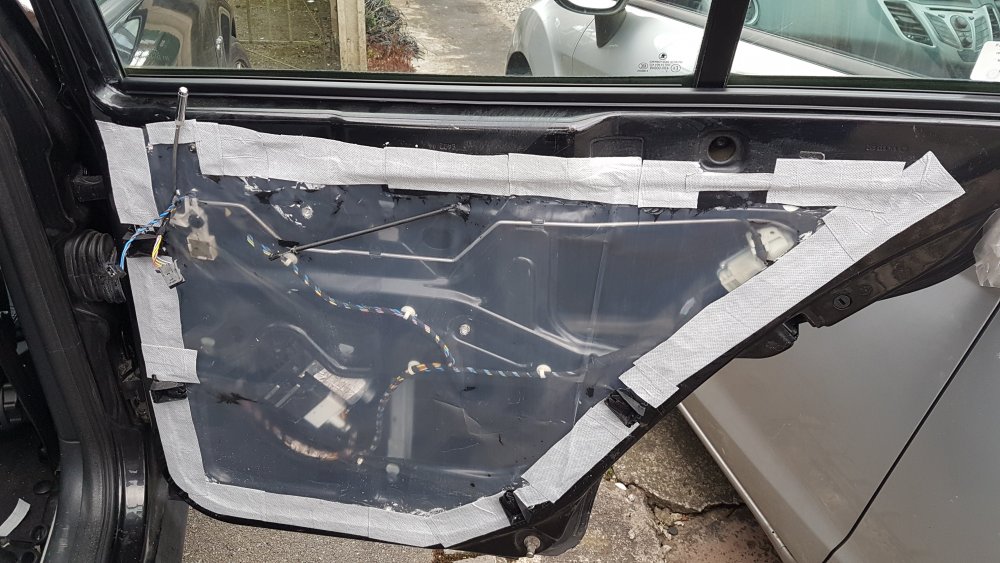

So you want the membrane as tight to to the frame as you can get it, so the water cant pool anywhere.
That why i used pvc pipe adhesive laid on thick, and really really press and spread the plastic into it so that its fully flat and fully sealed. But dont press too hard or it could rip..
Then i laid a full seam of duct tape all around the edge, after id let it cure and checked the plastic for gaps.
Also worth putting a bit of silicon or similar where the door clips screw back on, to make sure they dont let anything through, esp the ones along the bottom.

thanks mate.  My membrane wasn't tight at the bottom, the way I sealed it, it was allowing the water to just sit .

Oh, one other thing i just remembered i did..
Wgere you have put the hole in for the wiring loom & door pull bar etc,
I also put some duct tape swatches and then cut through that, so it wouldnt risk the plastic ripping too much, and reduce the wear in it from door opening etc..
