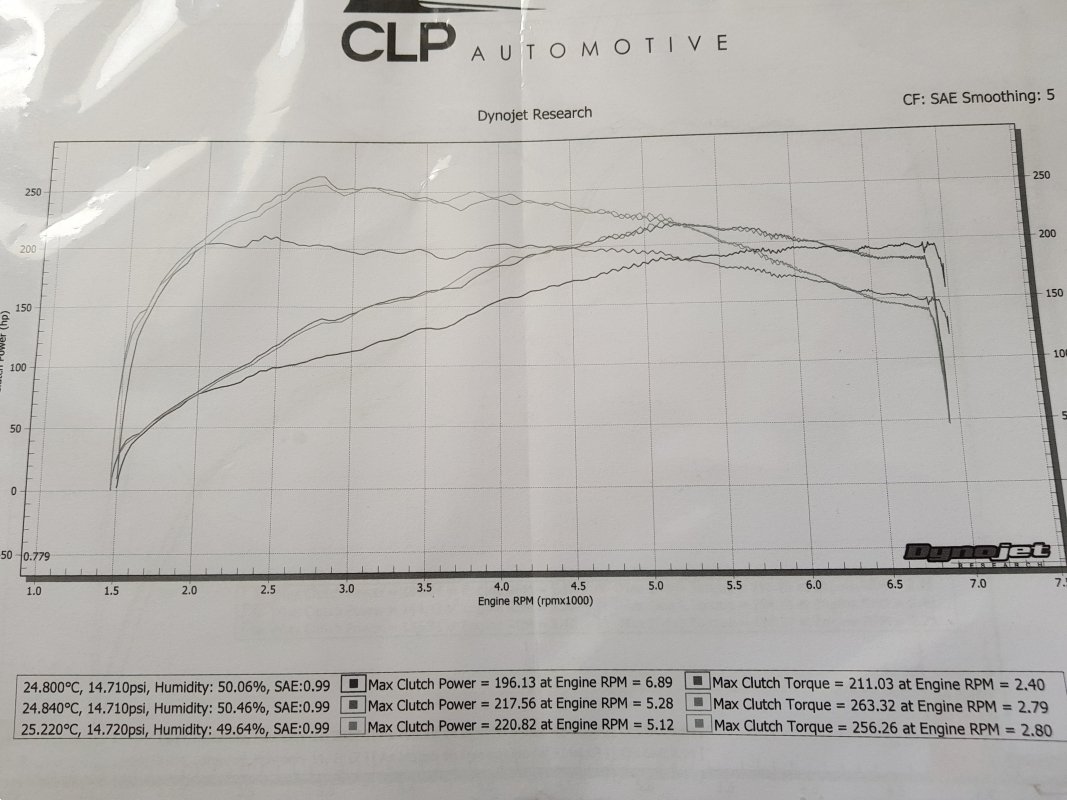

Just a little bit confused there buddy im not sure what you meant with the first part of your reply
but never mind that
What do you think about this mass converter? Is that true? Could that be holding back the 210bhp? Could the coil packs be the issue? Thats what he’s saying
also what intercooler?
i thought (as did the map guy) these cars are water cooled? Ive not seen an intercooler inside them before either?

I have heard about the DSG torque limiter, i mentioned it to you before. Yes that can help to increase torque at the expense of your clutches.
The car has no mass airflow (MAF) sensor, it has 3 MAP (manifold air pressure) sensors instead. So that is a dead end.
The coil packs arent going to increase the power, at all. But they might stop the misfiring.
The DV+ will only increase the power if the standard valve is leaking, which is a possibility but i doubt very much its going to make a big difference.
I would have the car put back to standard, sort out the misfire and do a battery of tests to find out the performance of the car as standard. Then map the car and compare the data to see what changed.
Edit: just seen the watercooled / intercooled comment. I suggest you do some research if you want to get your car where you want it to be. I'd start by going outside and looking through the lower grill for the air to air intercooler...

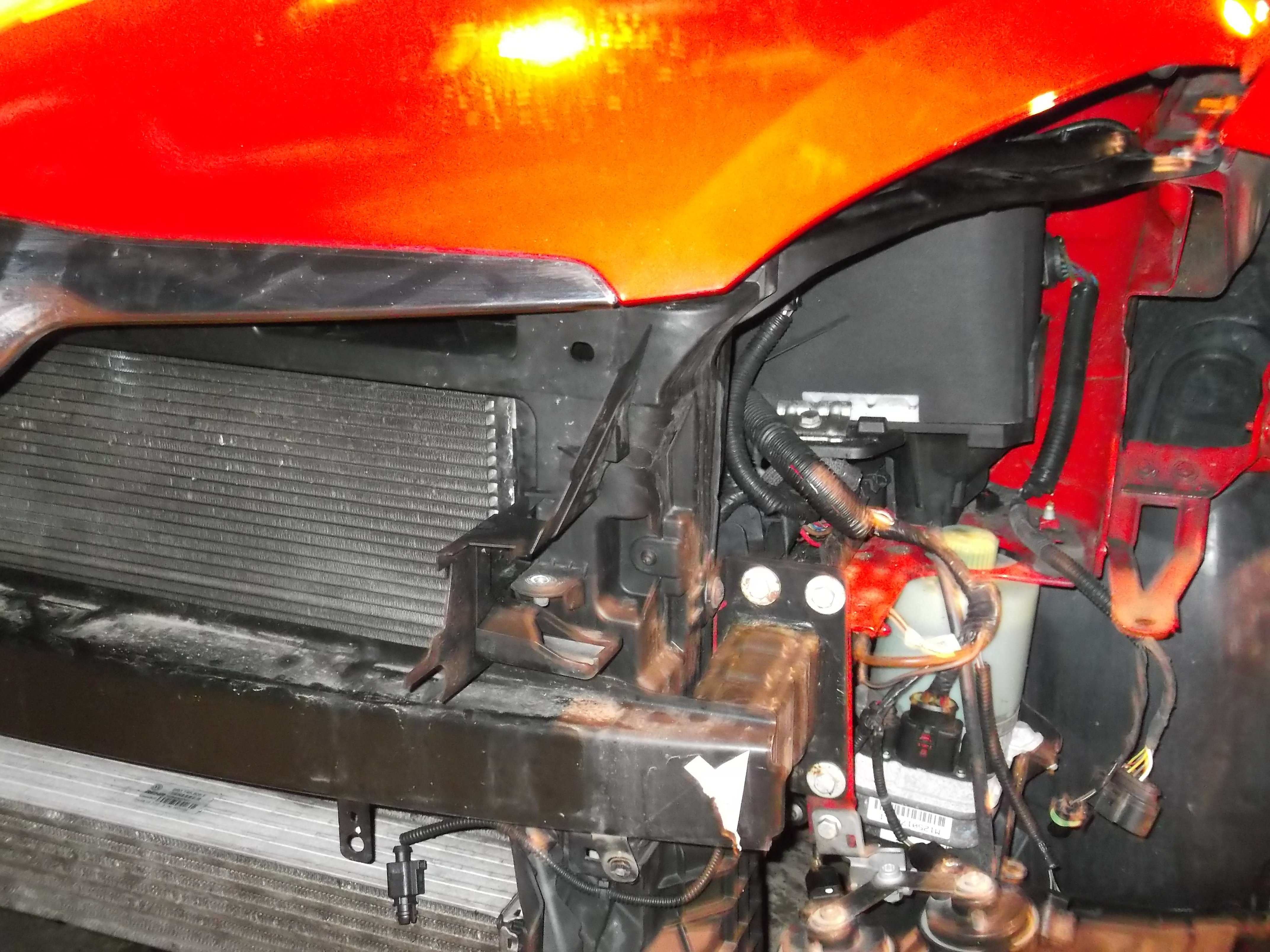

I take it your re-maper / tuner or you never looked at the front of the car.
Where was the fan blowing at?
This member has a quick vRS and then a new engine and then still a quick twincharger.
Maybe do some more research on what your car is and has.

Right okay
this is really frustrating
the guy that mapped it is willing to help me but when he said he could code the map to increase power however if it causes damage to other components thats on my head and that worries me a bit
should it concern me?

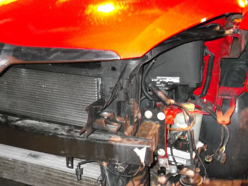

just had a look and i dont see an intercooler behind/infront of the radiatoe or behind the lower grill
which is strange because i know airtec does an uprated intercooler for these cars so is that maybe a road to go on?
also; torque limiter on the dsg, if i upgraded this how am i supposed to know if the increase in power is from the map on the DSG, from the map on the ECU  or a combination of both?
This is a standard front. Slight accident damaged...

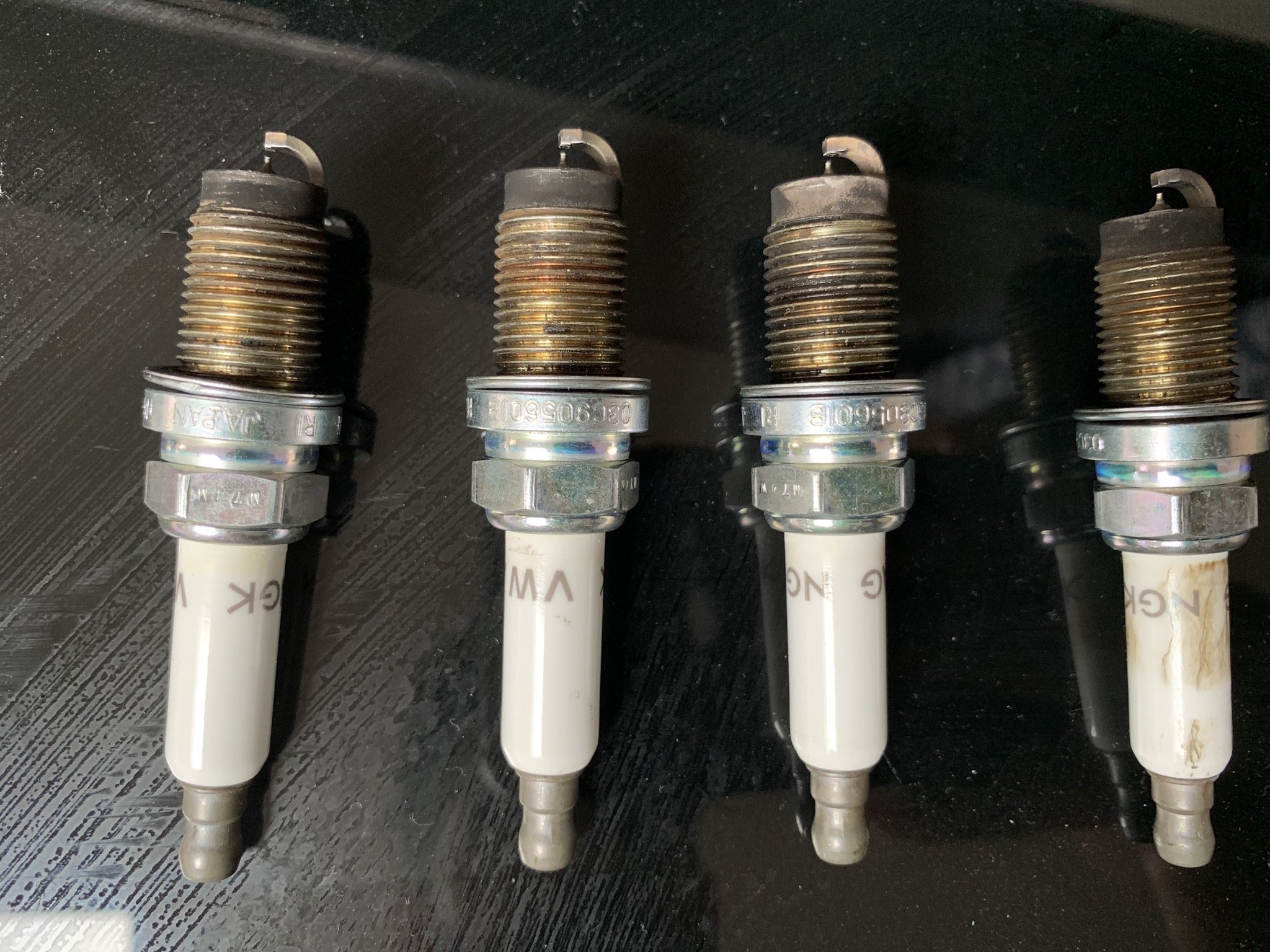

Drove the car approx 60 miles today various modes/flooring etc and it is definitely misfiring alot more
those plugs need to get here asap!

I think your spark plugs just need changing, maybe coils too. They were ok producing the power you had before but now the cylinder pressures have increased they aren't doing the job.
Any time you increase the performance of a car you are putting more strain on the components and shortening their life, that's just something we have to accept.

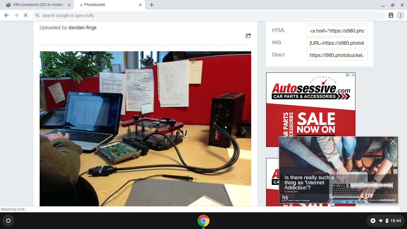

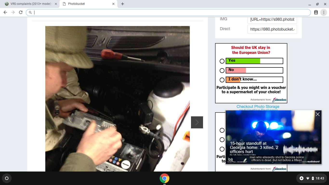

As in Dandanfings threads his 2013 CTHE could not be remapped even with a APR Dealer opening the ECU.
It took 2 years until there was any Remappers that were Remapping from the OBD.
There are 3 different standard Softwares from 2013-2014.
Mid 2013 there were changes made. There are 2 different ECU's from 2012-2014 that i have seen.  (3 from 2010-2012 with the CAVE, and various maps.)
http://briskoda.net/forums/topic/314712-vrs-complaints-2013-model
When i ask about Polo GTI or SEAT Cupra with engines after 2012 that are remapped and what ECU there is people get all wooly on the subject.
It is not unusual to hear about a car being re-mapped and how fast it is and when the ECU gets asked, no comes the reply. Just someone boasting.
All ECU are not the same, and how they were locked was not the same.
http://briskoda.net/forums/topic/392363-remap-options-vrs

Oh definitely not touching anything till the misfire is sorted
ive tried to lay off the accelerator as much as possible too. New plugs should be here tomorow latest Thursday. The VAG specialist is charging me £30 for a diagnostic and ECU read for the remap.
im just slightly leaning towards what Skodfski said regarding how alot of tuning companies were struggling to unlock the ECU on the CTHE engine and failing the maps, has that potentially happened in my case
its doing my head in
the guy who did the map, do you reckon he would give me a full refund despite having spent 90 mins on the map + whatever else he spends deleting it?

How you getting on Reza? Plugs fitted? Misfire sorted?
Thats nice of you to ask!
yes plugs fitted, originally had NGK in there can send pics of them but they seem in tact. On the odd ocassion the car SEEMS like it ever so slightly wants to misfire when i full throttle all of a sudden, i hear the exhaust pop a tiny bit like it did with the misfire but nothing that i notice. So so far, so good! Also, fitted the GFB diverter valve and my god its made a huge difference IMO. Much more agressive in combination with the plugs. Down side is, engine light is on (which they warn you about) installed it myself, due to 1 screw being in a super duper annoying place took 40 mins just to undo that and a bunch of swearing and finger cuts. Did a diagnostic just now and it does read an issue with the valve, as well as air intake leakage??????
very strange as i checked all the pipes and hoses but will check them again.
going to the remap stylist on Monday hopefully, he can sort those issues out !
Original NGK plugs
seem fine to me? Im not an expert so please tell me
