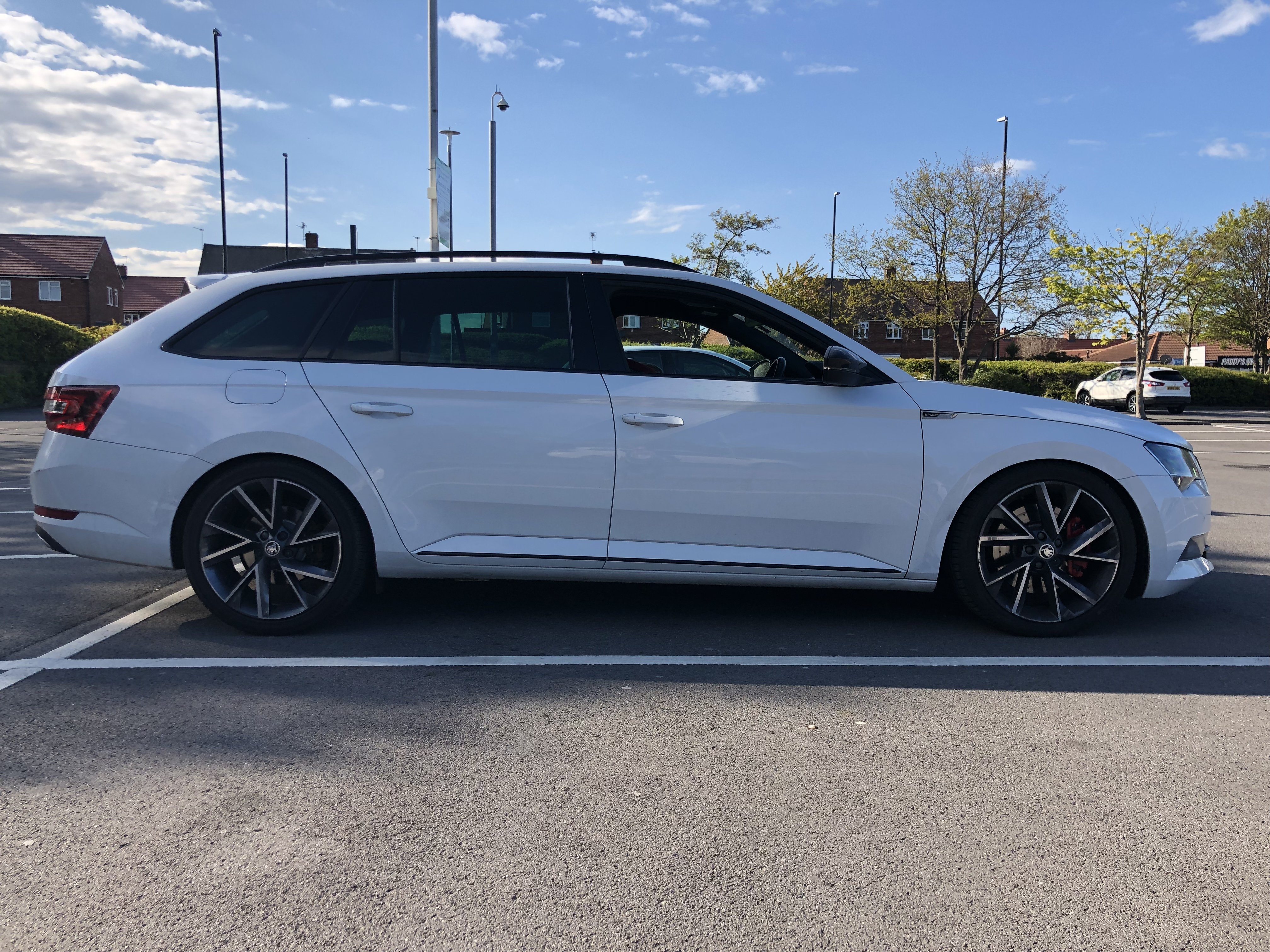

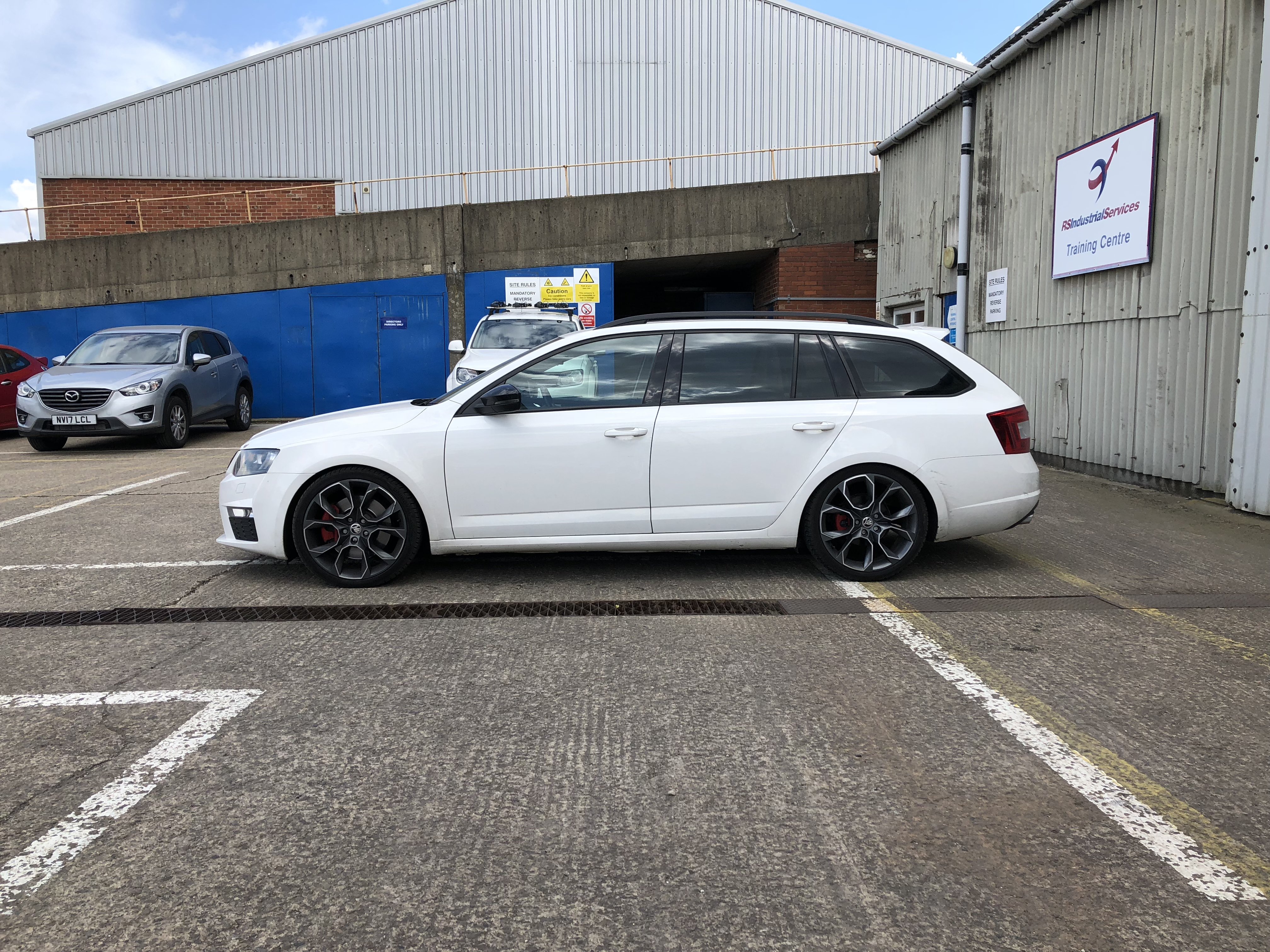

both perfect stances, love that superb...😍
3 hours ago, Esseesse200 said:
This was mine when I had it on H&R and I now have a superb which I have just done H&R today
Great, how much this is lower than stock, looks like min 40mm?
Springs on the Vrs octy were 40mm which makes the vrs avout 25-30mm lower than standard
and the ones for the superb are 35mm down on standard which makes the storyline 25mm lower than standard. I find they are stiffer without a doubt obviously but never found them uncomfortable. Even fully loaded
