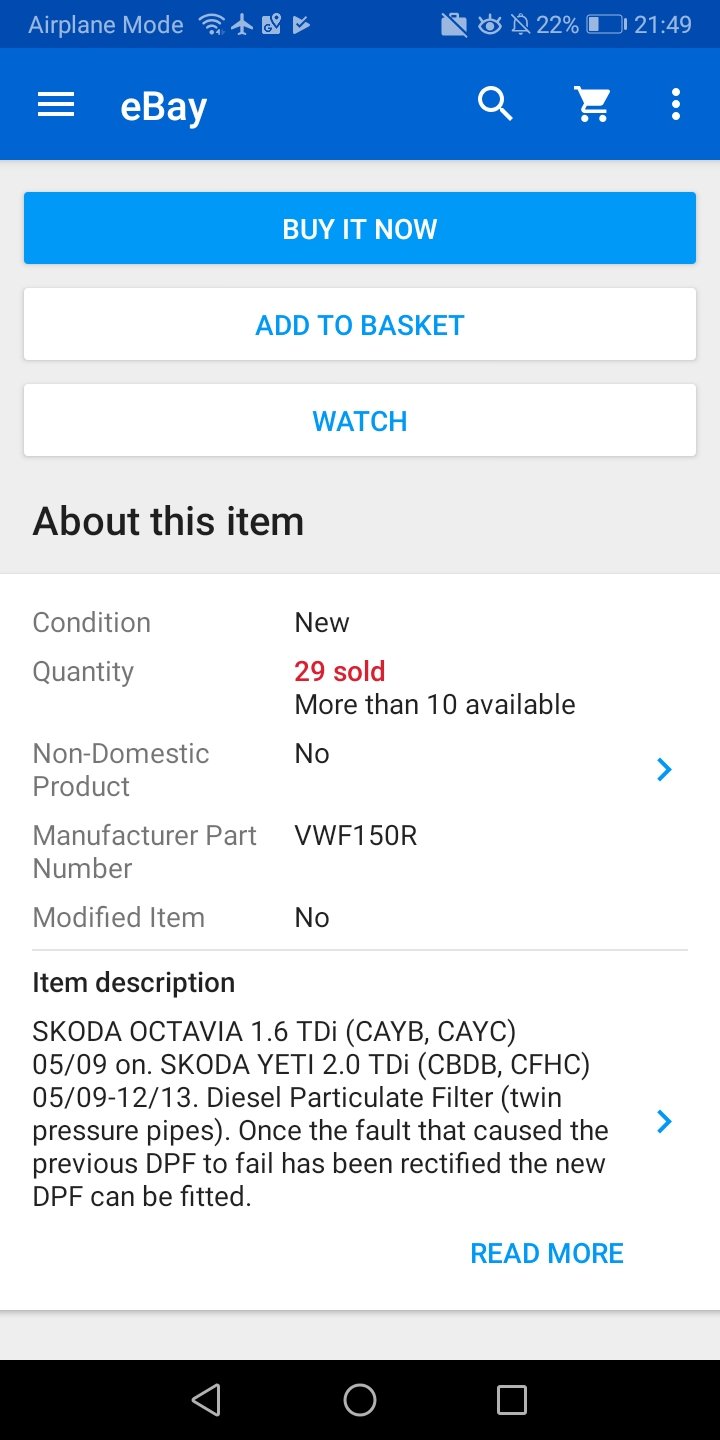

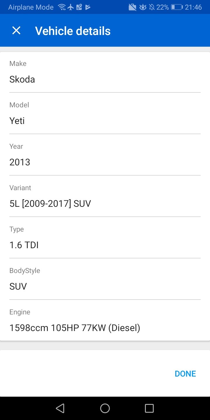

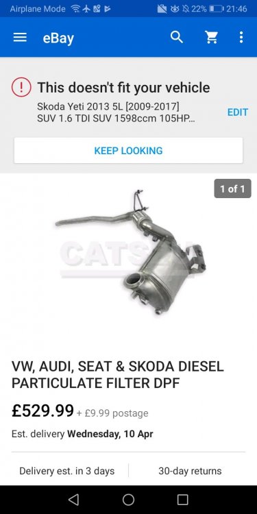

Had the hood up today but when trying to find a VW AG part number I could only see the heat shield. I know the turbo is different on the 2.0 TDI but I'm sure that if the diameter is the same the 2.0 dpf from a yeti must fit the 1.6 if it runs on the Audi 1.6 and Octavia 1.6.
A part number would be a great place to start :)
I doubt the ebay compatibility checker it completely correct. It might be better if you can find the part number for your DPF and search using that instead?
You should double check but at a guess, it'll be 1K0 254 707 FX which suggests this might fit: https://www.ebay.co.uk/itm/273749310040
