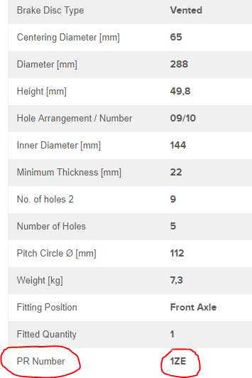

chimaera is correct - I have a 1.6d - MY 2014 and stock/OEM brakes, The fronts are definitely not 340 mm.
Front discs are PR Code 1ZE and are 288 mm.
Rear discs are PR Code  1KS and are 272 mm.
