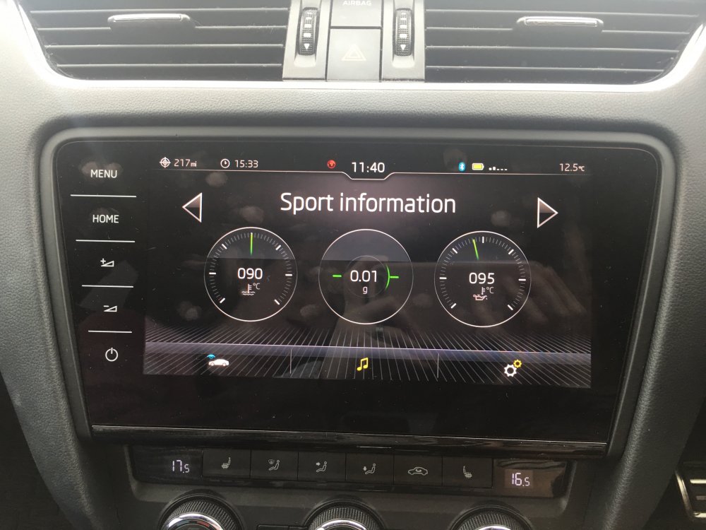

I have enabled the 'offroad' settings that shows steering angle, height above sea level and compass in the main HMI display and just wondered if anyone has sussed out the coding settings required to enabled the performance monitor or sports mode. Think it shows a lateral g-force gauge, accelerometer etc.? Anyone enabled this on a MK3 FL 18 MY ????
As above, it’s ODIS-E enabled with FeC/SWaP codes. I like mine, but I rarely use it.
Have you got the wheel angle sensors working on the off road gauges? There is some extra coding that needs doing for that to work that I found the other day. I can link it if you don’t have it.

No, as SashaGrace said they are SWaP functions so cannot be enabled except by ODIS - and they are not available on a MIB1 unit even then.

Hmmm. Are you sure yours is a MY18 ?
My 17 plate MY18 245 has this display as standard although, it shows Bar, G & kW
15 minutes ago, SashaGrace said:
I think the OP’s car is a 230. This is only activated on the MY18 245 and MY19 245 Challenge in the Octy range.
You are indeed correct - it is a 230, hence not having it as 'standard'

I just enabled the off road function a couple of days ago, and the wheel angle just worked.
But my oil temp and turbo pressure gauges on the Sport menu don't. People have mentioned an ECU update to get them working. Just wondered if they just worked for you, or did they start working after the CAN upgrade?

Check that the Sport Menu is active in VCDS, I’ll PM you the coding when I get home.
Please, reply to me, too! I Checked today, and it has SportHMI only, (I have only a Bolero, it can shows: steering angle, oil and water temp.)
