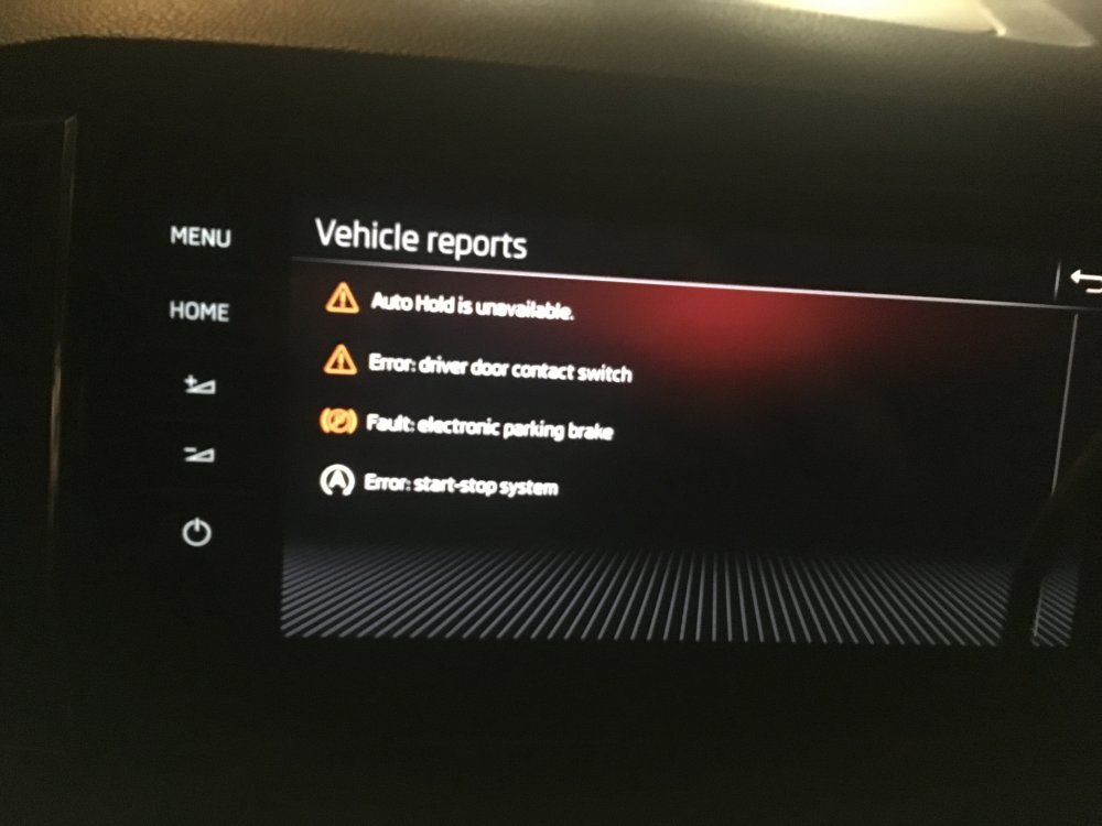

I have a generic warning light (Hazard Triangle) and when I look I have 4 errors.
I can not lock the car...  Anyone any ideas?  Tommorrow will try Skoda Assist... but car drives OK - just can not leave it anywhere...
ANY IDEAS ANYONE?
I do not even see a door switch...

This morning when I had a look in the light - I could see I had no power at all in the drivers door - for anything...
So went and checked the fuse...
I am ashamed to say... I caused the issue...
I had removed a fuse to fit the sat Nav permanent feed and pulled the wrong one... unfortunately I replaced it in the wrong slot...... (dark and under glove box) as the slot everyone else used I could not use as there is a big metal fuse 1 over from that fuse that prevented the fuse jumper fitting.
I had checked everything I had done to install the Nav... and then took out the wiring for the Nav and also tested the system and found 3 errors... they cleared but immediately came back..
As I said - this fuse was when I was looking for the numbers on the fuse holder... I pulled a fuse - found the number - (not the one I wanted) and put the fuse back - but put it to the right of the fuse next to it - in an empty slot -  not to the left.
This morning I got out the manual and found the fuse for the door and could see - there was no fuse... so searched for what happened.... then slapped my self for being so stupid....
Then I reinstalled the permanent feed to the Nav.
