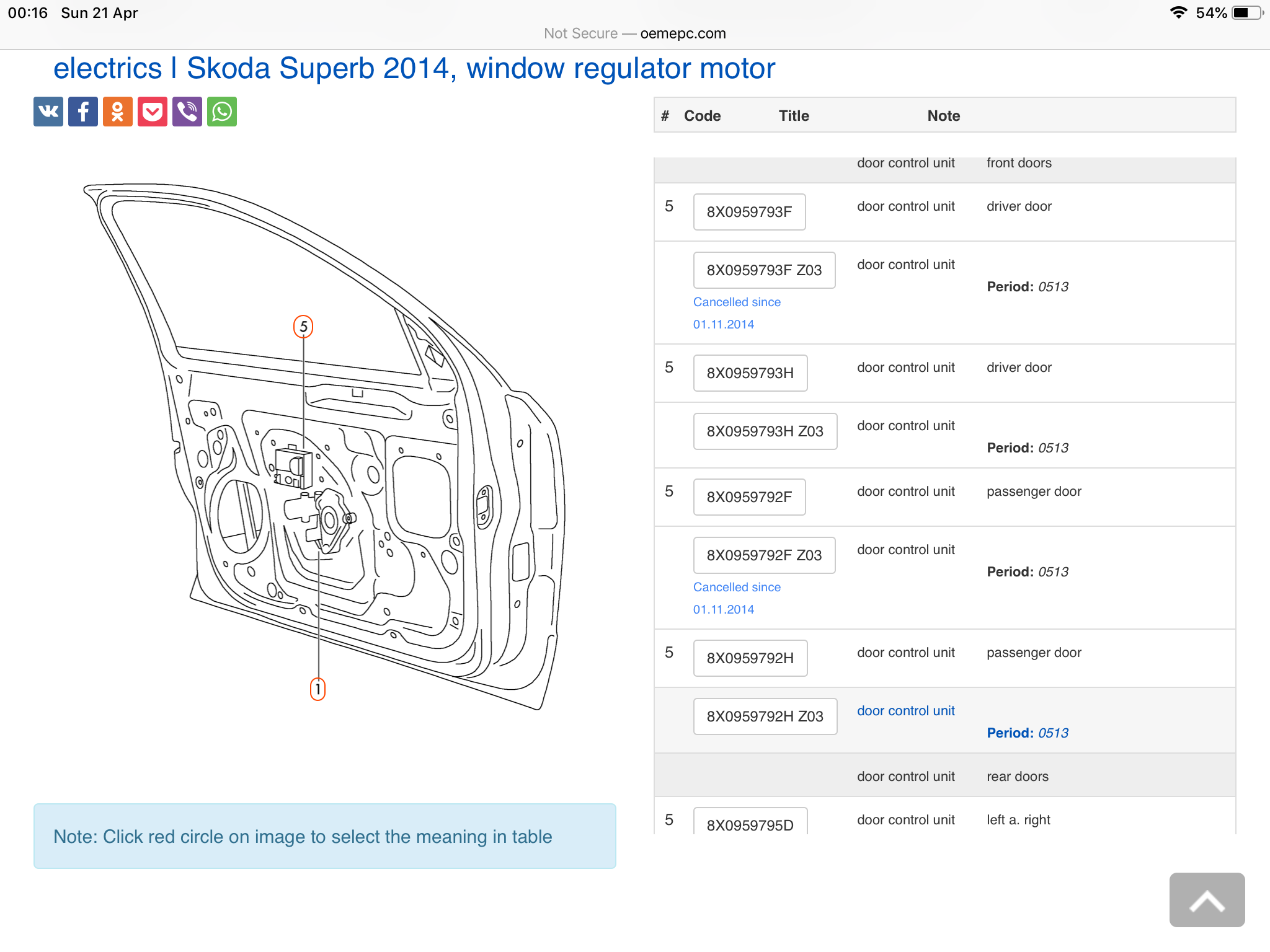

i have been told that it’s a module in the Drivers FRONT door that causes the problem, but I have no idea on its actual part name or even better, a part number.

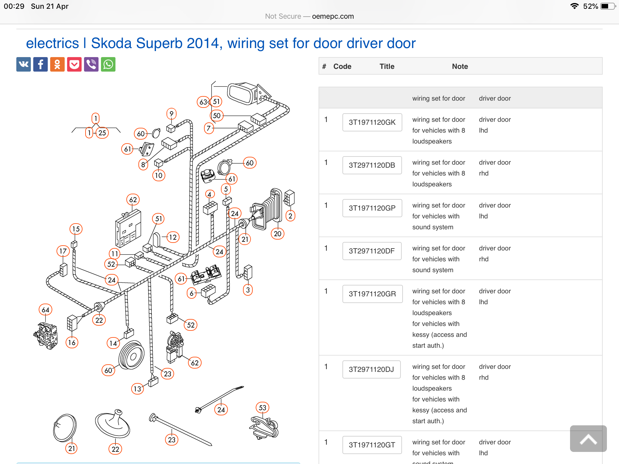

Gents, I’ve got a couple of questions after having a further search this evening after reading the thread supplied by @bigjohn.
I've been told it’s the module that is in the drivers door... part 5 below
However, it would make more sense to me, that it was the wires in the harness that have given up the ghost.
My my issue is this... I have updated sound in my car, which consists of an extra speaker in each door, which of the two options would you go with?
8 LoudSpeakers or vehicles with sound system.
I’d assume it to be the sound system version, but any help would be better than me making the mistake of ordering the wrong part and getting my door stripped right down to replace with the wrong part!

DO NOT BUY A door controller
Once you buy one and fit it it needs coded to the car and Skoda will not accept it back if its been fitted and even not coded
A VCDS scan says no communication with door controller so a lot of people go and replace it :sweat:
You need some one thats capable of checking out the wiring completely to rule broken wire ( wire can be broken inside and insulation intact so looks ok at first sight but needs to be continuity checked which involves removing door card and loom to completely check.
A lot of people have been stung before

Get the wiring harness repaired - an auto electrician will be able to solder in and insulate extended wires. As @DEL80Y mentions DO NOT buy a module - the wiring is a common fail on the drivers door (it is usually the one that is opened the most!)
