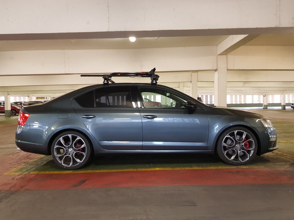

I use a roof system too, I have Cruz Aero bars in black and Yakima front-loader bike racks (also in black).
A very good combination, the Cruz bars are very good and considerably cheaper than the Thule, the Yakima rack secures the wheels of the bike (not the frame) and is very easy to load.

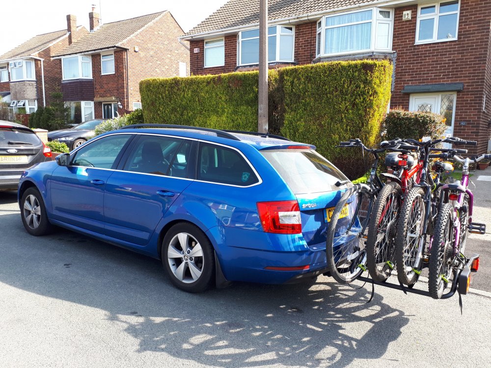

I've got a Buzzrack Quattro 4-bike mount from Roofbox.co.uk - this model I have appears to be discontinued, but I can certainly recommend the manufacturer and the seller.
Attached is a photo of us going out today.:emoticon-0157-sun:
I previously used a couple of roof mounted racks which were fine apart from the strength/agility needed to get the bikes on in the first place, and the fact you can only get two bikes (3 at a squeeze) on the top, as the Octy isn't that wide. They (and my roof bars) happen to be on ebay at the moment ;)

Be careful with the nose weight on the tow bar, it already looks like moving weight balance away from the front. That rack is nearly 20kg which only leaves 55kg for the 4 bikes iirc the Octavia nose weight at 75kg
Yes it's fine - just. I've weighed everying using a digital luggage scale, and if comes in at 74.5!

When using the towbar you have to take care about the weight. Especially with electric bikes which are much heavier.
Also, since the load is much shifted to the back, the car is lower to the ground. Especially with the regular springs. If using the towbar for bikes, I highly recommend replacing the springs for more rugged ones, or install helper springs.
I noticed without bikes, only 2 adults and luggage already the lack of suspension, especially on speed bumps. Imagine an additional 50+kg on the towbar...
If you see the picture above with the 4 bikes you can clearly see this already.
