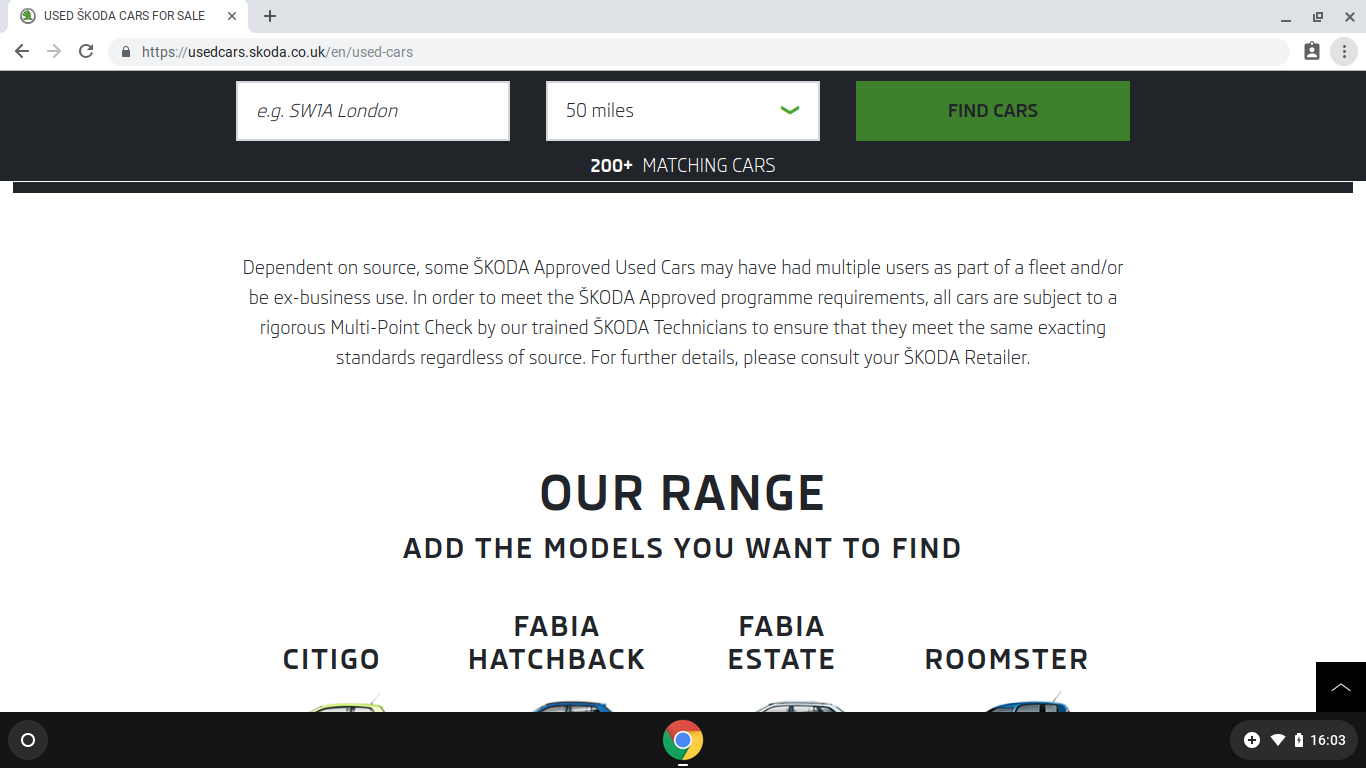

Even easier now for someone at a Service Desk to input a 'Service' as being carried out before delivery, not always meaning an oil and filter change was done,
maybe just a topping up,
and also show that the 'Rigorous Pre Delivery Checks' as done, , yet no oil change was actually done. No service done if not due.
The paperwork is nice to get , with a name next to initials.
