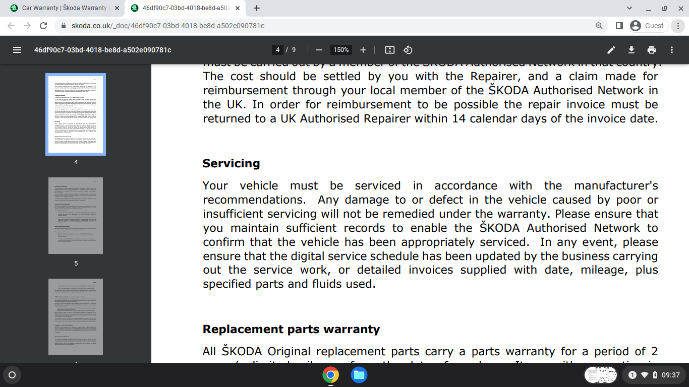

SKODA_Warranty_Terms_July_2023.pdf

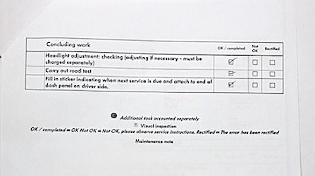

This is the check-list relating to my 2009 Skoda Rooster's most recent Oil & Inspection service (the images aren't great, I'm afraid)
The parts involved were oil (3.6litres of 0W-30 to VW 502.00/501.01 specification), an oil-filter, a sump-plug and 1litre of windscreen washer fluid (that I didn't need but was included in the service's fixed price of £210).
ETA: as in my post we've got a few of those two page ticksheets and more have a good look at them and decide how much is service really and what is missing.

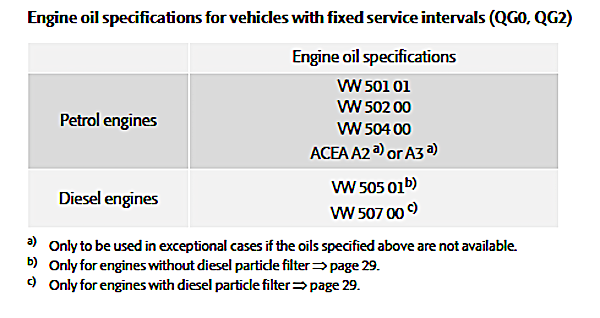

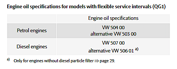

@DerekU  Was that 0w 30 FS III not to VW 504 00 / 507 spec, Long Life oil for fixed or variable servicing rather than to VW502 00?  Not Long Life.
1721482745_Screenshot2021-07-14at06_46.14(1).jpg.a894544c7d87011924fd24ca74ab5671 (1).jpg
1867988401_Screenshot2021-07-13at07_43_36.jpg.2b7cde539a15fb5581a3ff30f82659c3.jpg.cf6ac908323f2503ef70317bd1c78f9a.jpg.5e27215f522e386f35672ab103a968b7 (1).jpg
This is the oil-related advice in the Skoda Roomster Owner's Manual provided with my car.
image.png.8057e9b37f73867efd6af33afdf76936.pngimage.png.e32da41c22b842290e536eddd17db26b.png
My Roomster has been serviced annually at the Skoda dealership from which I bought it (new) in 2009.
I still have a good deal of the servicing documentation and I note that the oil initially used was described as "Platinum 5W-40" - a Quantum product. The maintenance  list stated that oil to the VW 501.01, VW 502.00 standard had been used. This continued until 2017, when the oil was described as "Magnetec Professional 5W-40" (a Castrol product) with the same VW standard appearing in the maintenance list. There's a gap in my documentation records until 2022, when the oil's manufacturer is no longer stated (just 5W-40) with the VW 501.01, VW 502.00 standard still showing in the maintenance list. In 2023 (and 2024) the oil is described as "0W30 LONGLIFE III" , which might indicate a Quantum product or the OE VW oil (assuming they are actually different !!)  Maintenance list still shows the VW 501.01, VW 502.00 standard.

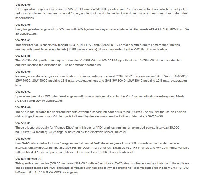

Quantum 0w30 Longlife III is 504/507. - https://tps.trade/info/oil/quantum-longlife
"VW 504.00 Engine Oil
VW 504.00, as well as being a great choice for many modern & Volkswagen petrol engine cars on standard "time and distance" fixed interval servicing, these oils are also suitable for all Volkswagen petrol engines on LongLife, extended service intervals (up to 20,000 miles or 2 years, whichever comes first) EXCEPT for vehicles recommended a VW 508 or VW 509 specification oil.
VW 504 00 oil and its sister spec VW 507 00 (for diesels) are known as VW LongLife III oil.
The VW 504 00 specification supersedes the VW 503 00 and VW 503.01 specifications." - https://www.opieoils.co.uk/c-749-vw-50400-engine-oil.aspx
oilspecifications.org - VW 507.00, VW 504.00, etc: Volkswagen Motor Oil Specifications Explained - https://www.oilspecifications.org/articles/vw_motor_oil_specifications_explained.php
oilspecifications.org - Volkswagen Oil Specifications - https://www.oilspecifications.org/volkswagen.php

  Or if  called 'just an Oil Service' i hope they are doing an inspection and plugging in the car, checking for faults or any Software Updates required.
Checking a new car as 12 months past someone should be, & do a paint inspection for that warranty.
In Israel do the new cars come set on the Fixed Service regime rather than the Variable / Flexible @ 18,000 -20,000 miles / 24 months.
That service is more than an Oil & filter change.
