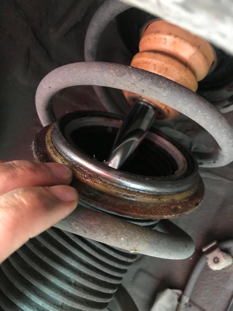

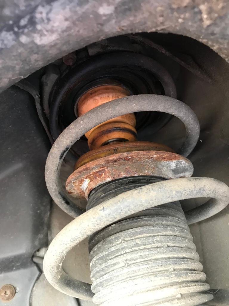

Got home and took the front wheels off and jacked the car up to find this! (Both sides were like this!) I'm guessing this could be a culprit of the knocking?
Seems maybe the top spring seats have both failed? The bit hanging down seems to have a thin bearing in, which might explain why the car now knocks under steering?
Any advice here on whether this would cause the knock and what the fix would be? Thanks!
Broken spring has allowed that top bearing to drop down, needs new spring and top bearing.

Yeah, so those top seats are held in place by the spring tension so the tops of the springs must have snapped off.

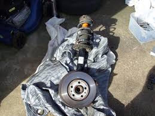

It's a lot easier in the long run to take the whole strut off with hub for this job. That's what I did...

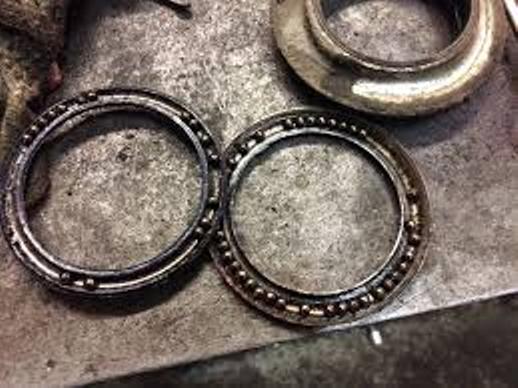

I think that the newer top bearings have bigger and fewer balls than the earlier ones, or maybe it was just that I bought aftermarket ones as my wife's Polo was going to be sold on within a couple of years. These top bearings as said will not outlive the car, I replaced both sides with genuine VW Group parts when the 2002 Polo was only 4 or 5 years old as a spring had snapped in half, about 5 years later I was told that it was making "funny" noises when turning the steering wheel, and sure when it was lifted up on both sides at the front, it was quite difficult to turn the wheels from lock to lock - one of these already replaced top bearings had packed up, as it was the LHS only, that was all I replaced as that one is the easy side to work on.
Edit:- I seem to remember in the case of that 2002 Polo breaking its RHS front spring, the top bearing "spilled" some of its bearing out as/when it dropped down as the top half of the spring escaped down into the lower half.
