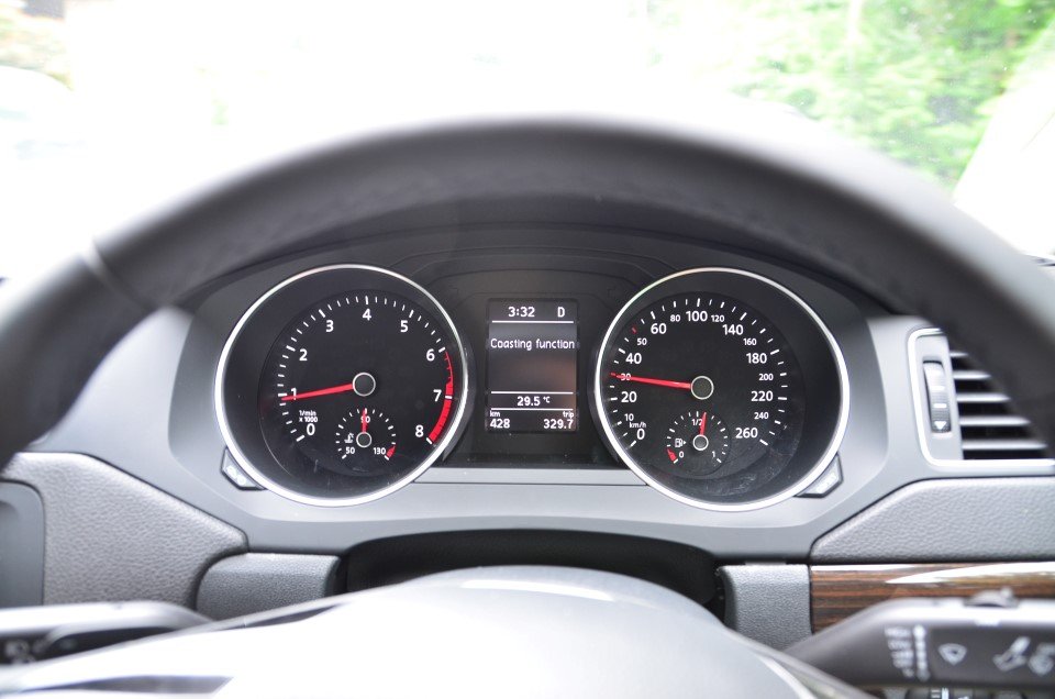

The 6 speed Wet DSG in 'Coating mode' does show 'D',  but not a gear.  it is 'Coasting'.
The DSG does drop gears on some descents, even in Edinburgh if not in 'coasting mode'.
Just a case of trial and error to see when, but they will arrest speed.
(reading the owners manual is certainly a good idea.)
When Coasting Function is enabled, and you are driving and off the throttle and 'D' shows you are Coasting.
Press the accelerator or touch the brake and the gear you are in will display.
As to just being driving downhills, not with 'coasting enabled' & different steepness, speeds, in what ever gear,
there is a sensor that reads the incline / decline.
Coasting-Function-ON-on-display-YSK_0728.jpg.8f101451c1a76bc7659ac1451cc9c483.jpg.2c462952620f98529e7dd6fdd6da3be3.jpg

When in 'D' and coasting it will go back in gear and display 'D6' or 'D5' or what ever if you touch the accelerator or brake, and can then go right back to 'Coasting' and display 'D; again.
