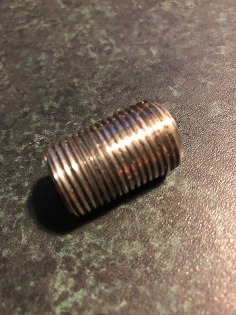

I had a similar issue on our VW Up!, but with the factory fitted filter! I decided to do the first oil change early, especially with it bring a turbo. The original factory filter was ridiculously tight, in the end (luckily) the threaded insert came out of the engine block cleanly. The original filter was solid on the insert, one removed it could be seen that a part of the thread was flattened. I bought a new insert from VW for around £10. This fitted the engine block and new (genuine) filter perfectly. The car has since had it's official first service at VW, no problems were reported.

The spindle or insert is the same thread from end to end, VW have been using the same part for decades, my mk2 Golf GTi uses the exact same component to secure the oil filter. This photo is the damaged one that came off my nearly brand new Up.
