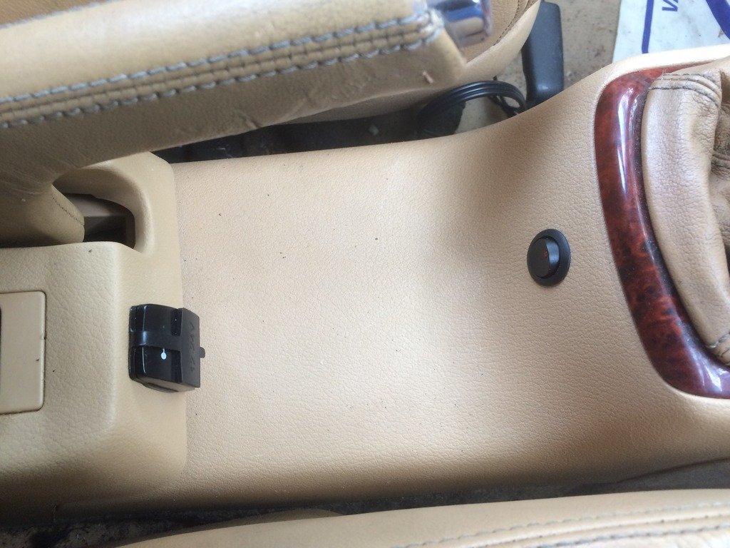

I fitted this to mine
it uses the 12v supply to the normal ciggy lighter but as that is "live" at all times I added the little rocker switch so it wasn't going to be a drain on the battery
Hey that looks tidy, even as good as factory fitted! Did you just disconnect the wires from the back of the cig lighter and connect them to the charger?

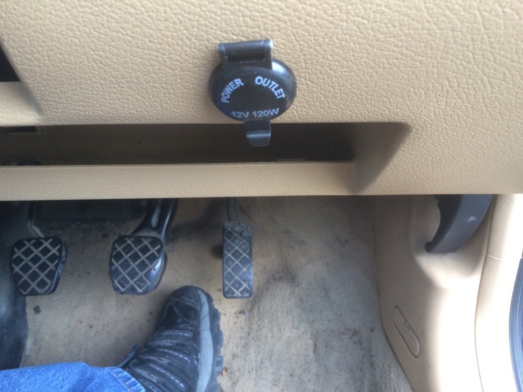

I have a extra aftermarket power socket fitted on the dash....
I didn't add it- a previous owner did. It is wired onto the switched 12v feed that supplies the radio so it switches off when the car is off.
It's crude but effective- If I was to install one myself I would probably just add the dual USB ports but in a similar location.
That looks handy blueb4sunrise, but wouldn't wiring it into the live for the radio risk blowing the radio's fuse or otherwise causing the radio not to work right?

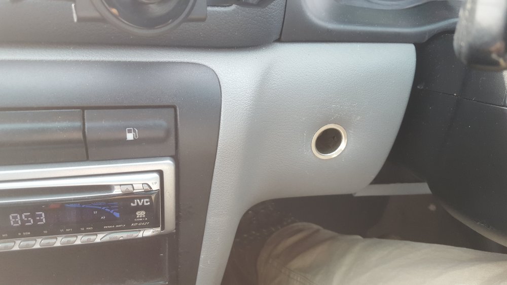

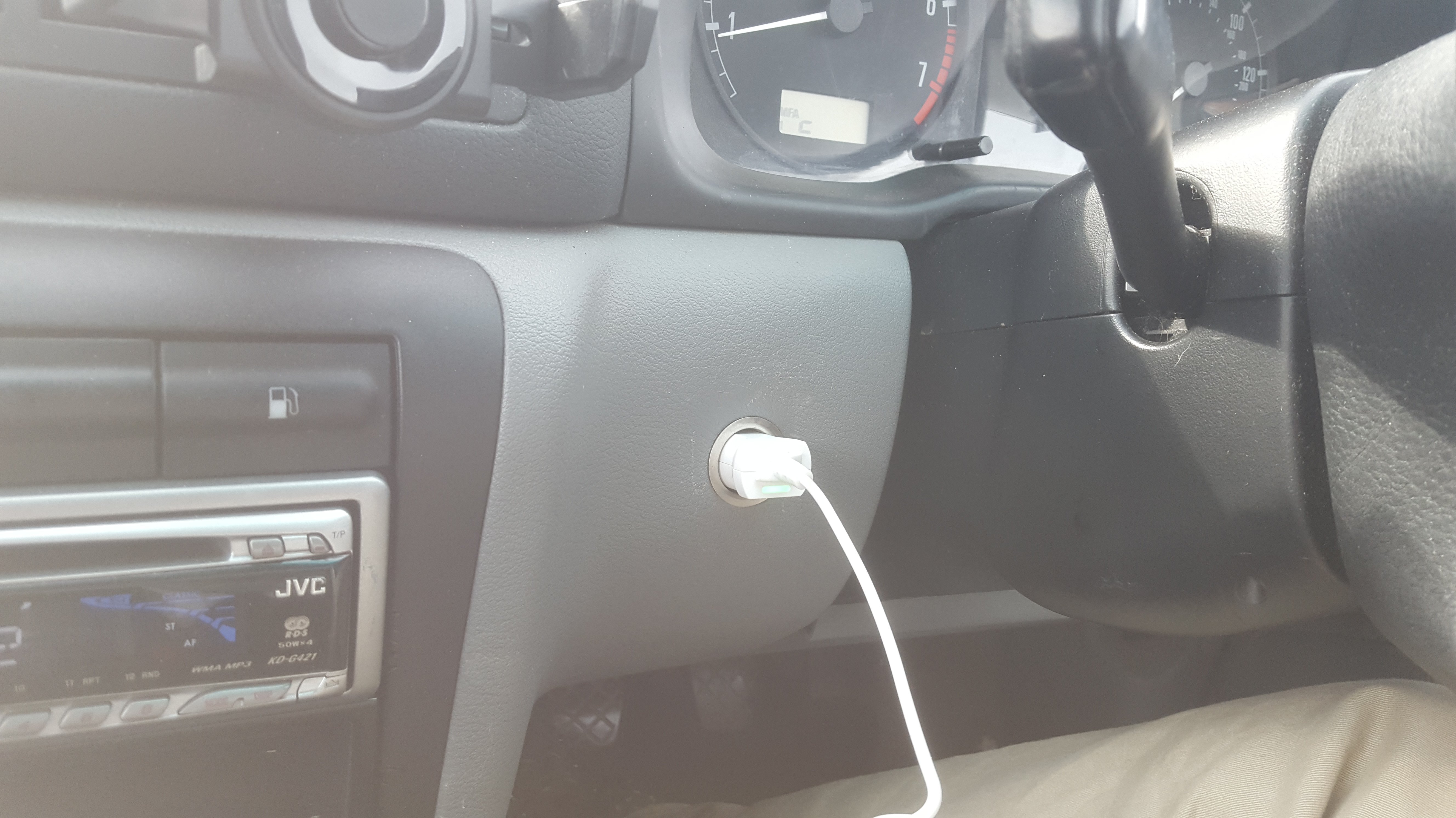

I also fitted this
Just to power the satnav, it takes it's supply (via an inline fuse) from the "30" terminal on the bottom of the relay panel just behind the trim panel
It hasn't caused any issues to date... It's not the way I would have chosen to wire it myself but as long as it works I will probably leave it alone.  I use it to power my phone while using google maps... I use the 2.1A USB adaptor and have the radio loud enough to rattle the widows at the same time.
That is a tidy looking socket nige, I should probably do likewise and and add an inline fuse to it.... just in case.
