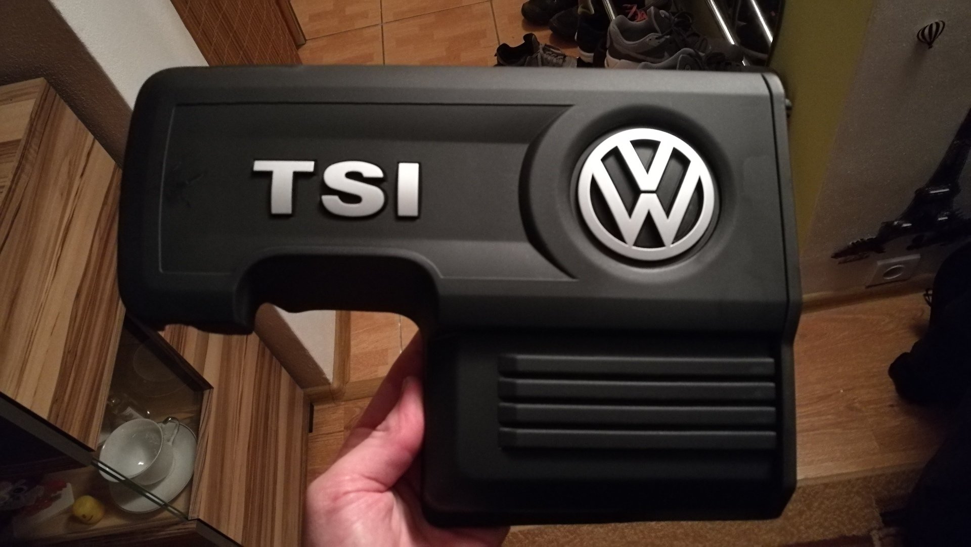

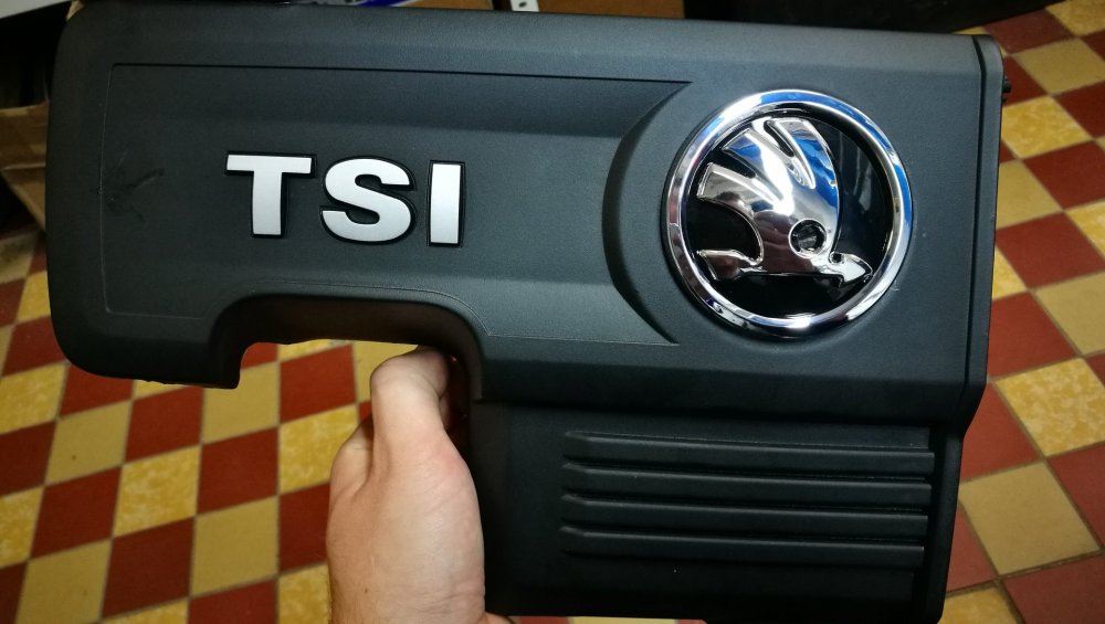

Anybody here tried this modification on their Fabia's
yes, i have it on 1.2 TSI 81kW. engine cover and logo from aliexpress
IMG_20171120_161650.jpg.087dc8a9cdcdfe7c2961685072939a26.thumb.jpg.3b70b4286e98e2fabfe283e751446468.jpg IMG_20171123_055416.jpg.fe4543c27d91e24eda150ccf387f0d9d.thumb.jpg.2291d0f025e2c0b655efa5ae484df469.jpg IMG_20171123_112513.jpg.cb4849e0026d7ced5b41430a55b3c8f7.thumb.jpg.15340af06045f091db2d0f43eb2bd66e.jpg IMG_20171123_112520.jpg.e07b88f1433076eb68b366560515bdee.thumb.jpg.fdfd2d3e7ed8b4b1ebe331c0e266a3d6.jpg
It is completely up to personal preference, but why would you want to cover the coils up and limit them from dissipating heat in an already hot environment even more with the cover and shortening their life?
This kind of cosmetic "improvements" in my opinion do more damage than good.
Not being rude but they have the cover on as standard on all Audi's mate i.e. 1.2s and 1.4 and i have not seen any complaints about heat dissipation? Unless you've heard of stories.
Yes, because no one looks at actual data and real world driving situations. For example the middle two cylinders have one time as many misfire counts as the other two. All new plugs do not solve this, neither do new coils. After about 20 km drive misfires start to happen, in about this time engine gets heat-soaked enough to produce this feature. ECU sees this, you do not.
Just saying, not trying to prove a point.
Until engine runs for the warranty period it is good for VW and they couldn't care less. Since ECU compensates for this it will not hurt the engine that much or at all, but affects performance.
Never mind, don't want to argue further.
Have a nice day.
