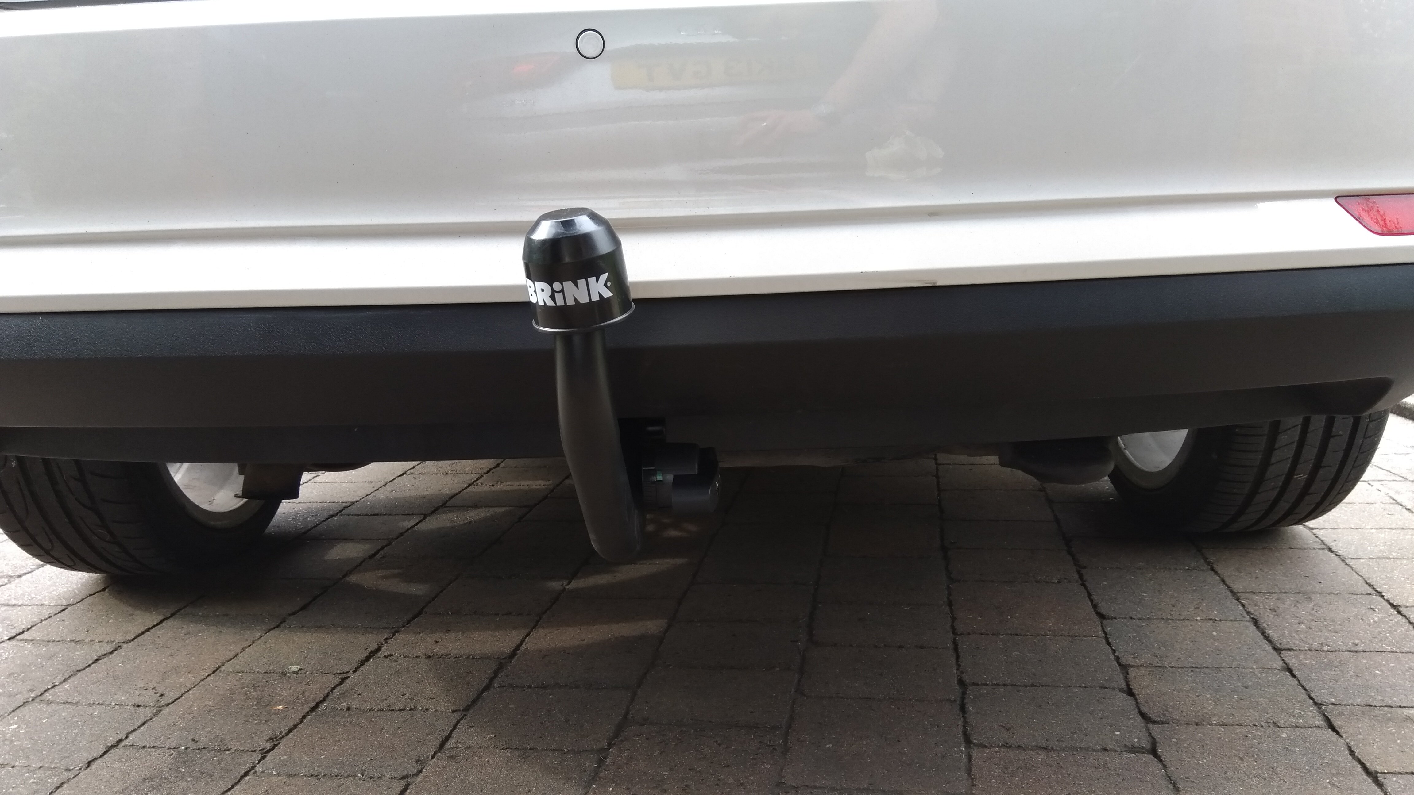

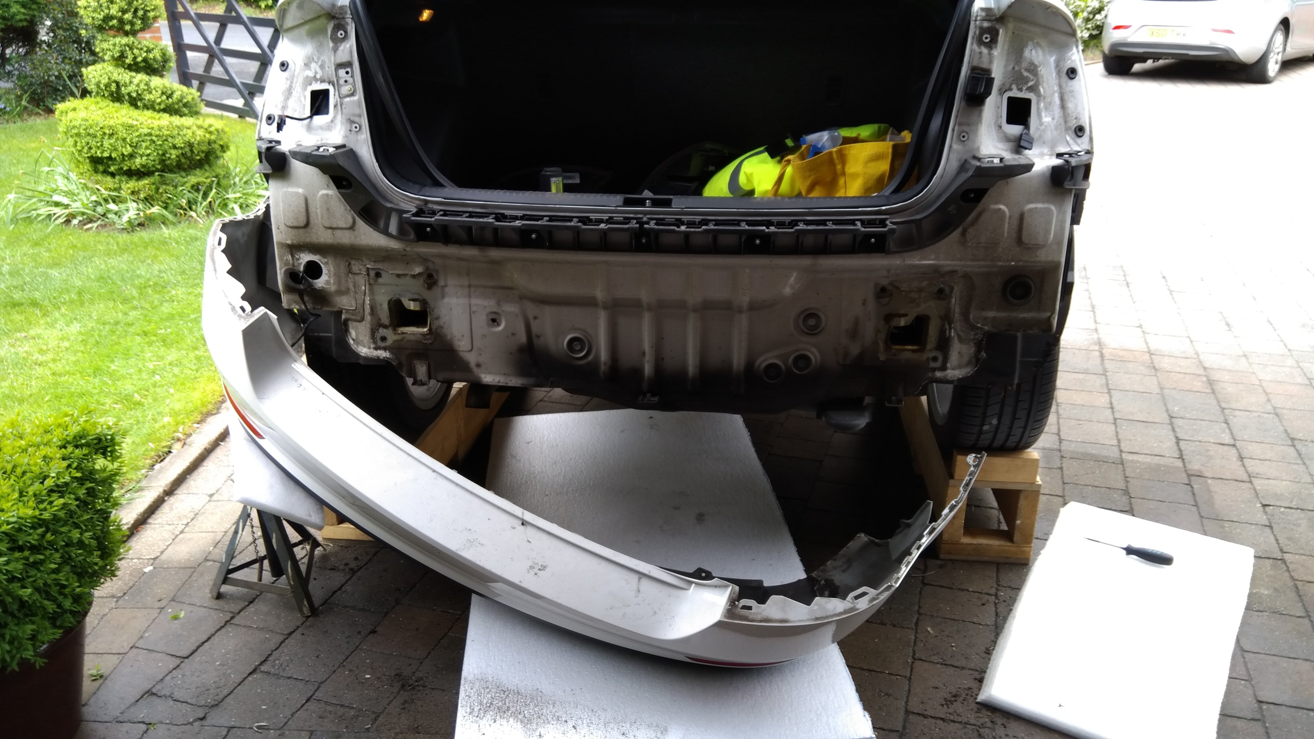

Made the most of a break in the weather and fitted the towbar this weekend! Ordered it from PFJones on the Monday (10% discount too so only cost £160) and it arrived on Wednesday.
Took a few hours for two of us to do, but fitted perfectly and looks brilliant! Putting the car back together was certainly easier than dismantling it. Didn't need to make a massive cut in the bumper either as not fitted electrics as only being used for a bike rack. OVerall, very pleased!

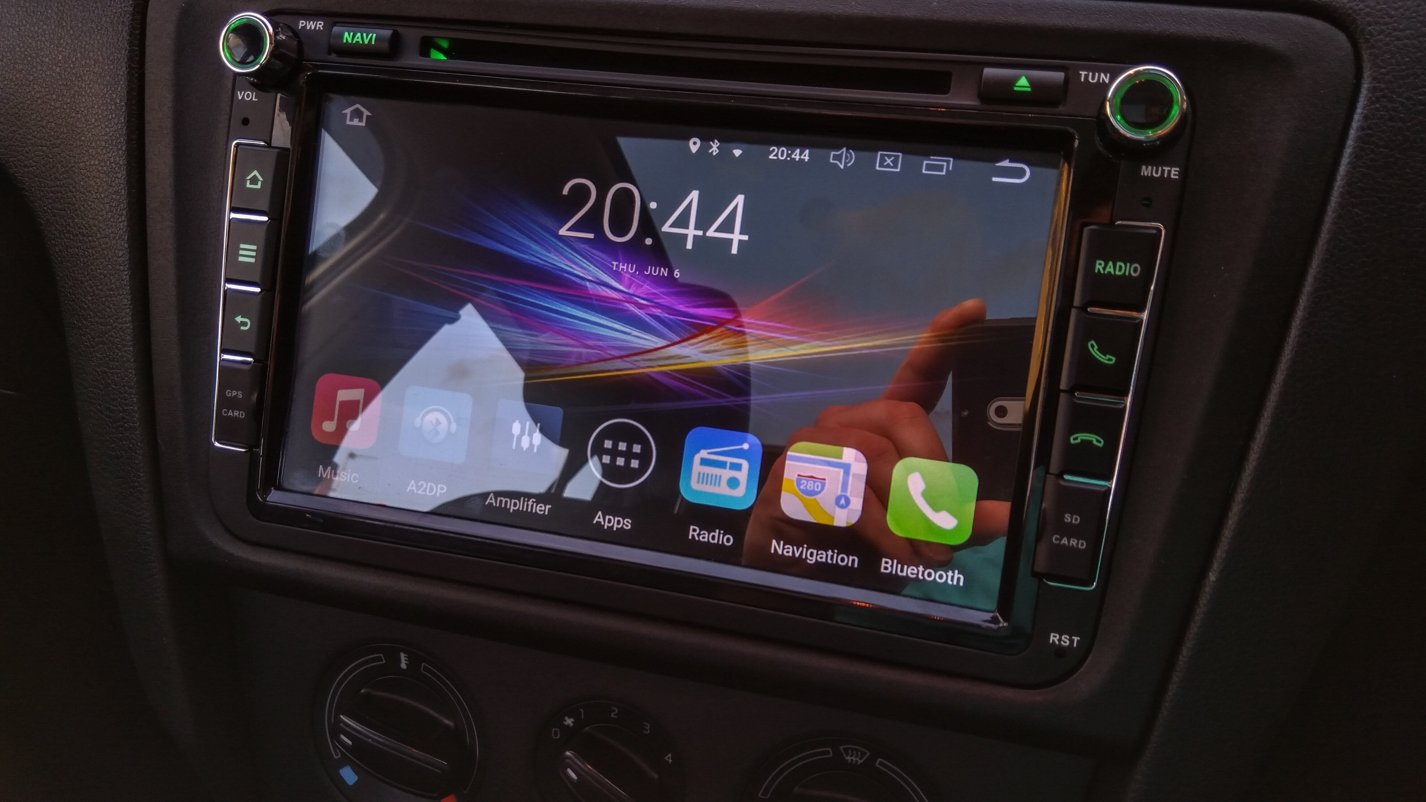

Audio Tech Direct Android Head unit fitted - Bluetooth, touchscreen, internet connectivity, Built-in Sat Nav, etc (£250 inc all leads)/replacement surround

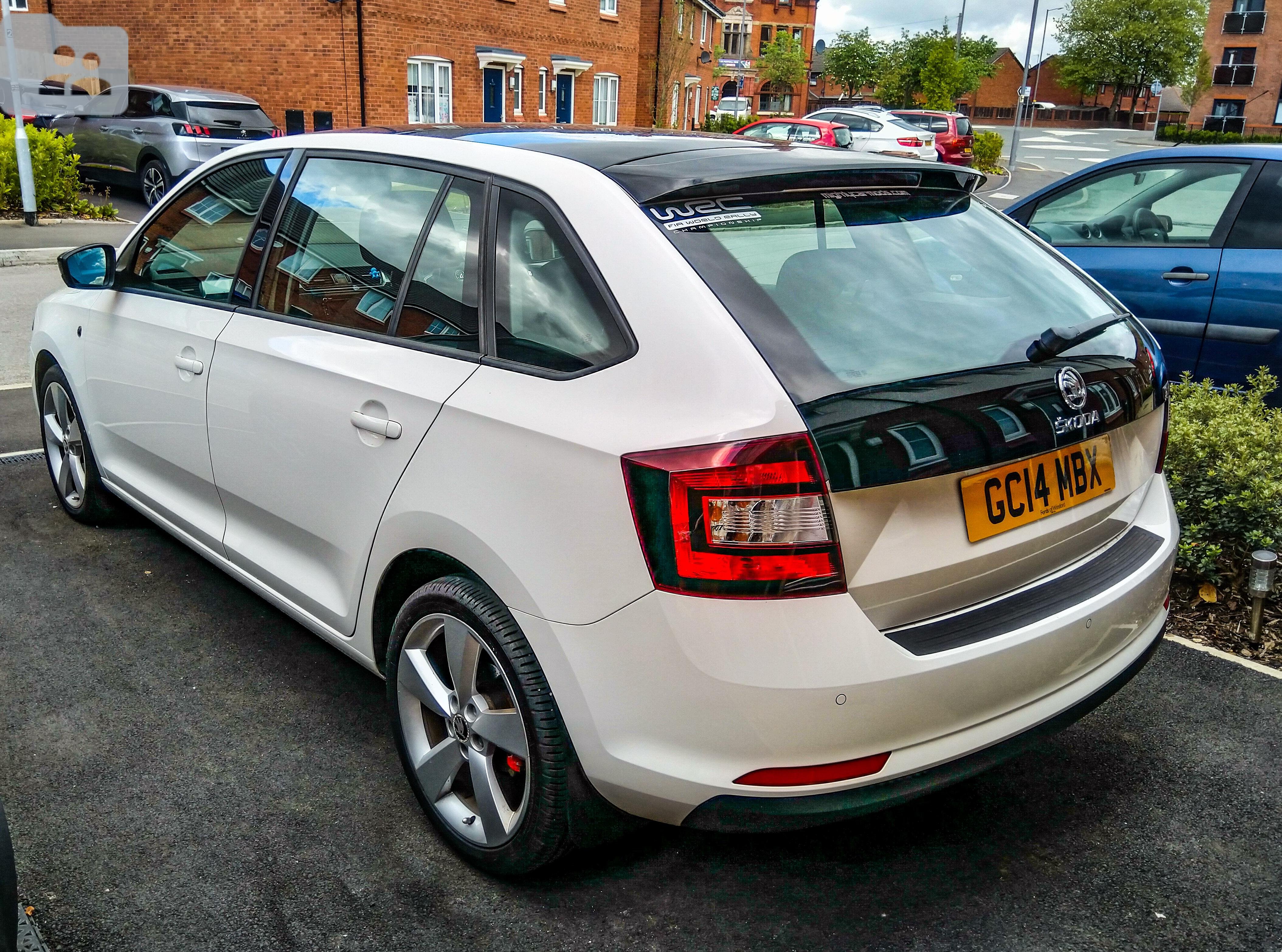

Now been branded with a all WRC vinyl and a Sale Sharks vinyl on the rear window.

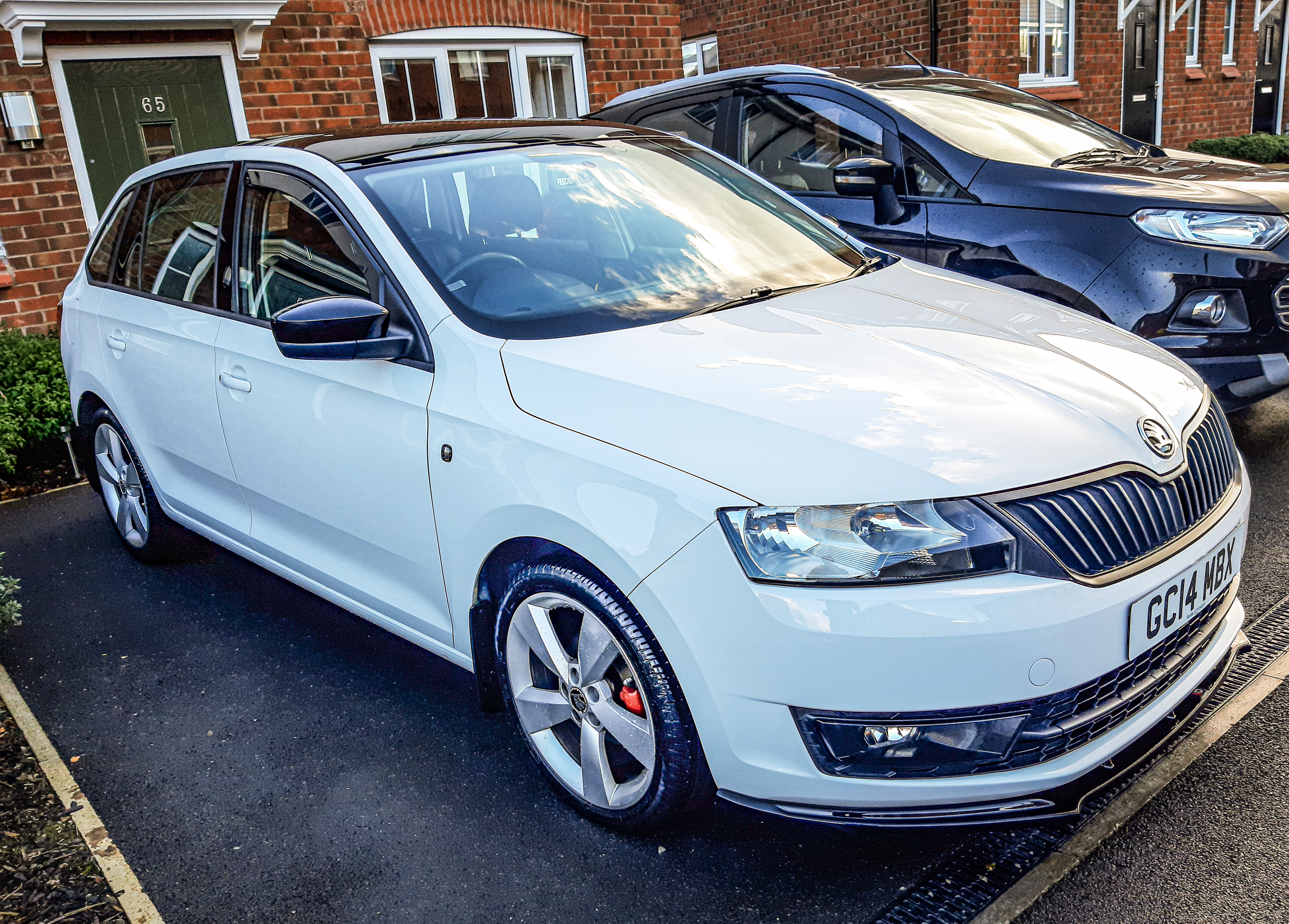

Maxton front splitter (from their eBay store, saving £30!) £100

How's the android head unit? Sound quality, radio etc.
Need to change my Swift with something better and as appealing as these chinese android units look, I don't really want to sacrifice sound quality and radio. Some of them look a lot like they are OEM head units.

I got mine from Audio Tech Direct and it's brilliant. Definite improvement over the standard Swing unit I had in it originally, and has improved the sound quality. The head unit come's pre-loaded with maps, Bluetooth, DAB+, ability for in-car entertainment, rear view camera etc and can connect to the internet through WiFi or mobile hotspot. It's Android 8.1 so can get any app on it that's in the Google play store. Only niggle is the Bluetooth, as when speaking to people through it they complain I sound like a robot and it goes very distorted.

Still sceptical about these chinese android head units.

All it is is an android tablet with a few add-ons. For the price (£250) I'm not too fussed as you'd pay that for a second hand Skoda unit, but I understand some people don't like non-OEM.

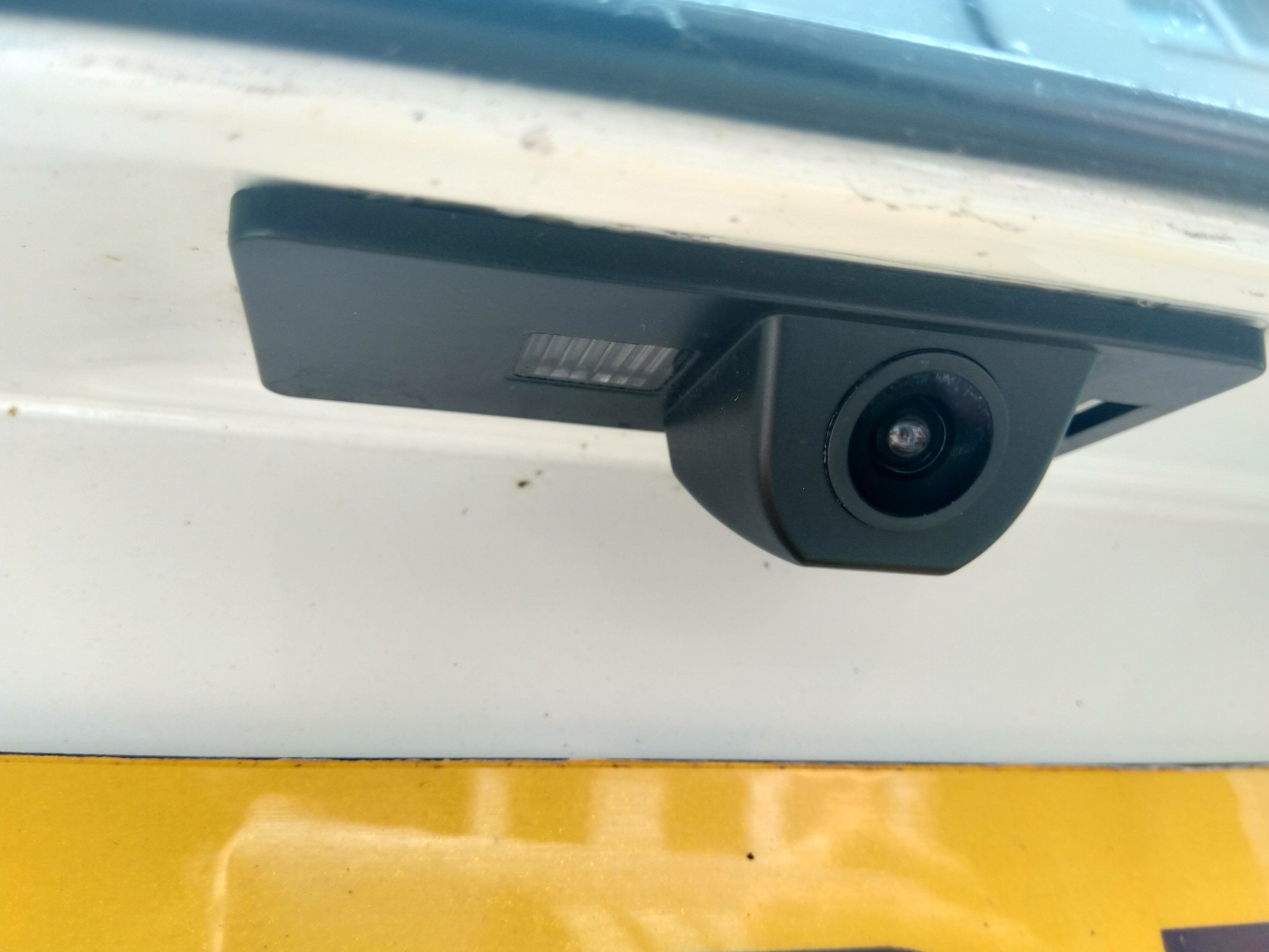

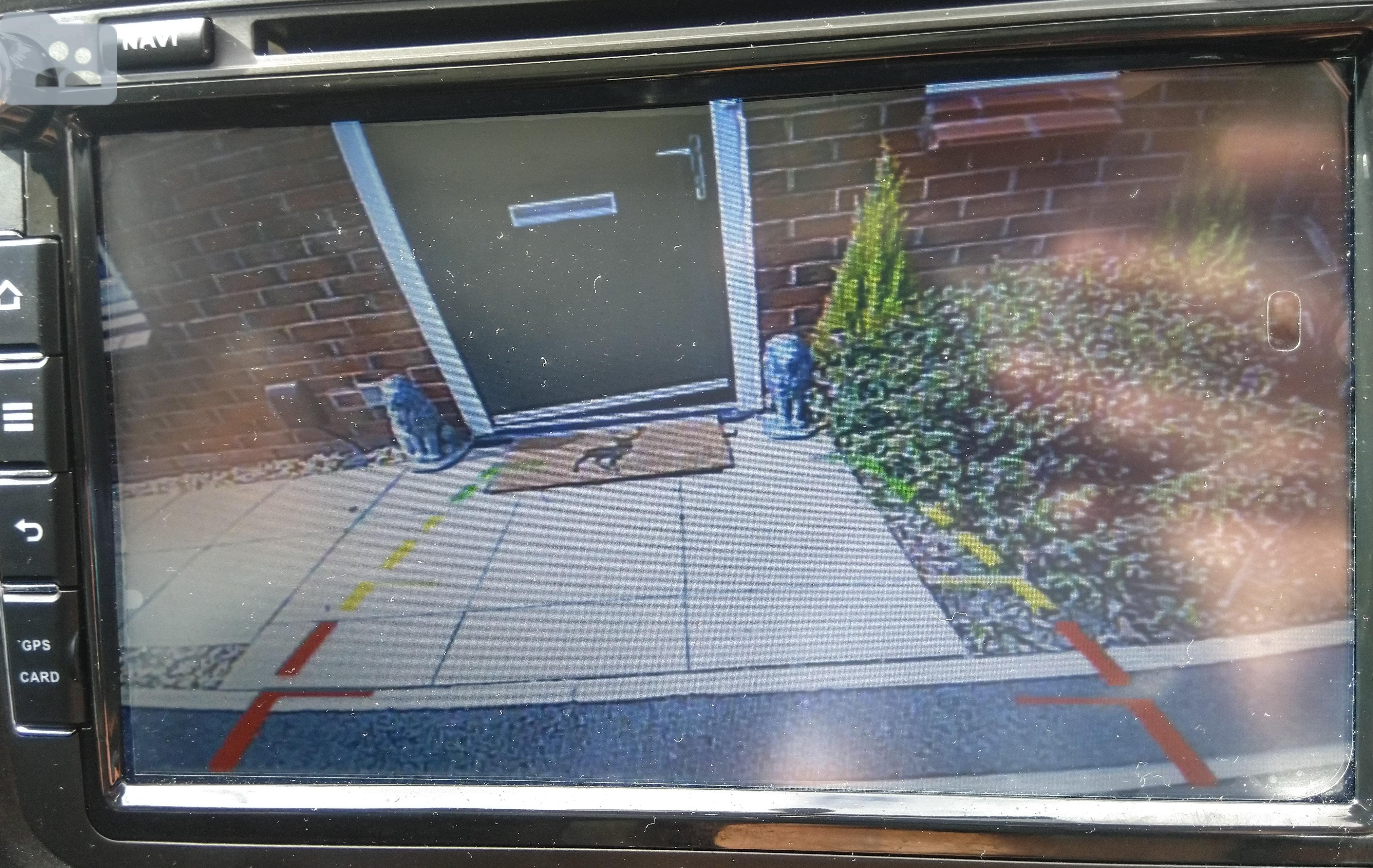

Fitted the rear view camera too, was a fun challenge to get the wire the length of the car (pushed it down the driver's side as easier to get it through the headlining). Really pleased with the result and great picture quality, also has nightvision!

What camera is that?
No end of them on Ebay or AliExpress for less than a tenner delivered.

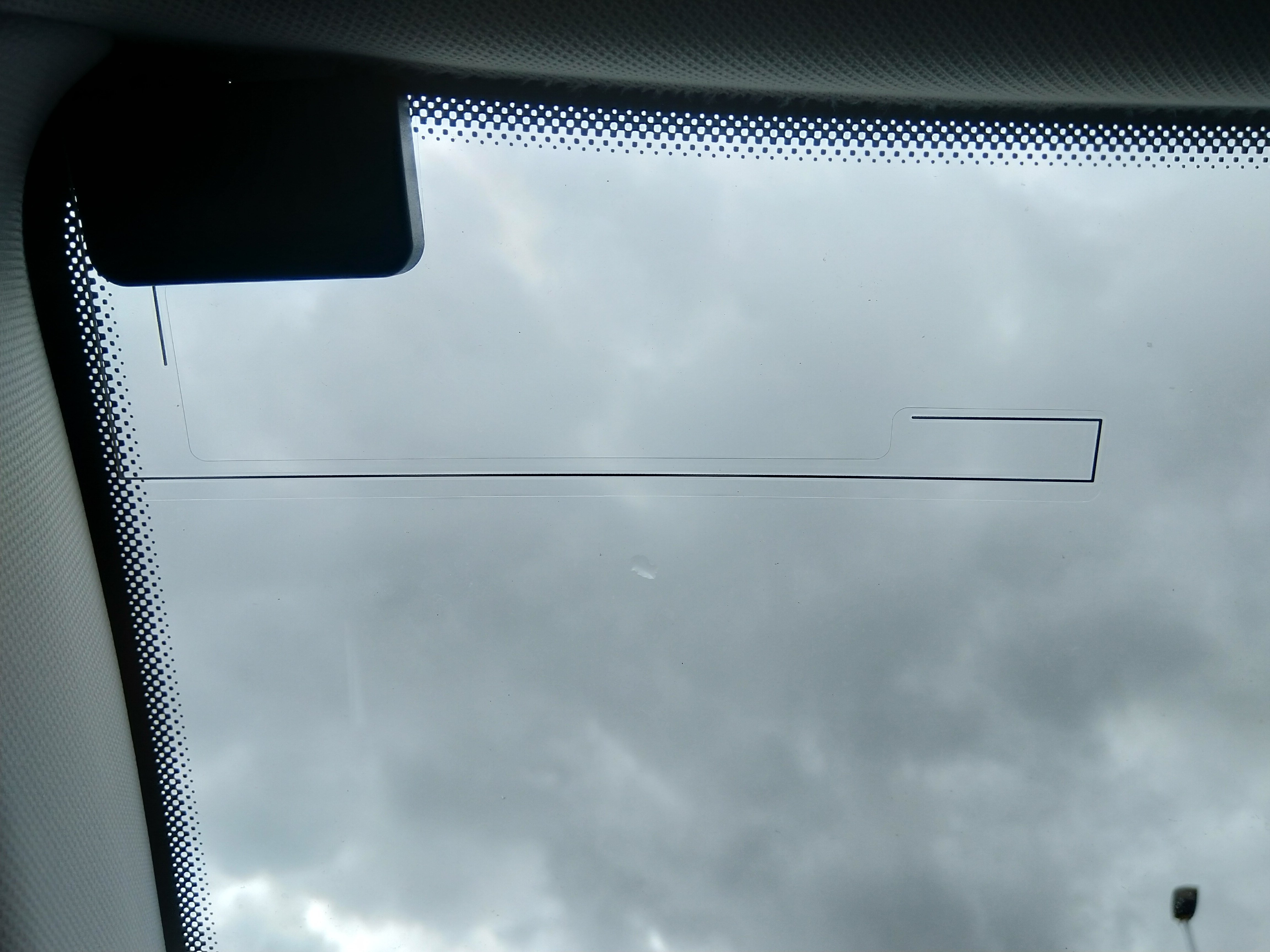

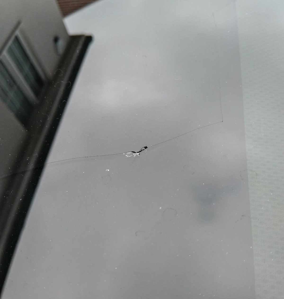

Oh bother.
Panoramic roof isn't covered under windscreen insurance, so will have to claim through general bodywork damage. No claims is protected, so won't affect policy. Still have to pay excess though.
Quote from Autoglass was £1,560.59
We had a pano roof Rapid for 3 years from 2015 how did that happen?
I'm guessing from a stone chip, but in all honesty I have no idea. On my way to/from work I drive and wait under a number of overpass bridges, so don't know if something's come off one of those and caused it? But I'll likely never know.  The crack goes about 1/4 the length of the roof.
Luckily, it's simple to replace as they'll just swap out the entire piece (including the blinds/screens) and they can do it at a local depot. Fingers crossed!

Roof done through insurance. Only cost £250. Took AutoGlass 6 hours to do as the glue for the roof was like concrete and they went through 3 whole rolls of cutting wire. Kept me updated the entire time so can't fault them.
Roof itself cost £1500 and they said the labour cost wouldn't have been far off with 2 of them working on it. Not bad for £250 and no change to my policy.
All sorted though!

On 04/11/2020 at 14:53, WolfyWesty said:
That front splitter looks mint. did it require drilling the factory bumper or does it mount into existing holes? Just bought a 2017 spaceback myself and looking at getting myself one of those.
Requires drilling, but comes with bolts to secure it on.
