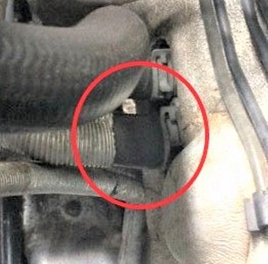

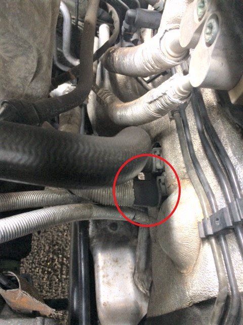

I’ve added a couple of pictures showing the location of the pipe. Comes out of the bulkhead (back of heater?) and drops down behind the engine block. Mechanic had a bit of a mare getting to it at the bottom.

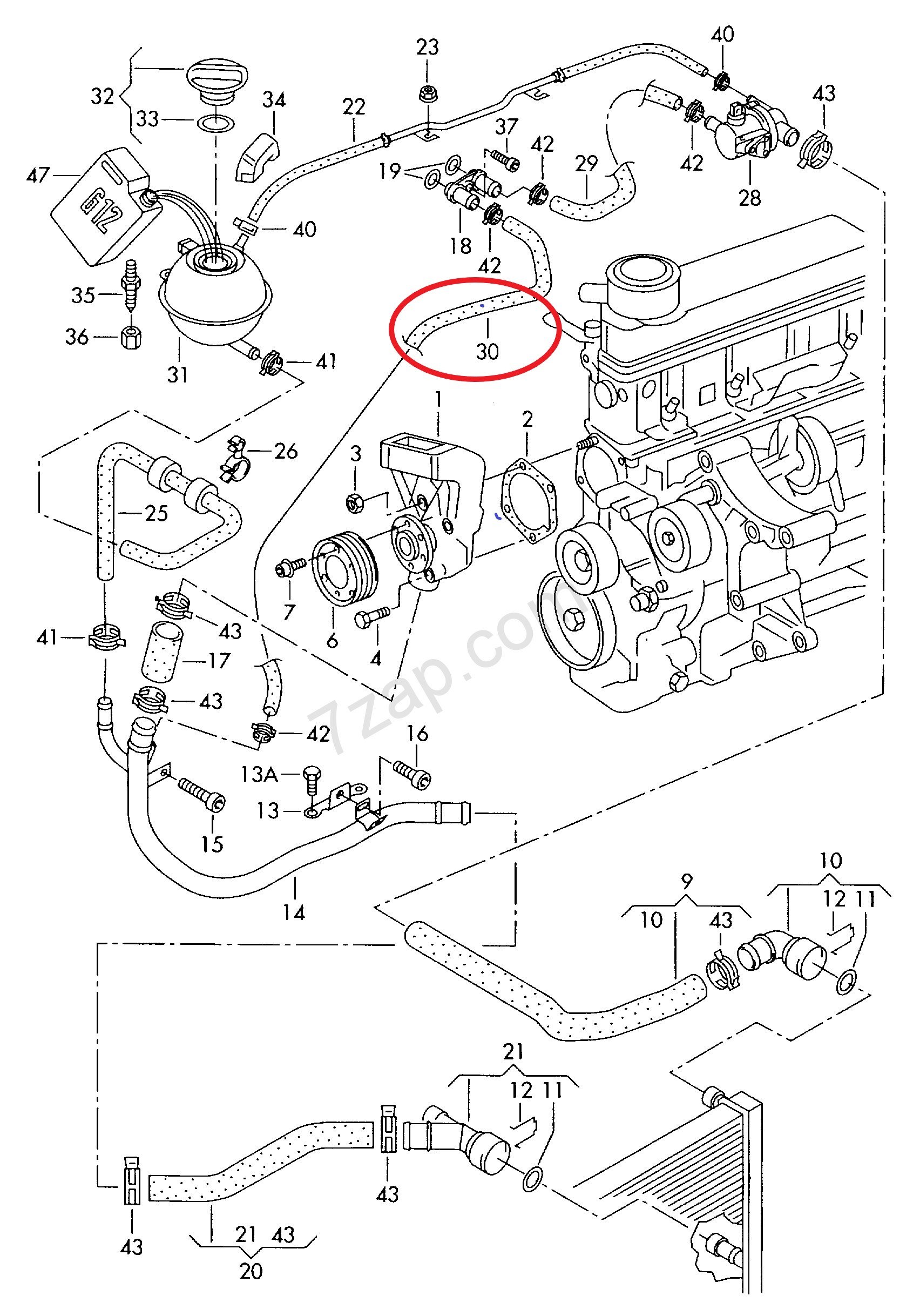

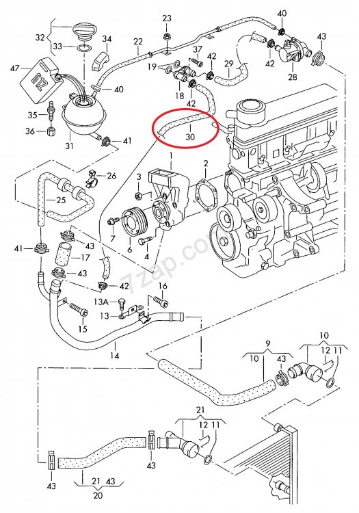

https://skoda.7zap.com/en/cz/fabia/fab/2000-225/1/121-121020/

The pipe you have marked on the parts diagram is the one going off to the left of the engine but the one you've marked on your photo is the one going to the right. That one is 6Y0 819 371
Unless the circle is just to show where both pipes are?
Edited by TMB
The circle appears to be where the gear linkage cables exit the bulkhead so I think it's an error.
No, the gear cables are just below. The pipes just above those with the grey spring hose clamps are the heater pipes.

The mechanic spoke with TPS and that's where we got the part number from. It is the part in the photo with the silver covering. Google 6Y0 819 371 and that shows a black pipe so it's not that one.

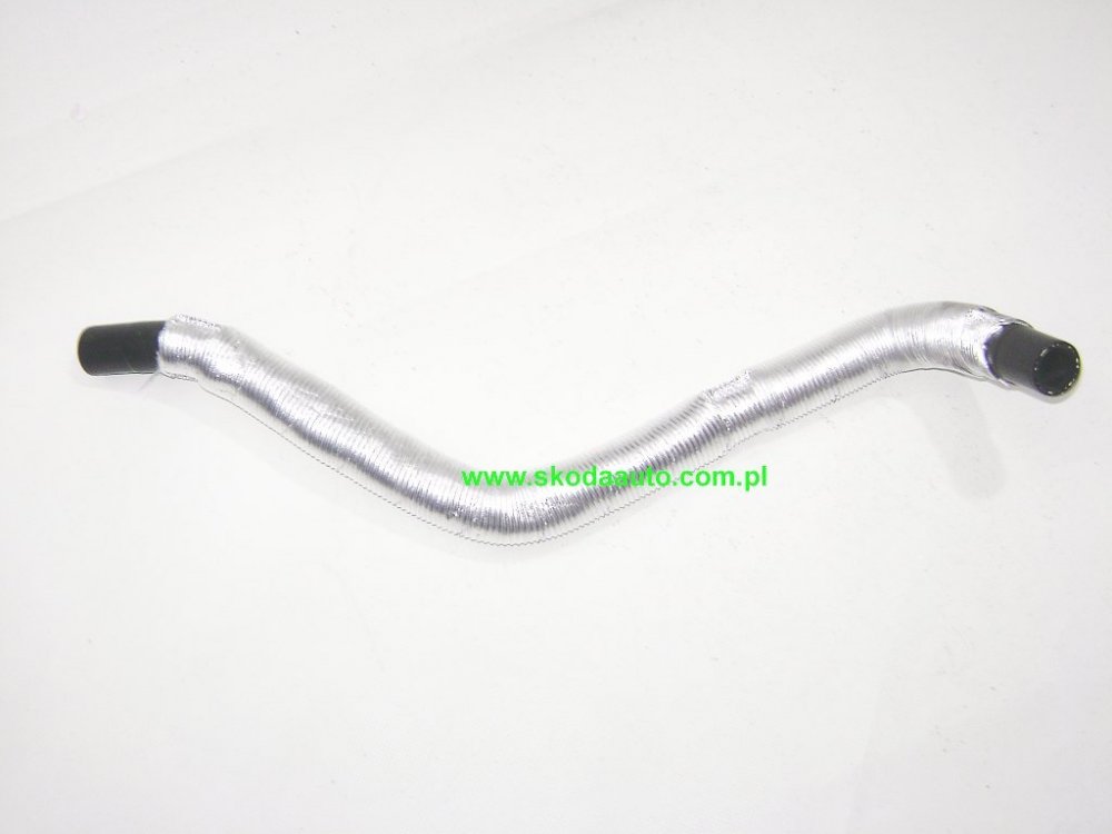

You may find that the convoluted alloy heatshield simply slides over the rubber hose, so you could transfer it onto the replacement part.  Depending on the bend radii, you could just buy a length of 3/4"/20mm heater hose from a motor factors and use that (slid up through the heatshield if poss.)?

I'd probably go down the route of threading a new bit of 'straight' heater hose up the old heatshield. See how loose the convoluted heatshield is on the rubber hose, to get an idea if it'll come off easily, then measure the OD of the rubber hose. See if your local parts shop has something the right sort of size.  I dare say you could buy a length of convoluted ali hose that was a looser fit if the transplant route looks tricky.

There's another one next to the one with the red circle, I suspect that too has the silver covering. You can see the spring band clamp on the other one, just on your circle's circumference.
What @TMB is saying is that the one you've circled is part number 6Y0 819 371 (item 29 in the parts diagram you posted). The one next to it,  mostly obscured by the foreground pipe in your photo, is the ...373C one (item 30 in the parts diagram). FWIW.

Ah, wait a sec!  The 'foreground hose' I just mentioned is the one going down to the other heater fitting, so they cross over on your car, rather than go as per what the parts diagram shows.
I wonder which is right? Not that it probably matters much.

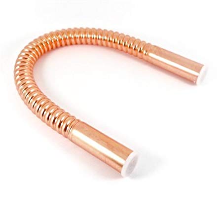

It would be madness to scrap the car over a heater pipe. It might even be the O-ring joint at the heater matrix barbs that is leaking and running along the pipe. In any case, something could easily be rigged up using straight heater pipe. In the past I have used 15mm copper plumbing pipe to make any bends in the pipe that were too severe for the rubber pipe. Just join it to the rubber pipe with hose clamps.
You can even buy flexible 15mm pipe...
