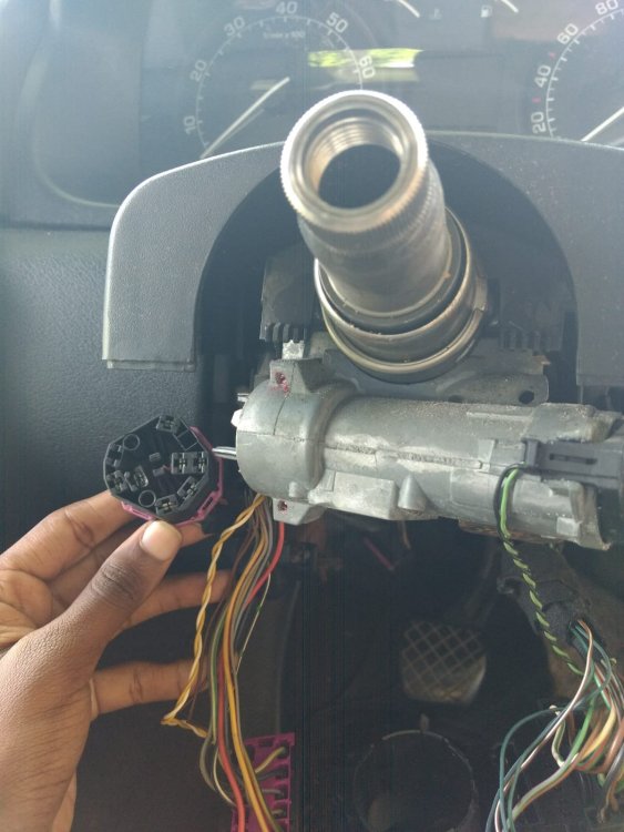

Made small progress. When I disconnect this, the issue goes away. I'm guessing that's what supplies power to the ignition. The question is, what do I do from here?

1 hour ago, nige8021 said:
There should be a constant live on one pin of the relay base,

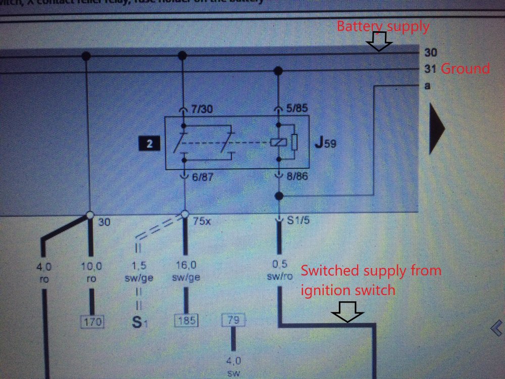

So if I get power on all four pins it's definitely a problem?
If you look at that wiring diagram, you can see there should only be 12v on 1 pin with the ignition OFF,
As you have disconnected the back of the ignition switch and the problem has stopped, it means the internal switch contacts in the switch have shorted as I said previously, so you need to replace the switch
