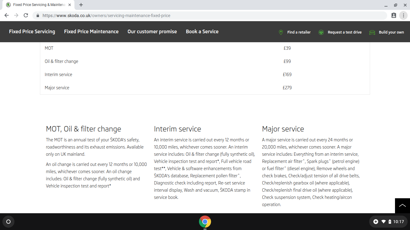

VW / Skoda Fixed price Servicing on 3-10 Year old TDI cars have Fuel Filter as a Major Service Item, but with TSI's have Spark Plugs,
no mention of Fuel Filter.
Master Techs in the know change Fuel Filters with a TSI.
