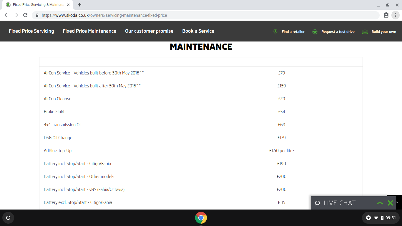

@ILOVEMYSUPERB,
Where you told by SKODA that it was part of the Service Schedule or 'guidelines' or by a chancer up-selling at a Main Dealership Service Desk.
The Manufacturer might be advising a A/C Service @ 2 years, but never put it on a Schedule, and Service Plans do not include it.
Main Dealers sell 'Skoda Approved Used cars' with a Warranty and Full Main Dealer Service History, yet these might not have had a A/C service @ 3 years
& the Main Dealership will not do one before Re-selling.
That will include where your A/C Service / Cars Service was done.
Edited by Skoffski
