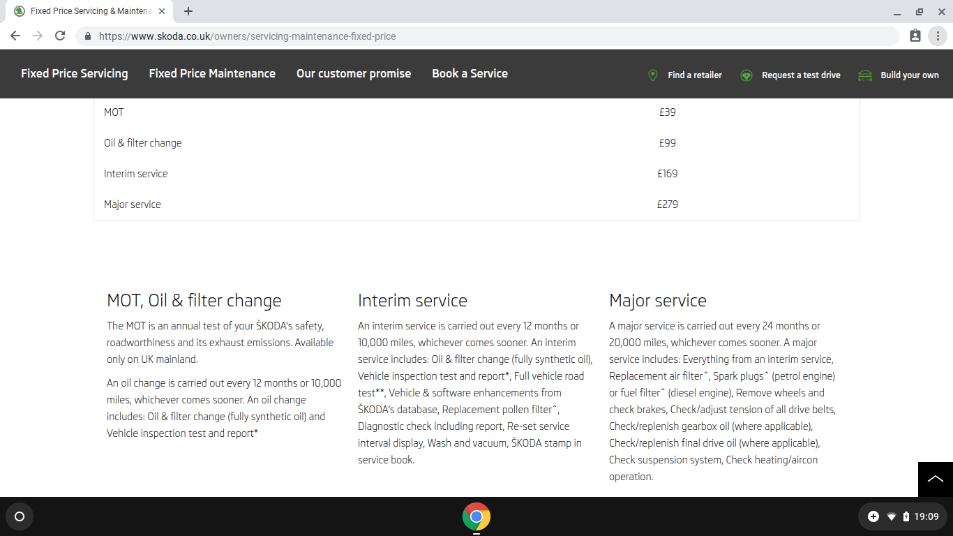

I don't know what a fuel filter is and if it is not replaced as standard in a dealership service every 9400 miles, then not at least for the last 60k miles.
DSG oil change was approx 26k miles ago.
Skoda Main Dealer Servicing should include the Fuel Filter being replaced at each Major Service from the 2nd one, so every 20,000 miles or so,
bi-annually.
It is part of the fixed price servicing and not for a tech to decide not to change.

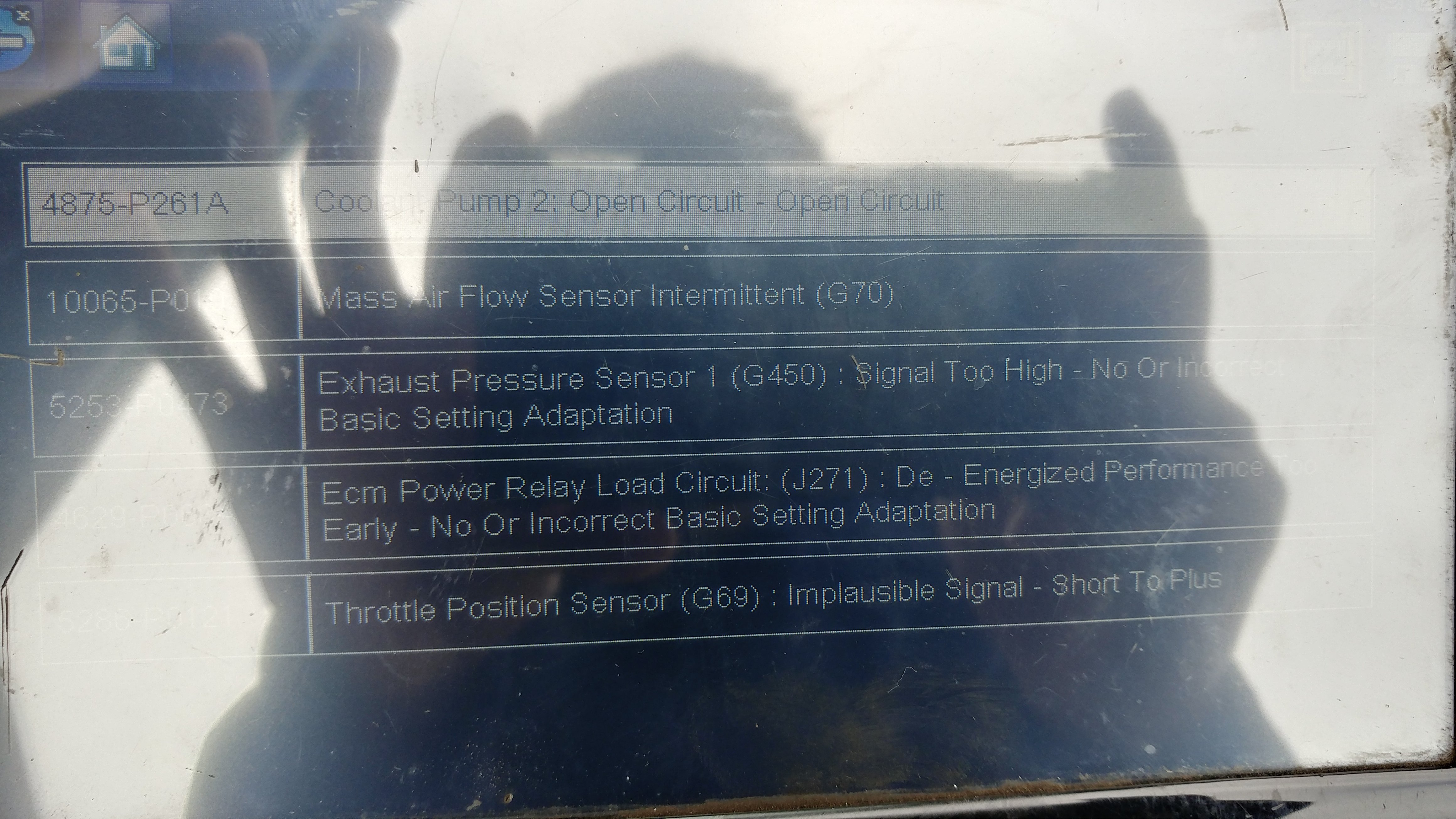

Engine light this morning has gone off.
Garage read codes, cleared codes and said drive it for 1 day or until light appears again then go back to read codes again.

"  Somewhen when shutting engine off rattle on last turn.  "
When you stated the above in your first post my thoughts went straight to the Throttle Valve G69.
When you shut down the engine this valve is comanded to shut completely by the ECU to give a smooth stop to the engine.
If it doesn't shut properly the engine will shudder with extra noise & vibration.
Your code read shows a problem with the G69 sensor giving an incorrect signal.
I would get the garage to start there.
This valve does get covered in gunge from the EGR that discharges just above & can stop it operating correctly.
It might need renewing or just cleaning or could be a just wiring fault.

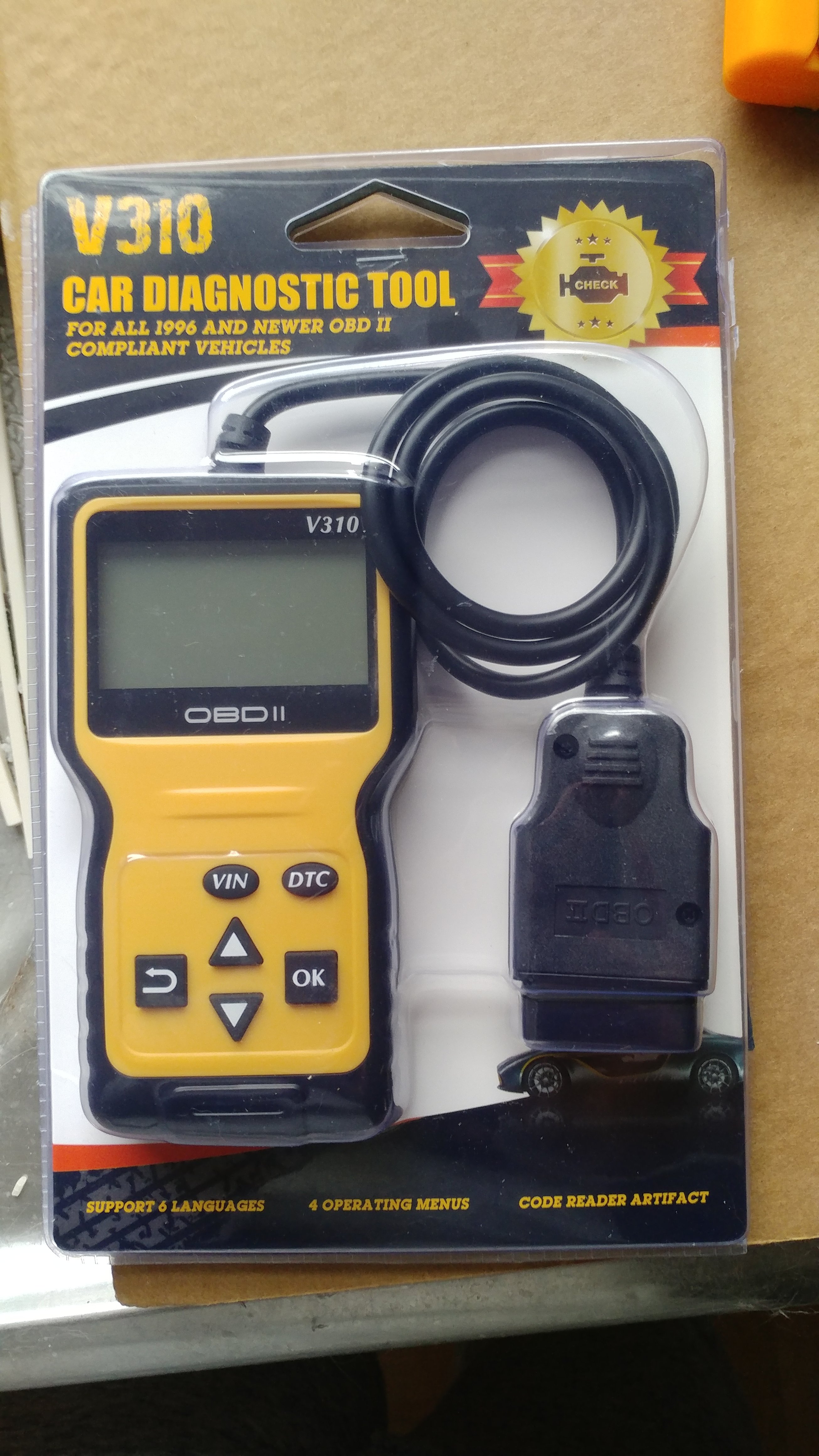

Turns out on amazon I can order something called an OBD reader for about 30 quid lol and plug it in myself.
Edited by newskodadriver
@newskodadriver   They can cost from hundreds of pounds to thousands of pounds
Its not just the cost of the equipment but the training and knowledge of the staff:wink:
A £30 code reader will give you basic codes only
If you bought the code reader which will give basic codes will you be able to do the work yourself or have to go to a garage with better diagnostic equipment to correct and fix the problem.
As said before I would take G69 and start cleaning:cool:

Well I bought one and its going to arrive tomorrow afternoon.
I don't understand what you mean about basic codes though?
So am I right in imagining that there are 2 sets of codes and 2 sets of rraders.
1 set of code is "basic", or non manufacturer specific?
1 set of code is "specialised"? And specific to that particular brand, like DSG for VW or Magic Air Suspension for something like Mercedes?
1 type of code reader reads generic codes only AND if there is a special fault, it will not only fail to read the code, it will also fail to tell the end user that it hasn't shown you all fault codes, whether they can be read or not?
The last type is specialist readers like VCDS or Odin and read everything?
People keep mentioning basic codes, and it would be worrying if a generic reader couldn't read code but also fail to inform you there was a fault there at all..
You already have the codes.
P261A etc.
Sensors G450 and G69 are well documented. Time to take the car to a reputable garage and get them to properly diagnose the and fix the issues.
Single fault code came up this morning. G69 Throttle valve
It has frequency of 4 faults in 125 miles since cleared.
It is booked in tomorrow to take out and inspect / clean, quoted 1 hour no parts, labour cost of 40 pounds.
So-called generic codes are those specified by the OBD/EOBD standards. It is a regulatory requirement that the engine (and transmission if necessary) ECUs support these for the purpose of maintaining the emissions control equipment on the car. As these are open standards it is easy and inexpensive to get a device that can read them. In general they will cover most if not all engine issues. Only engine and transmission ECUs are supported so these code readers cannot do any diagnostics on airbags, BCM, etc. OBD can support reading live data but it will depend on the vehicle, the scan tool hardware and the software connected to it.
Manufacturers almost always have their own additional diagnostic protocols which tend to be more comprehensive than the (E)OBD standards specify, but since they are proprietary protocols it usually costs more to develop scan tools to read them and that cost is passed on to the consumer. These protocols will cover all ECUs fitted to the vehicle and allow for comprehensive diagnosis of all vehicle systems.
So in summary, generic/OBD/EOBD scan tools are engine only and possibly a subset of all possible fault codes;  proprietary scan tools are manufacturer specific but cover more fault codes and vehicle systems.

Oh, and my own reader came today curtesy of Amazon, bought an opened one for £15. Reckon someone used it once then sent for full refund.
