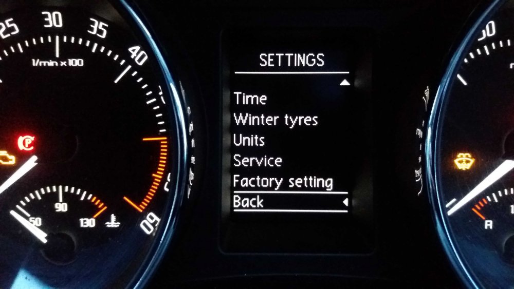

With the MK2 it makes a difference if it was / is on Variable Servicing or Fixed.
End of stalk rocker switch and little button at bottom of stalk.
If on fixed go into the Maxidot menu and Service, and select and then when asked if you want to change do so to '9400 miles / 372 days'.
