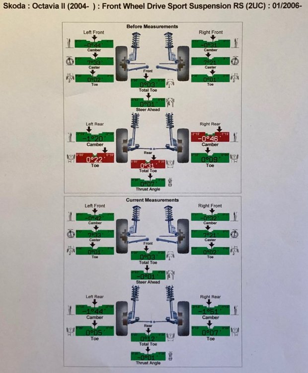

I had two tyres fitted to to the front of my 2014 Octavia III Diesel vRS estate at the end of last week.
The tyres were installed by a mobile tyre fitted at the office where I work, and he pointed out that there was some uneven wear on the old right front tyre and suggested I get the suspension/wheel alignment checked.
I had that done today, and there were some issues (with the rear end which surprised me). However when I got home I noticed that the 'target measurements' used were listed as an "Octavia II (2004- ) : Front Wheel Drive Sport Suspension RS (2UC)"
So, was this an error when selecting the car's details, or are the details for the Octavia II and III close enough that I need not worry?
Your values look fine compared to the upper and lower reference values from when I had my VRS aligned last year. Next time I'd look to find a garage that can look up the correct car settings though :)
yep he used the wrong settings.... should have been like....
The vRS settings are different from the standard Oct III as well

I took a stroll down to the tyre place, and showed him the error.
It appears that his alignment equipment doesn't have the latest cars in it's internal list, which is how he identified it as a MK2 and not the MK3 is actually is. He looked up the correct numbers and said that the front is fine, but that the rear was out, by so little as to not make a significant difference, especially if it lives on the motorway.
So, based on that I'm happier, but then this is far from my area of expertise, although still a little disappointed that my go to tyre place has out of date alignment numbers.
