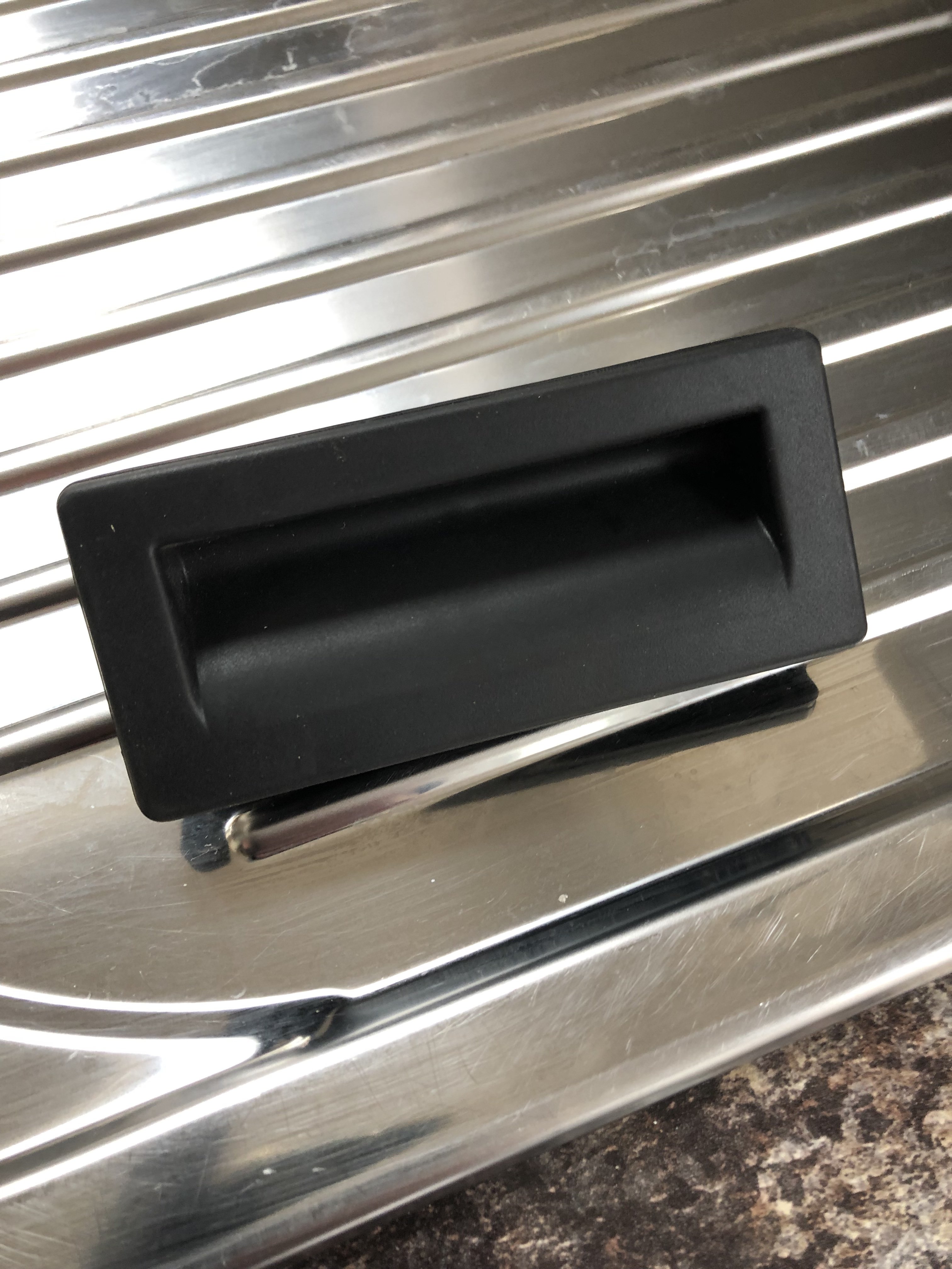

new part.

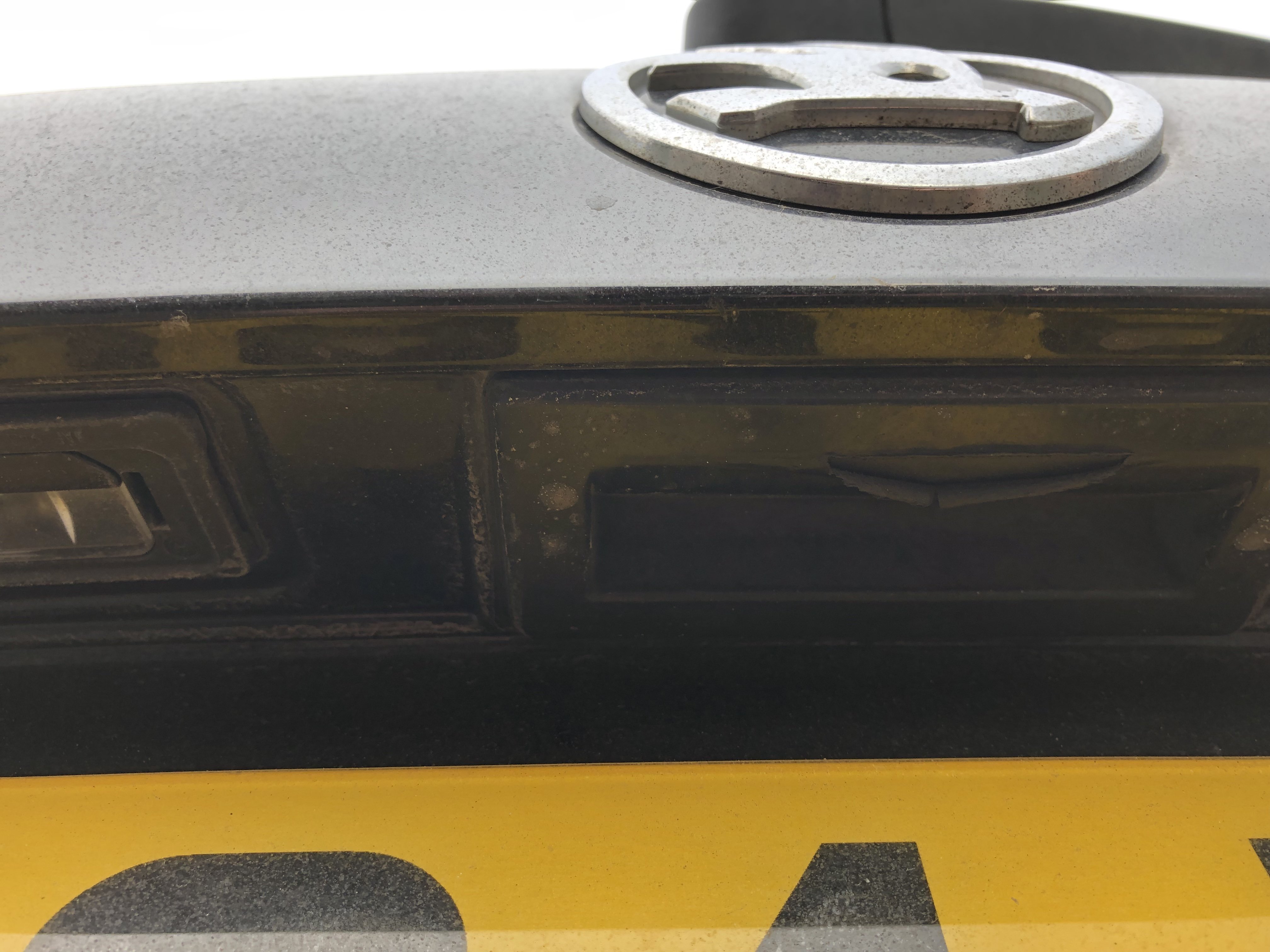

Old switch in situ.

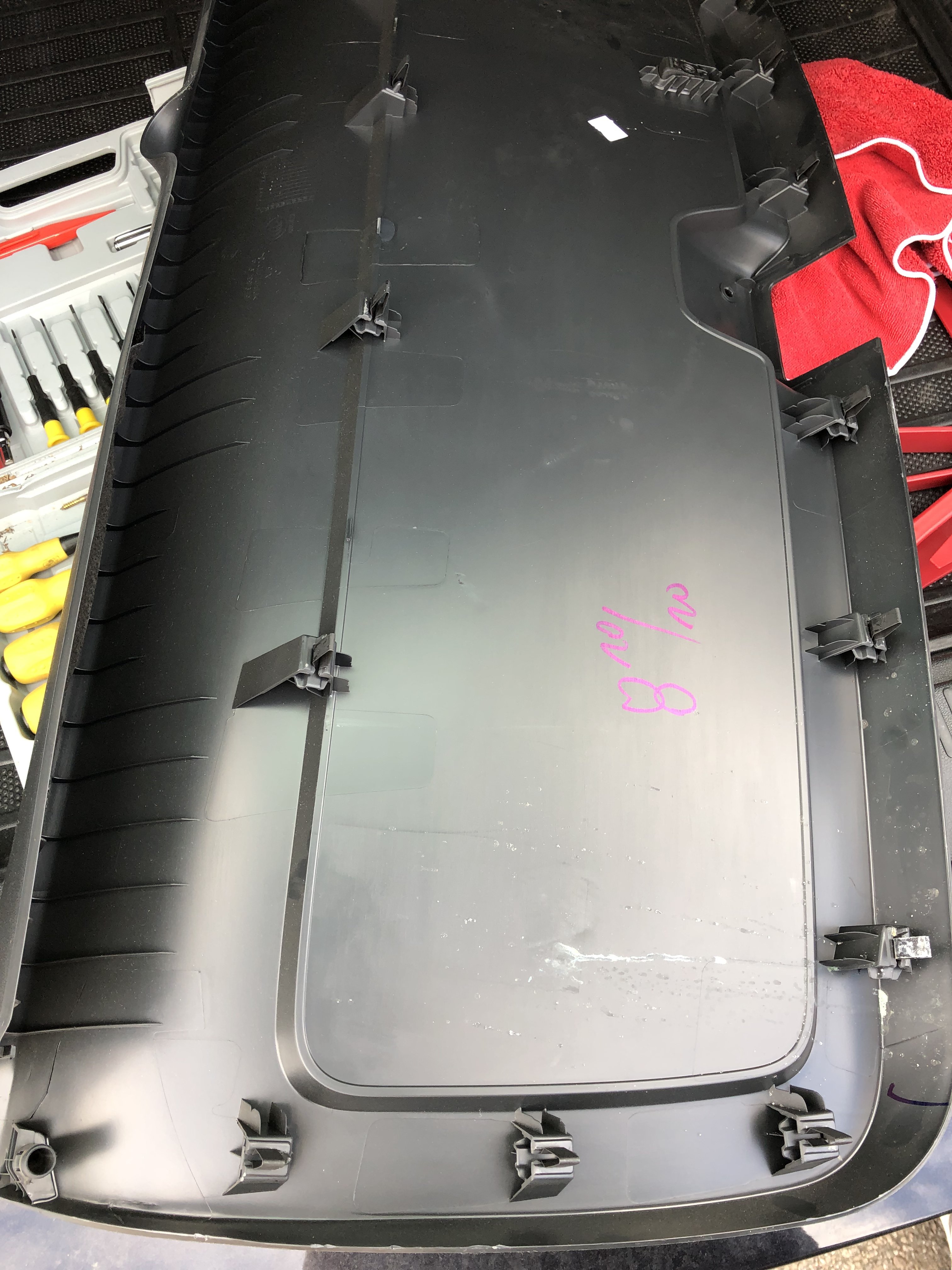

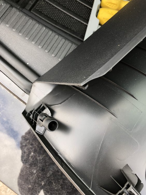

It’s easier to do from inside. The risk of paint damage is high doing it from the outside as it’s quite a strong clip.
Thanks for the info.
My task for tomorrow!
All done.
Removal tools were the saviour.
No clips broken either.
New switch in and working.
£15 eBay genuine from salvage of a 17 plate versus £113 brand new.
