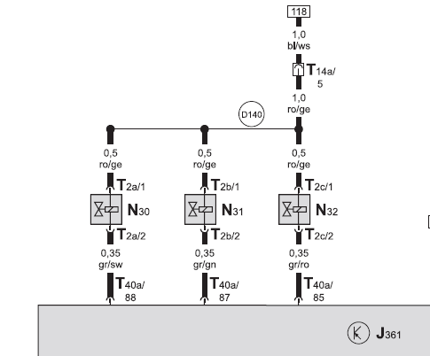

Injector wiring is simple enough. Red/yellow wire of each injector is connected to all the others, so disconnect all 3 loom plugs then continuity test each pin 1 to its neighbours while gently pulling and wiggling.
Each of the other wires goes straight to an engine ECU pin, numbers as shown here:

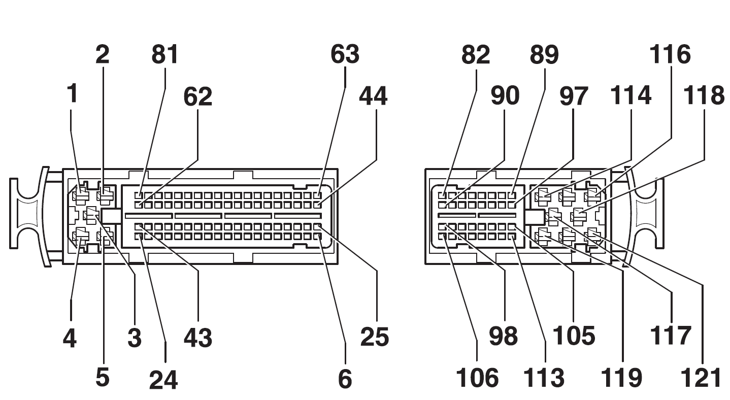

@Wino the ECUs pins being 88, 87 and 85? Don’t suppose you know where I can get a diagram for the ECU connector do you?
Yep.
Should be marked on the plastic of the connector, but this is the layout according to the WD.
