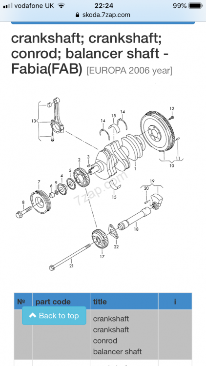

Injector part number looks like 03D 906 031 C, from here: https://skoda.7zap.com/en/cz/fabia/fab/2005-453/1/133-133040/#6
Looking at that, it seems like it's maybe easier to leave all three injectors clipped into the rail, then pull all three out with the rail, then undo clip (item 5) of the one you want to replace.
Or maybe take all three of the clips off, and pull the rail off all three injectors?  Let us know what's easiest?
Edited by Wino
Thanks wino, and yeah I’ve looked at the diagram and that’s the right part number to.

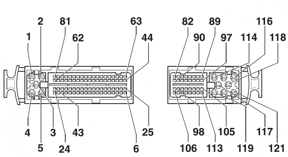

I would personally just hunt down any wire breaks and repair them. Engine loom is all one chunk, I think, so a bit 'baby out with bathwater' to change whole thing out for one bust wire. All the 12V feeds are easily checked, I think, and the low side wires will run straight to engine ECU pins. Can tell you pin numbering if required.
