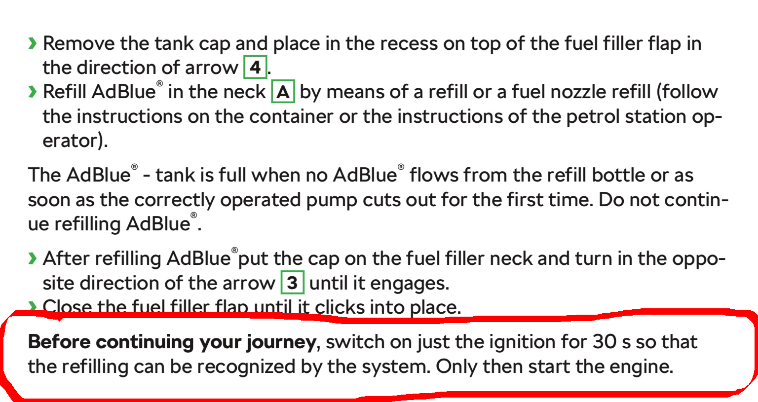

Hi guys,
I've just refilled my AdBlue tank, the third time I've done it in just over 12 months.
The computer showed a 3000 mile remaining range (out of a max 5500 on an 11 litre tank) - the computer said it needed a minimum and maximum fill of 0.75 gallon which works out at 3.41 litres.
So I have put in 3.5 litres in two stages - first roughly 2 litres and, then, the remainder of the bottle.
On neither refill has the remaining miles counter reset, and is still showing a 3000 mile range - I've even taken the car for a quick drive and it still hasn't reset.
Any ideas?
Ta
Andy
From the manual...
