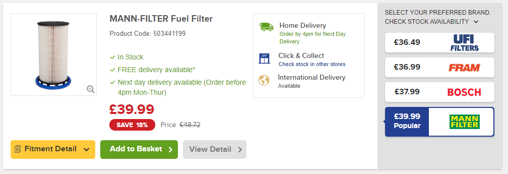

The man online catalogue suggested the short one a few months back.
I posted a picture of an example fuel filter housing earlier, asking what numbers were on the OP's housing. This is the easiest and most reliable way of confirming the correct fuel filter part number.
My screen grab above shows the UFI option too.
