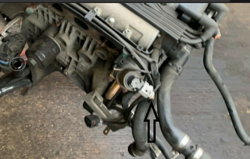

In that case have a look at the wires where they go into the connector (looking for a broken wire).

 Thanks I will look into that once it stops raining lol thank you for all your help.
