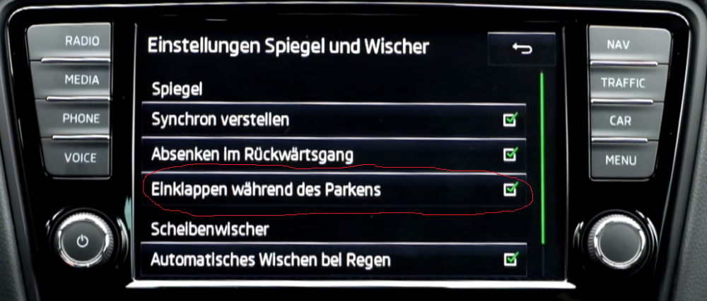

Hello, I am looking for coding for the option on the radio folding after parking because I currently do not have such and this option allows the mirror to unfold only after ignition. I attach the picture for inspection

In the Media display
Click "Car"
"Setup"
"Mirrors & Wipers", select the option for “Fold away after parking”

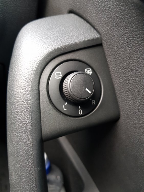

Is the switch on your mirrors adjuster set to the mirror icon?
i have octvia 3 2015 r
no on R
must be on the icon of the mirror because I have now on R
how is it to be because stego what associates it in O3 Is L R 0 and folded mirrors
Yes that's ok. You need to have it on the R so you can use the reversing drop down function.
Don't have it on the mirror icon.

The only other way is to close the mirrors is to use the folding option on the mirror control, but you have to turn this to the "mirror close icon" (on the top left of the switch as shown in the image below), and then move to any other position to unfold the mirrors.
If you fold the mirrors using the switch when leaving the car then the mirror does not unfold on turning the ignition, you must use the switch.

Well, nothing just did not make the only difference is that he in the menu has a description folding while parking and I jumped out folding with the ignition off

here you have a movie how it looks in Octavi 3 from 2013 and my question whether in 2015 it can be done and how
