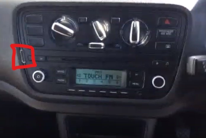

Hi, i got a 2014 skoda citigo and on the dash the photo holder has snapped of... just wondering if there is anyway to remove the snapped photo holder without removing the radio ? any suggestions would be helpful (see pic attached)Inkedscreencapture-youtube-watch-2019-05-11-10_35_11_LI.jpg.49d5247382e3fc75485c4e5d3f4243a9.jpg
Nope it's clipped on to the side of the radio and there will be a gap left if you remove it completely any way. It's very easy to remove the radio - and you'd only have to partially pull it out to remove/replace the clip. To remove the radio you do need removal tools though, but they are available for pennies from eBay
