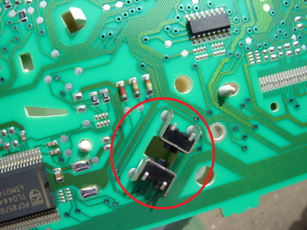

There are two switches on the back of the instrument cluster circuit board that the trip button presses on when turned/twisted...
Edited by TMB
TMB- I presume that's an old PCB, or you handled it using up to date ESR  precautions, else it's  also now a potentially fried PCB and it now comes with fries  fries ( chips ) on it. ( as in a fast food place saying "do you want fries with that?")😎
It's from a scrap cluster I bought for spares/to examine. However you can handle them as much as you want and nothing will happen unless you stand there rubbing balloons before you touch it.
