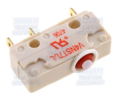

Hi, having problems with the front door after reading few topics, the symptom is the microswitch, my question for all is this the rigth one to replace it SAIA BURGESS V4NST7UL.

SPDT, as long as it's physically identical it will work just fine.

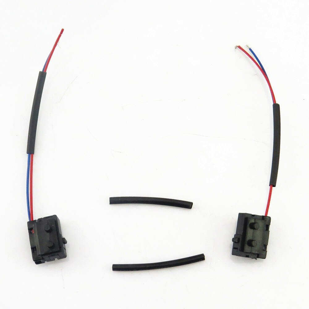

That switch will not fit. If you want one that fits perfectly, the part numbers are...
Left: 3BD998785
Right: 3BD998786
You can get them on ebay if you search the part number.
I bought these 2 switches hope they fit, they are the same part numbers
