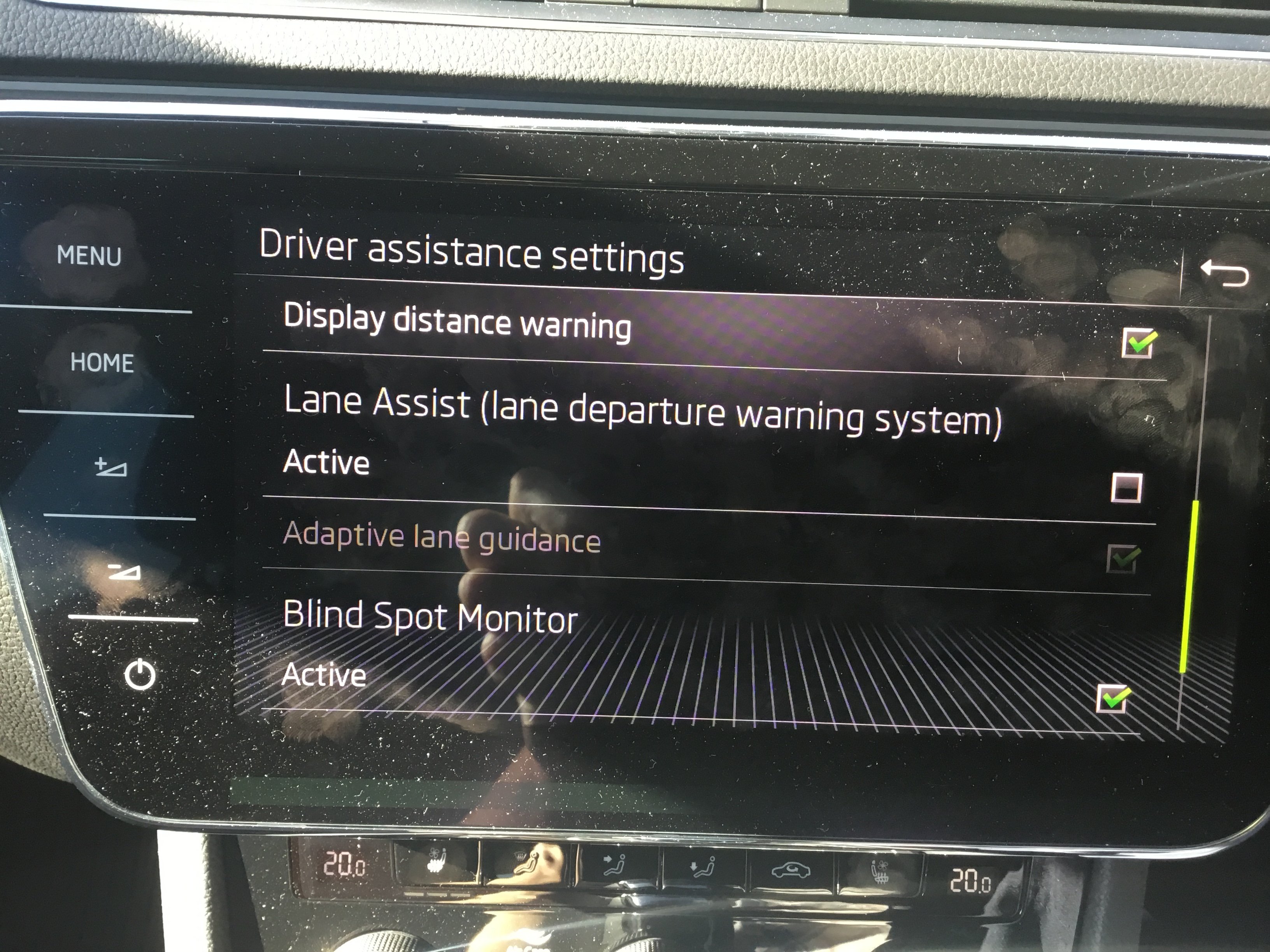

Hi Everyone, I've recently purchased a Skoda Superb L&K MY2019, i also have a 2016 model same L&K model, but on the 2016 I've got an option for 'Adaptive Lane Guidance' in the Driver Assistance settings menu, under Lane Assist.
With Lane Assist on it's own, the car ping pongs between the road marking lines, but with Adaptive Lane Guidance the car stays firmly centered between the lines, very nice feature, especially on the motorways.
Does anyone know what the 2019 model is lacking that would have activated this feature.....Traffic Jam Assist perhaps...?

Does it maybe show up once you activate Lane Assist? On the photo you sent Lane Assist is deactivated.
Hi Zid, thanks for the reply....unfortunately no it doesn't show up at all, even when Lane Assist is active....
I've just been out to check my UK spec MY19 L & K and it's the same as your first picture, with Adaptive Lane Guidance available. Is your new one UK or Irish spec?
Hi Mick and thanks for looking for me....my 2019 one is an Irish spec.....and my 2016 one is UK spec.
I think Traffic Jam Assistant is the culprit. There's no physical button for it, but ACC, combined with Lane Assist and Adaptive Lane guidance all appear to make up the Traffic Jam Assist (TJA)

For Traffic Jam Assist, you need ACC, Lane Assist and automatic transmission (DSG). You might be lacking DSG part. But, to be honest, I don't see how and why would Adaptive Lane Guidance depend on DSG on anything except Lane Assist.

I should have mentioned yes i have DSG, both cars, and the car (2019 model) without Adaptive Lane Guidance would end up causing
a traffic jam rather than avoiding it...;-), by bouncing off the white lines.
The 2016 model, with ALG steers like an autonomous vehicle in city and motorway driving.

I can code either Lane Assist or Adaptive Lane Assist to be active in isolation. Both work correctly with Adaptive showing both lane markings in orange and it keeps the car betweeen the lines.
I can also create a menu item on the Infotainment Display that shows Lane Assist active and Adaptive Lane Assist as a check box, but pressing it does not invoke Adaptive mode over the standard mode.
Maybe others can give the other codings a try an report back successes of failures?
