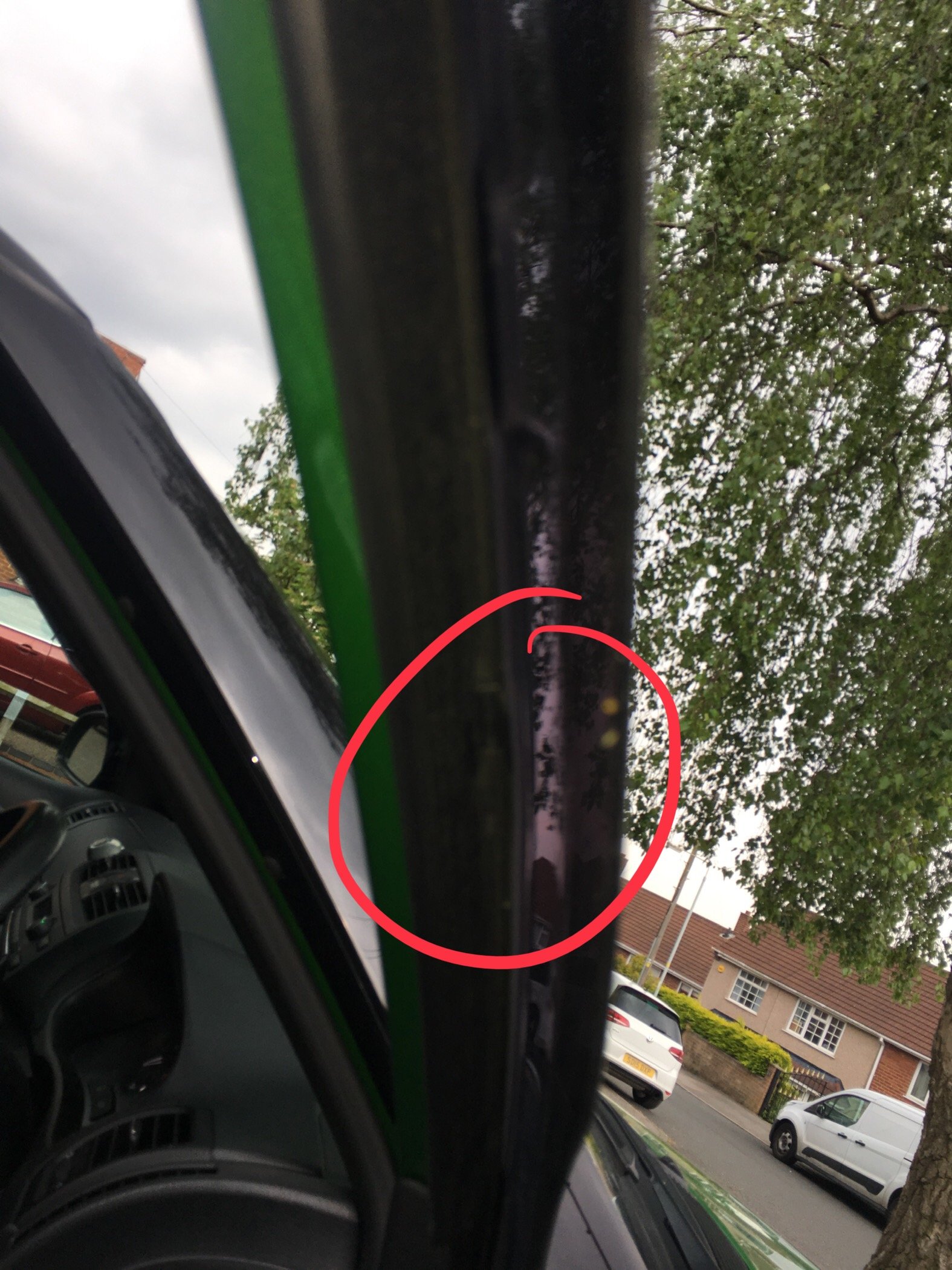

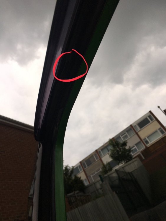

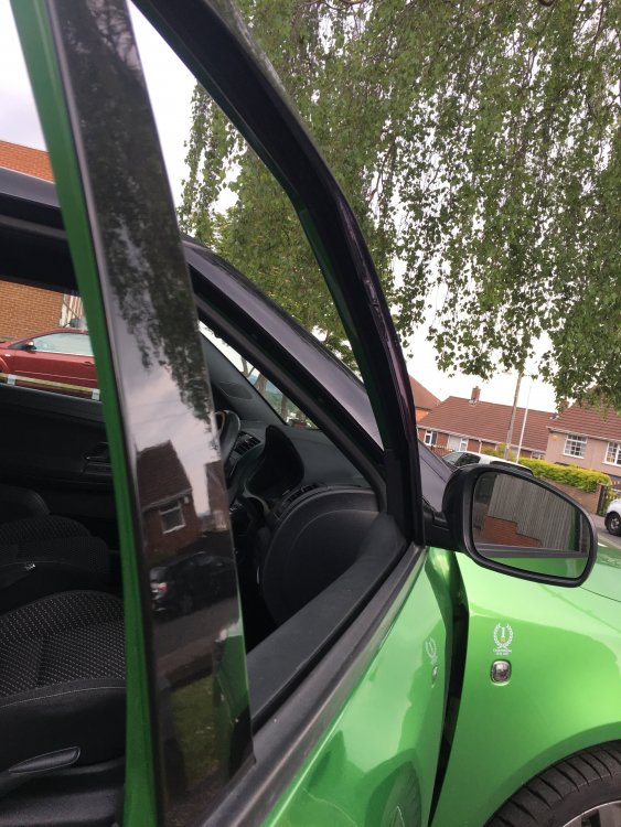

Sorry for the delay. Just had a look and took a couple pictures of the drivers side ( exact same on the passengers). Here is a few pics of the clip placements.

Thanks a lot mate i appreciate it, i decided to take them out completely and reinstall them and they seem to be working just fine apart from the passenger side sometimes goes up and down without me even pressing the switch🧐🤣 can you see the clips from the outside of your car? I can see my slightly as they dont seem to go up all the way and just wondered if thats how they were supposed to be or not?
You can just about see them if you are looking for them. I have genuine Skod ones on my fab, Heko's on a Yaris and as mentioned above, Never put clips on the Yaris. The drawback to that is that the adhesive tape eventually gives up the ghost and the deflectors start to sag!
I noe need to put new adhesive tape on them and tif them again but have yet to bother. (It does make them easier to nick). As for the window dropping etc, this is usually explained in the instructions...
Fit them and gently wind up the windows, bit by bit until fully raised and then, the important part, leave them alone for 24 hours, more if possible. This less the adhesive do its job properly. If the deflectors were fully inserted and the windows raised fully, the issue of windows dropping should be eliminated. It is actually a safety feature to prevent body parts getting trapped in the windows but the car does not realise it is just the deflectors.
The noise you heard was possibly the clips being pushed further in or the plastic deflector getting wedged between the clip and the glass. If the clip was pushed in properly, it should not do that.
There will be a slightly different noise as you have added a few mm of plastic to the closure but it won't be too bad and you will get used to it, even forget about it.
Dirt will do the same thing, kind of grind/crunch as the window shuts or starts to open so keep the glass and the deflectors reasonably clean.
