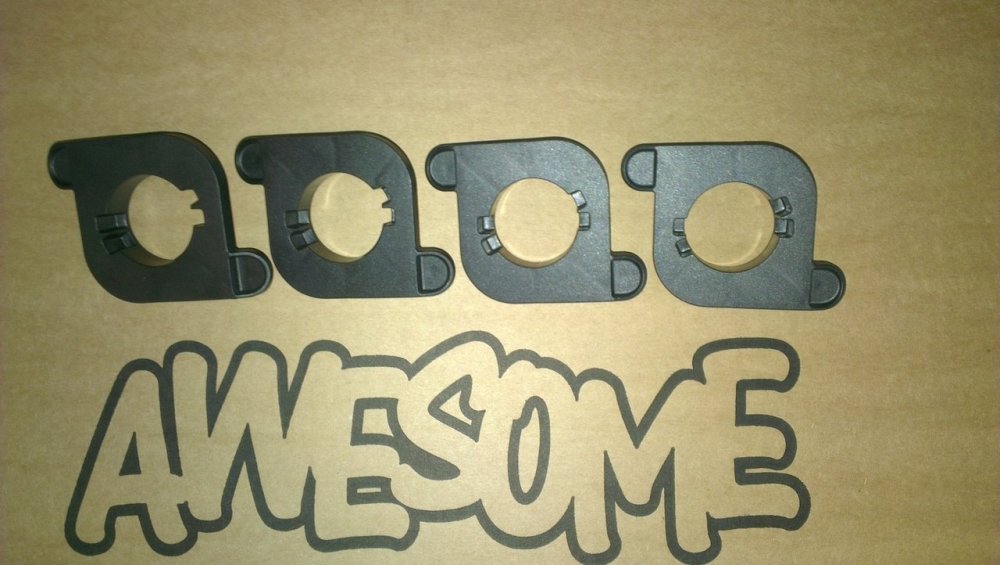

I havent touched the coil packs just looking the upgrade them to the r8 ones as they have been good for a lot of people

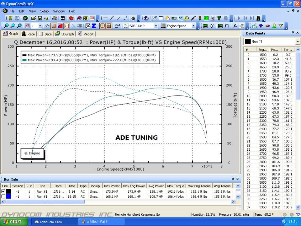

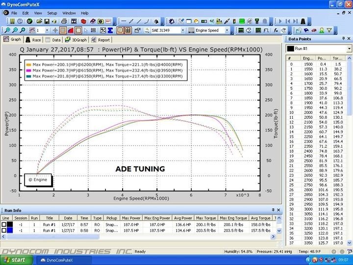

Another DYNO run should not cause issues unless something not right to start with or something has recently failed...(ie plug / coil)
 Was you map custom tweaked (or a cut & paste)
ADE did mine custom i saw all the cut & paste figures at other places of 210BHP (Stage 1) and told them to build some extra safety margin in & maybe get to around 200 (my car was down at 174 Pre map) We settled on 202BHP.

I think you got 195 bhp on a dyno and as the car was with the engine it had and the software on the ecu it might of already had 195 bhp.

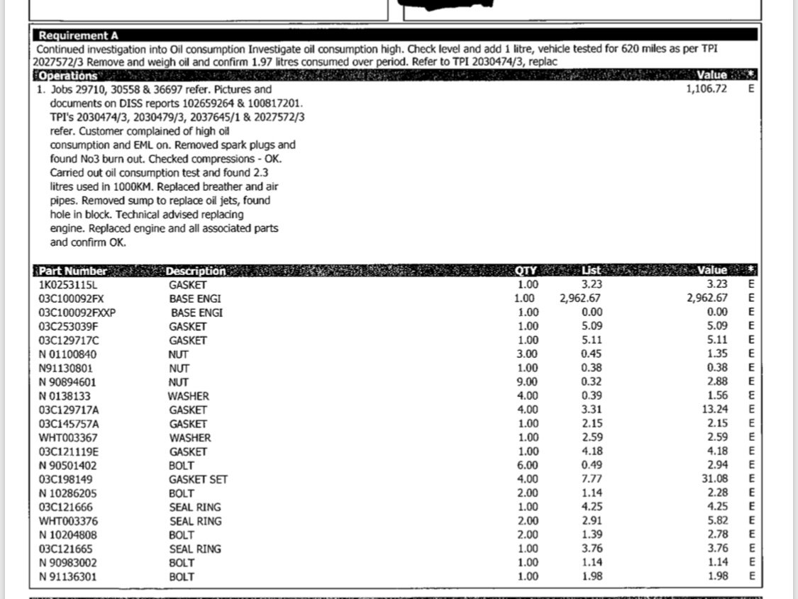

I’m really keen on doing a Fabia VRS meet has anyone done one or been to one? How to organise one?
@RezaVrs
The rebuild has a lot to do with things, and which ECU is on the car and what Engine Management as it left the factory, and what your 'coder unlocked' if they did to get 195 ps which the car maybe had anyway.
All basic stuff if you look into what you actually have in the way of a rebuild and the ECU.
That is for the engine, i am not speaking about the mapping of the DSG.
So what has it, a replaced Base engine, did it need a ECU as well as they could not get the new engine running with the ECU that was on the car?
This is the stuff that makes a difference.
Then was the Cat replaced because it had been contaminated with the Oil user that had been in the car.
Replacing an engine and all the parts is something the invoice needs to show.
The Engine can come with new plugs, the coils are not replaced, the water pump is the same, the belts etc.
So what are all its components? What more than a crate engine?
Edited by Skoffski
1 hour ago, Skoffski said:
@RezaVrs
Okay a simple test:
Car prior to remap had the best 0-60 times (trial and error approx 50 times in the span of 1-2 months) of 6.24 seconds.
Remap done, dyno’d at 195bhp with misfiring issues (and an overdue oil + oil filter replacement issue) possibly holding back the 10-20 extra horses.
spark plugs sorted, car worked wonders. Now best 0-60 time i’ve got recorded is 5.75 seconds. This time i did the launches around 15 times and within about 1-2 weeks of replacing the plugs and different weather conditions and different roads I achieved that without adjusting it further aside from the plugs.
this clearly tells me the map has worked, i just do not want to dyno it for one final figure unless im absolutely certain i dont have any misfiring issues what so ever. So if i need new R8 coil packs as insurance, ill do that.
ive attached engine replacement invoice
Brilliant.  So a base engine, that can be brand new or refurbished from the factory and looks like a new ECU was not required.
So what does that mean for me? Just means the ECU is the old one and the engine is new but ... ?
It means you have a car that had an CTHE engine that was an oil burner, and has the ECU that was fitted at the factory.
If it was my car i would check the build date and the Warranty / Service history before the engine replacement,
i would want to know what Engine Management / Map it had, and was it an CTHE that had a 'software update', because some early cars required that.
Once you have no misfires and know it all well again i would get a stage 1 remap, maybe from APR.
Nothing Custom unless the person doing it has CTHE experience.
The 0-60 time is affected by available traction much more than power, the quarter trap speed will show the power increase much better. When I changed from worn Rain sport 3's to Pilot Sport 4's my 0-60 fell by 0.4 seconds.
George is correct that the car could have been making 195hp before and the same now but with a nice torque increase that you feel. If you are happy with how it drives why does a power figure matter?.
On a side note, I was using an MBC to see what the turbo could do when really pushed... Even at 25psi peak it didn't make any more power at 6000, just lots more between 4000 and 5000 do I didn't see the point and went back to my Bluespark.
