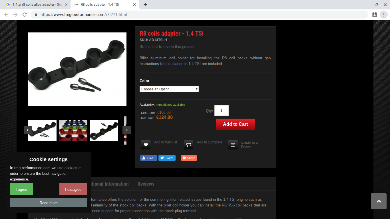

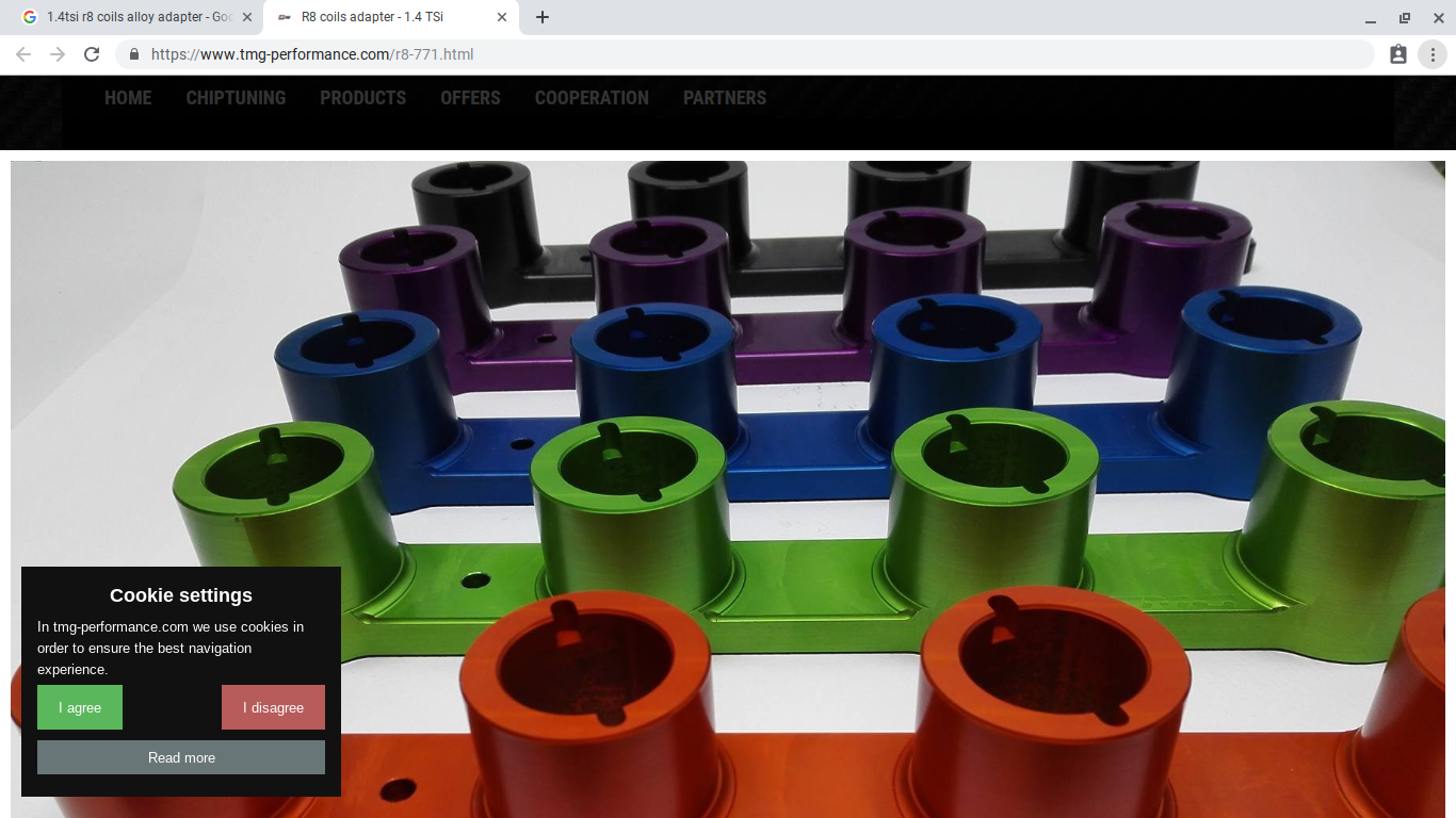

what does the coil adapter do?
Acts as a spacer / bridge for the longer coils so they are not just sitting up unsupported. Blowing in the wind.
Stylee.
You can fabricate something or someone might do cheaper than those.

What bracket/holder did you purchase?
Well said!
i havent bought a bracket so they’re dangling abit in the air
the only one i’ve seen is for €125 from RTMG, do you know of any slighlty cheaper elsewhere?

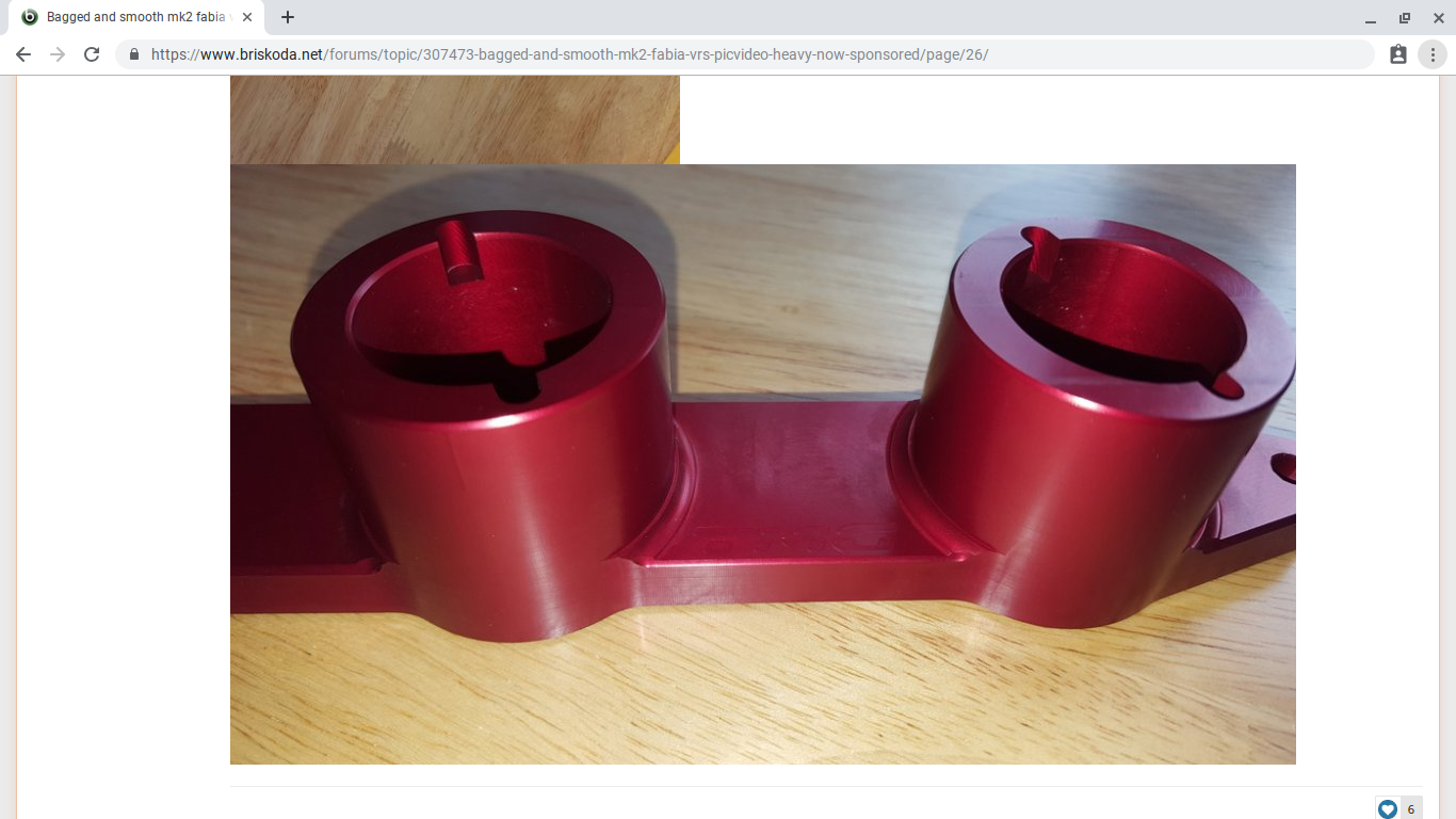

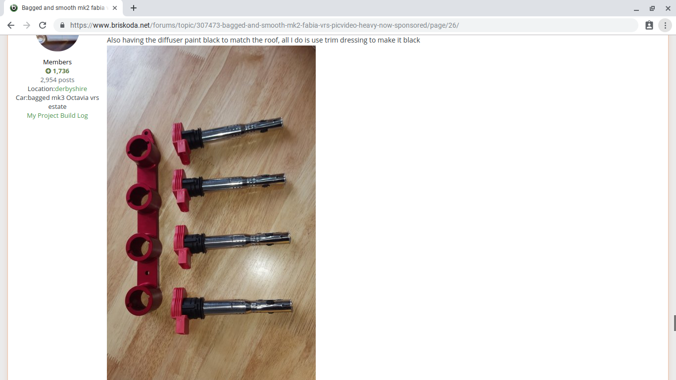

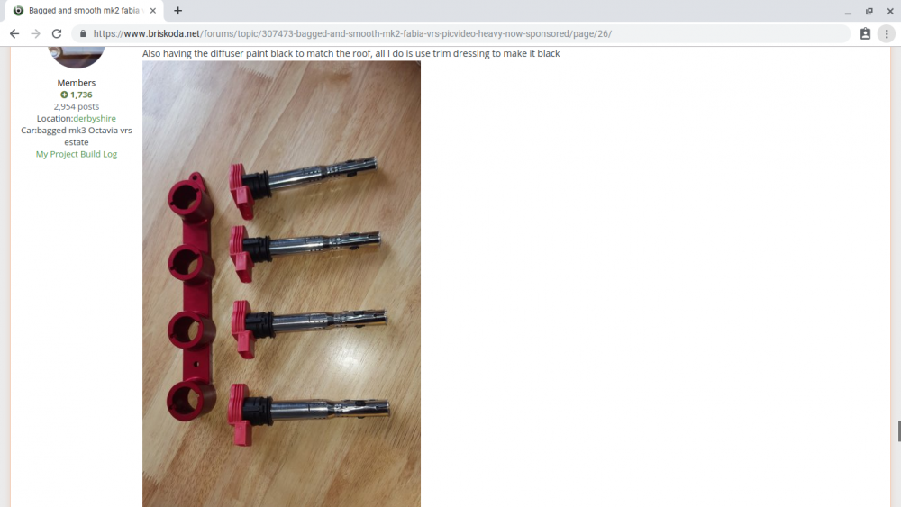

To be honest.....I was just lining that question up myself for you to answer,£125 is steep, how secure are yours and they holding out under load?
Edited by Mickmartin
So far its all good and well no problems
however the real question is will that brace even fit giving the fact the cylinder one is really tight fit due to the breather pipe literally pressing on top of the coil it was a real nightmare fitting that one
Any pics of them fitted? Would be interesting to see.
