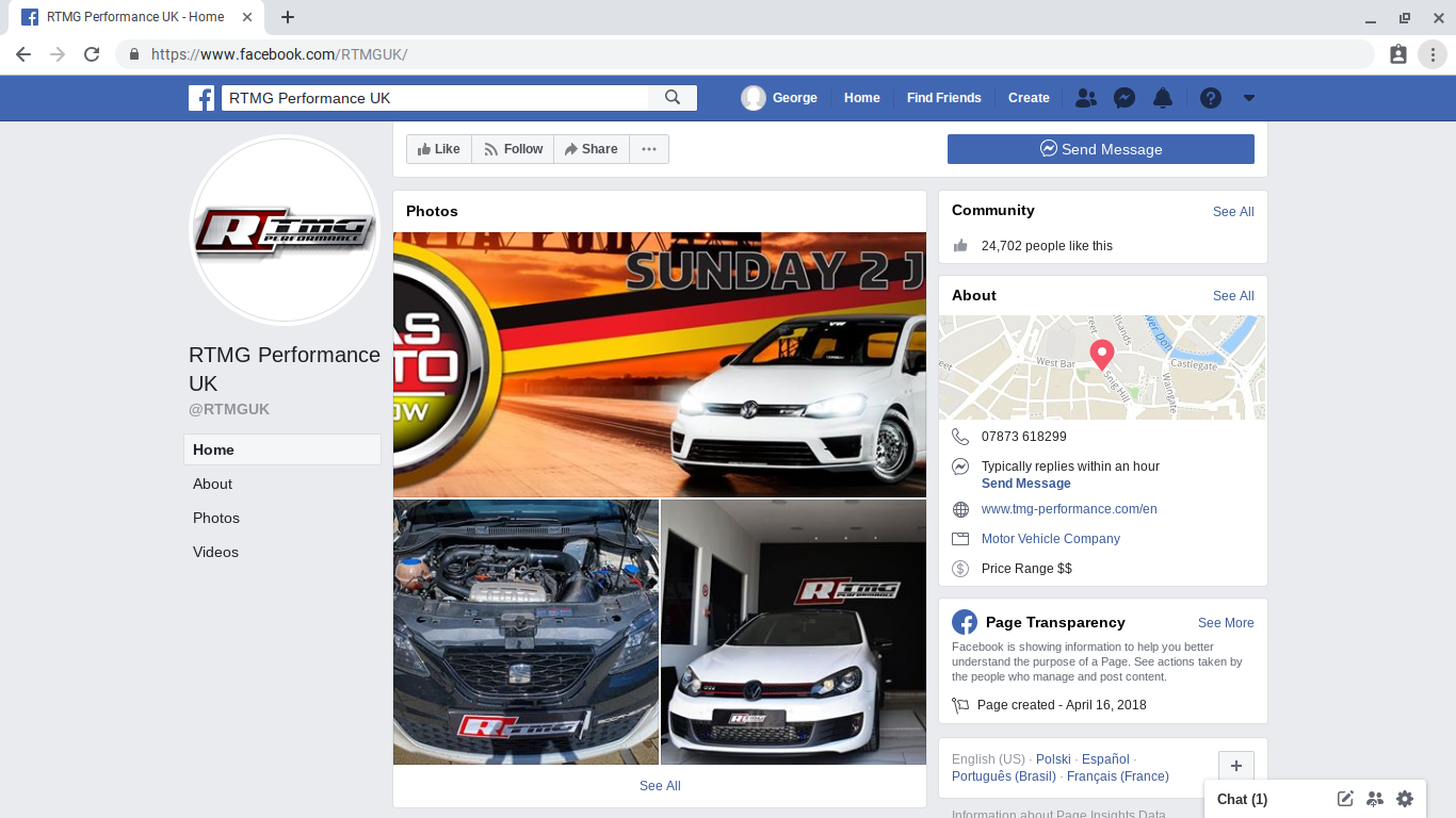

RTMG are in the UK now, and they know how to make Twinchargers go.......

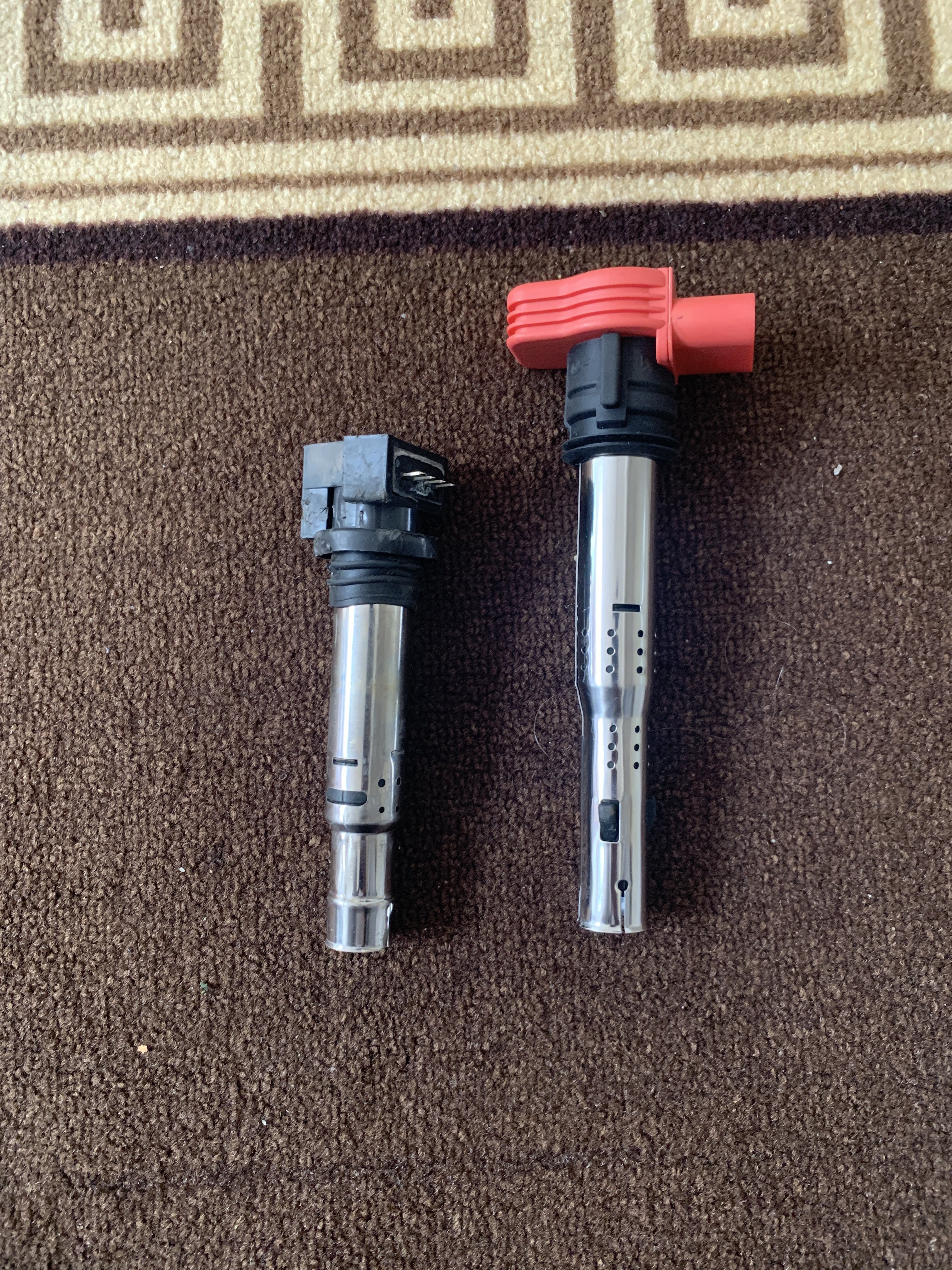

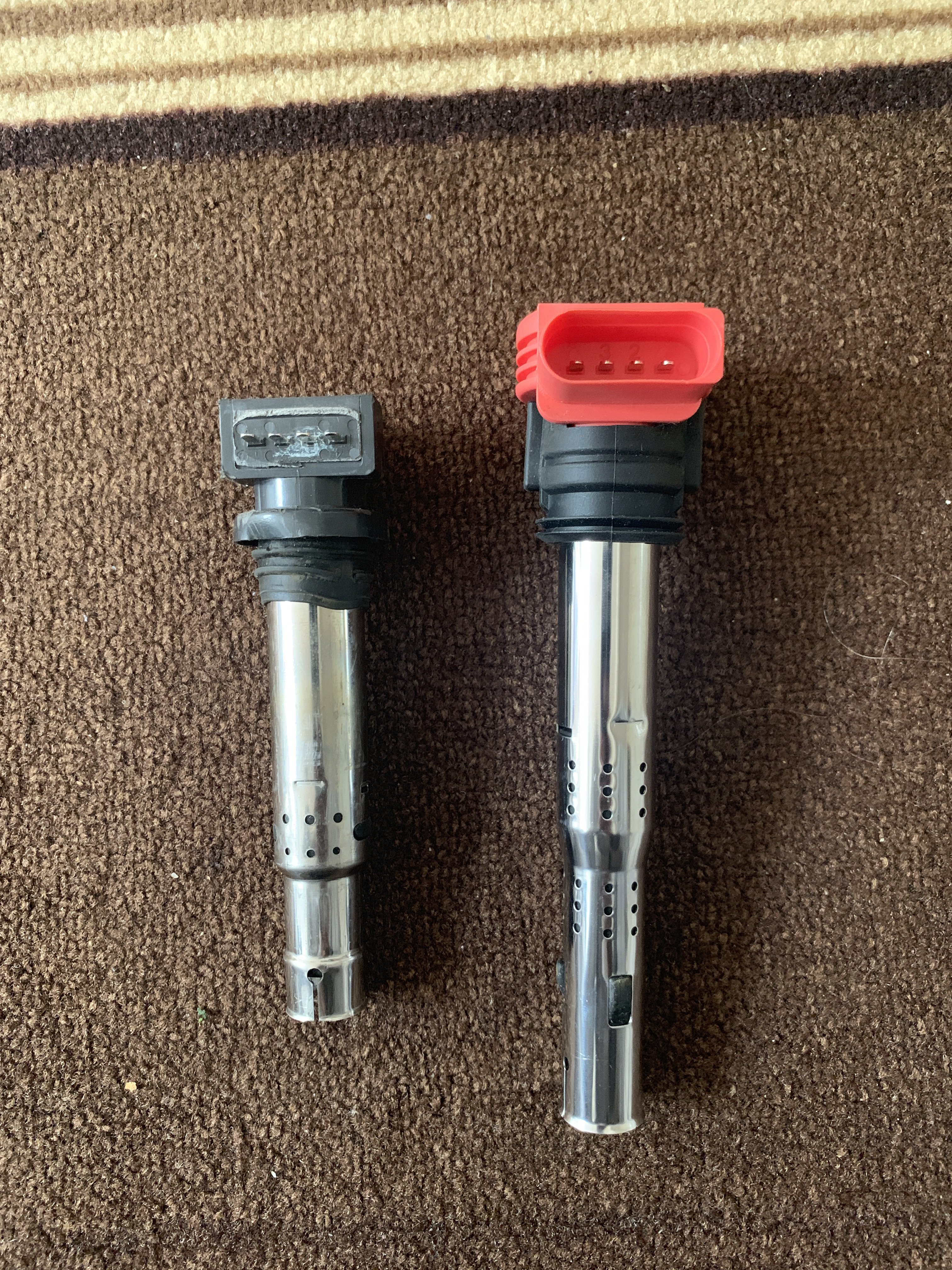

Hi peeps
i bought the coil packs and tried them today and they just dont fit.. they’re longer than the OEM and the connector plug doesnt fit at all
what am i doing wrong as i know many others have managed to fit these
1 hour ago, RezaVrs said:
Hi peeps
After abit of fiddling around and trying different methods i managed to get cylinders 2,3,4 replaced however cylinder 1 would just not fit due to the GFB diverter valve connector plug, placed the OEM coil in there and the car just wouldnt start... replaced all of them back to stock coils and still wont start
i give up
Hi peeps
What the hell is that one on the left?!
I think you’ve still got some of your coil pack on a loom under your engine.
You need to buy an adapter for extra space it needs to cover
Edited by LGM
The one on the left is supposedly the OEM with the broken pin cover that i accidentally ripped off.
Adapter for what?
is the one on the right the correct one?
Is it normal for the car not wanting to start immediately after having the coils changed?
Adapter for what?
Well yeh it looks like the right one, did you swap any wires over on the loom like I previously mentioned??
