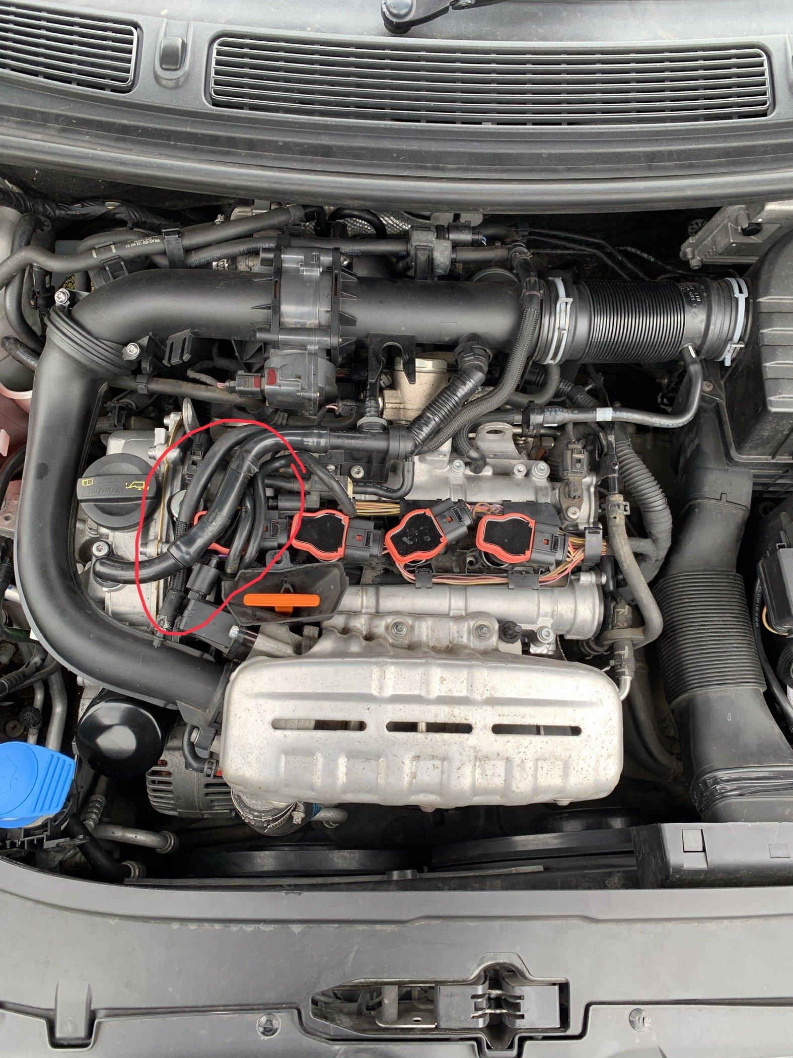

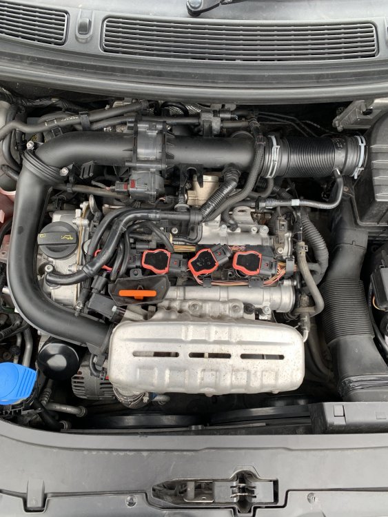

Heres mine with all 4 fitted unlike others
as you can see cylinder 1 is a real tight squeeze due to the breather pipe, intake pipes and diverter valve but its all worth it for sure!
not even a tiny bit of misfire now whatsoever! Works like a dream with the denso spark plugs

Are there any noticeable gaps where water could get into the plugs or are they completely sealed? It’s hard to see from the picture.
Does yours have the breather mod? or is that just a normal CTHE?
This is the CAVE breather pipe looks the same to me, CTHE / CAVE = Same breather pipe..

11 hours ago, Mickmartin said:
Superb!
I cant notice any gaps as such but as they’re longer and wiggle freely my mind isnt completely at ease till i forcefully have to get that £125 bracket :(

allow me to correct myself
Cylinder 1 was super difficult to install due to all the pipes highlighted below
one of them (main one which is pressing down on the coil pack in cylinder 1)  is from the oil tank, two click into the intake pipe and the giant diverter valve

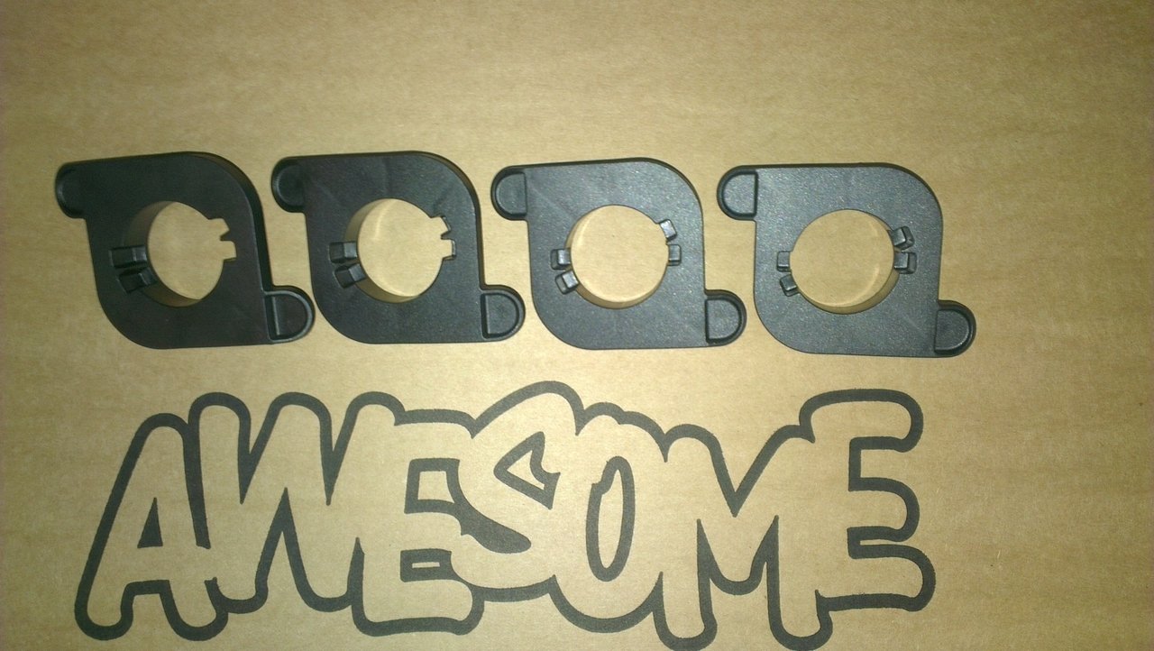

The Audi 1.8T and 2.0T come with single cow ration adapters for each coil, I’d be looking to make my own somewhat like them.

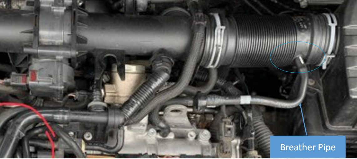

The 'Breather mod' as i understand it is the pipe highlighted in blue off your own photo (this was not on my CAVE originally) and appeared after the oil fixes.
The breather mod must be standard on a CTHE.
Isnt the blue circled pipe the same as the one you circled here? This is a cave engine right?
Wouldn’t these push fit adapters help keep the coils firm?
yes mine is a CAVE so therefore you have the breather pipe as standard on your CTHE

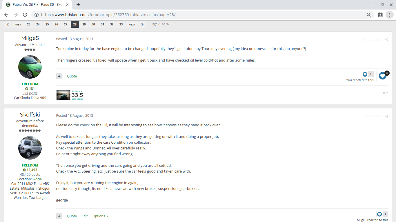

@Kobayashi
Strangely after CAVE engines were getting Breather Mods & Software updates, and then Breather Mod 2 & Software Update, early CTHE that were Oil Users then got a Breather Mod and Software Update.
That one surprised even me.
@MilgeS had the CAVE ownership experience, then bought one of the first  CTHE car & ended up needing a 2nd engine for that.
This would be interesting to know!
they’re £9 something from AwesomeGTI has anyone done this before?
