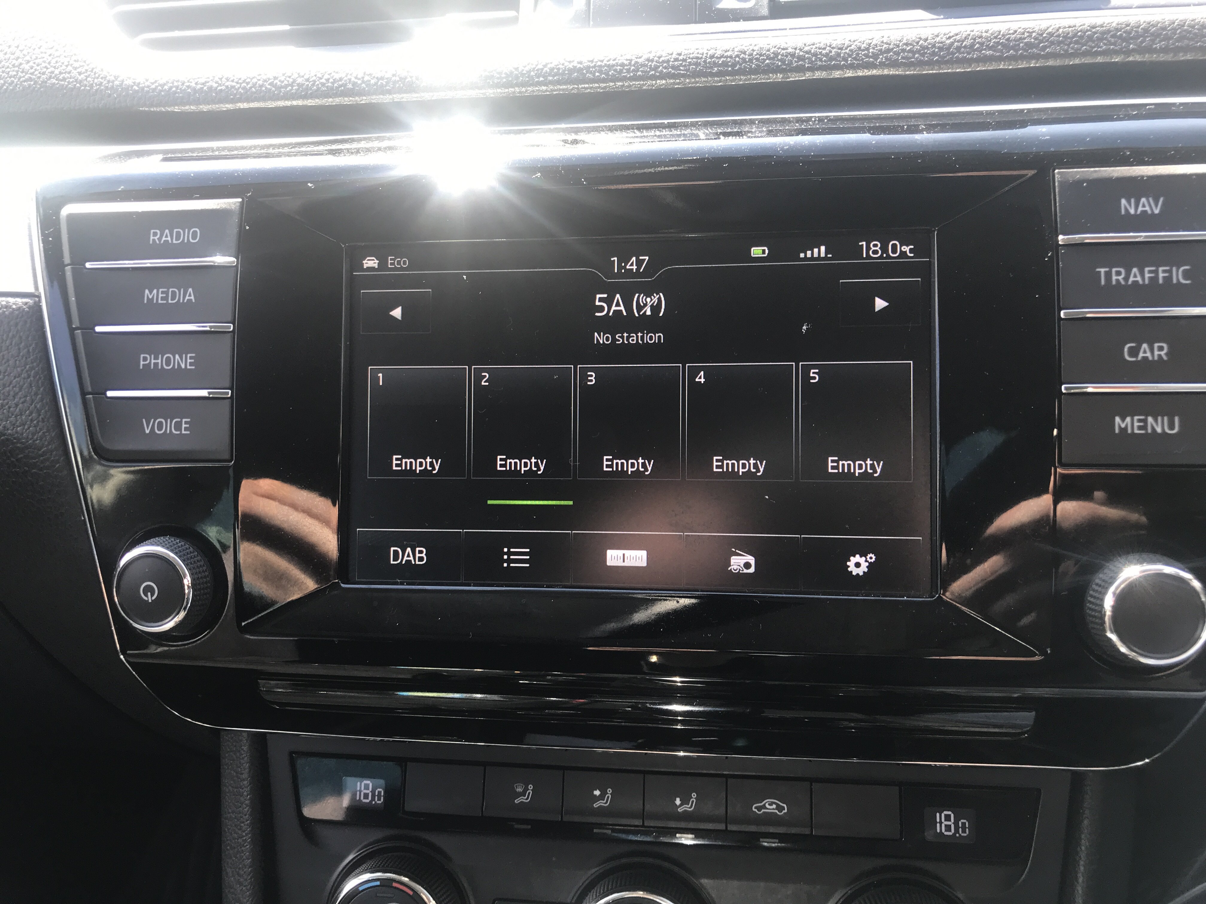

When trying to search for stations, I get...
No DAB stations
No AM stations
No FM stations (interference sound only)

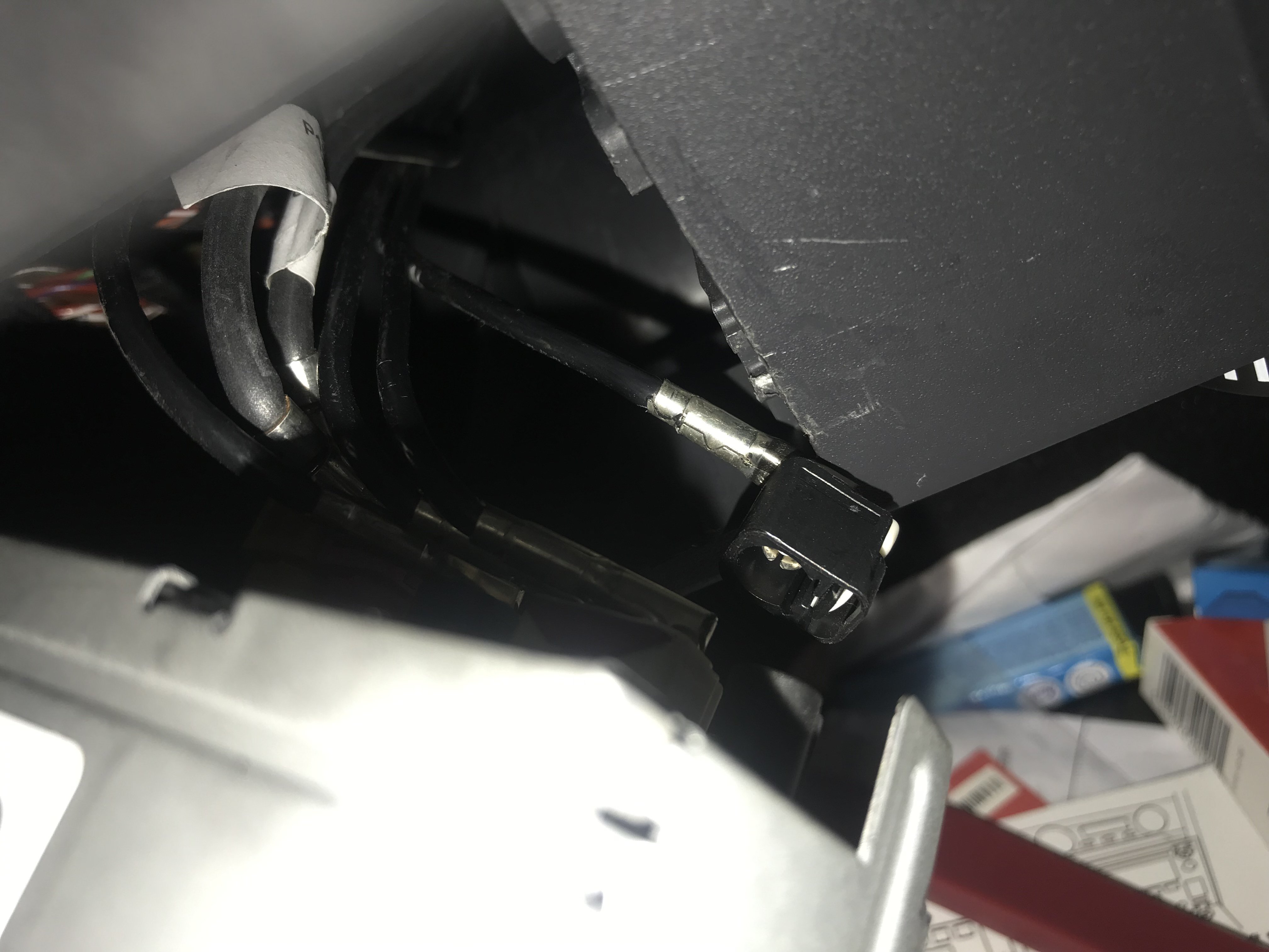

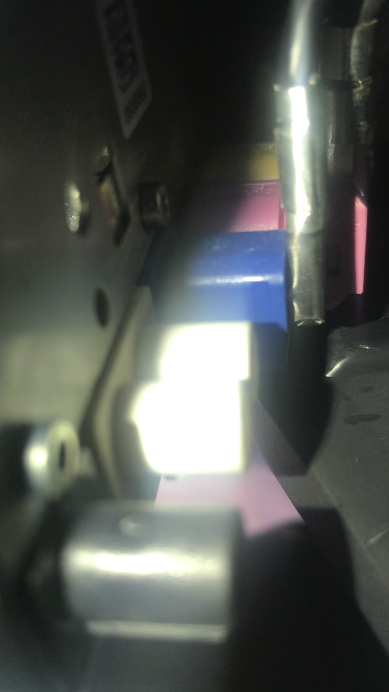

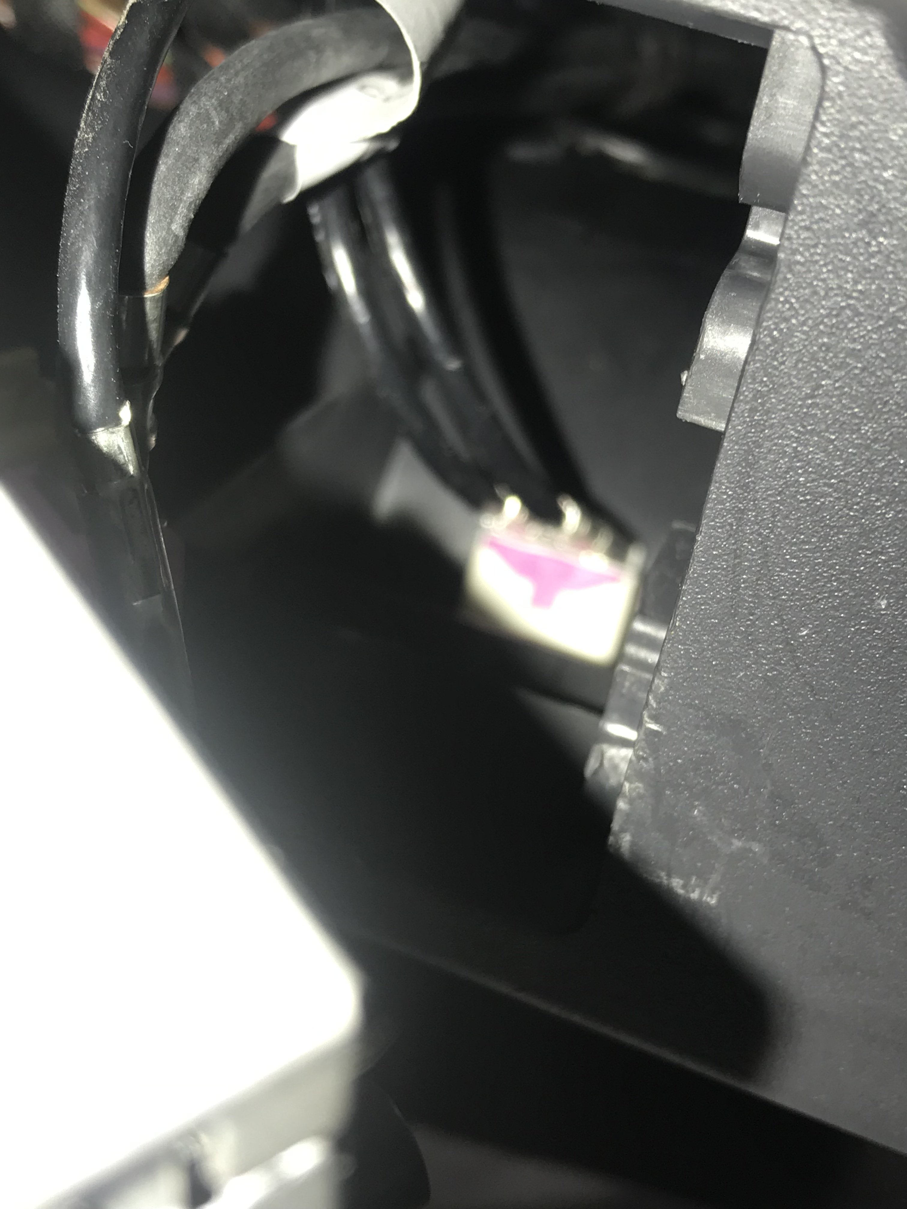

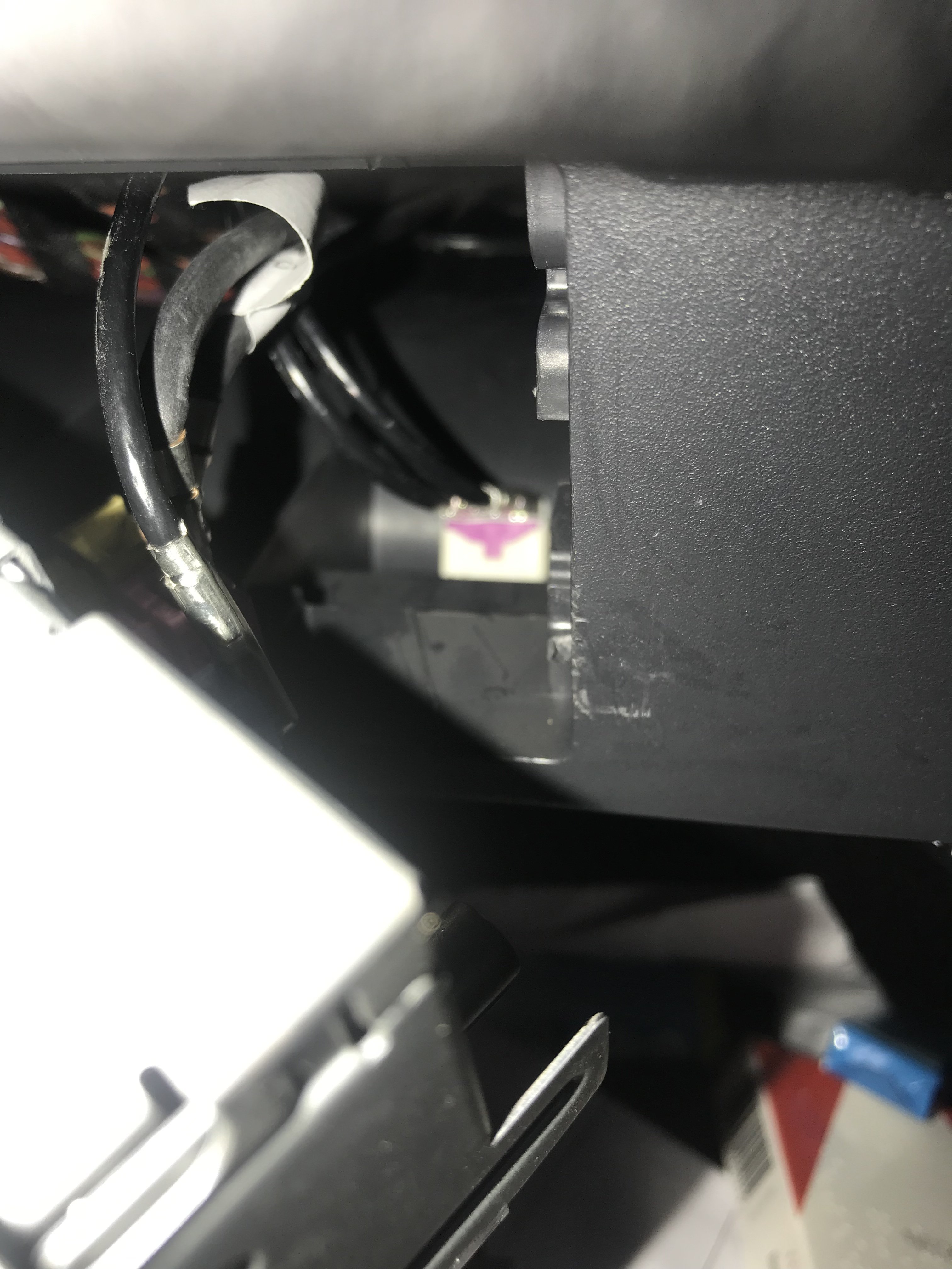

I pulled the glovebox unit out again, and had a look right behind. 2 of the plugs were out. Pics below. All working great, although I’d love to know if you can amplify the DAB signal as it can drop at times.
