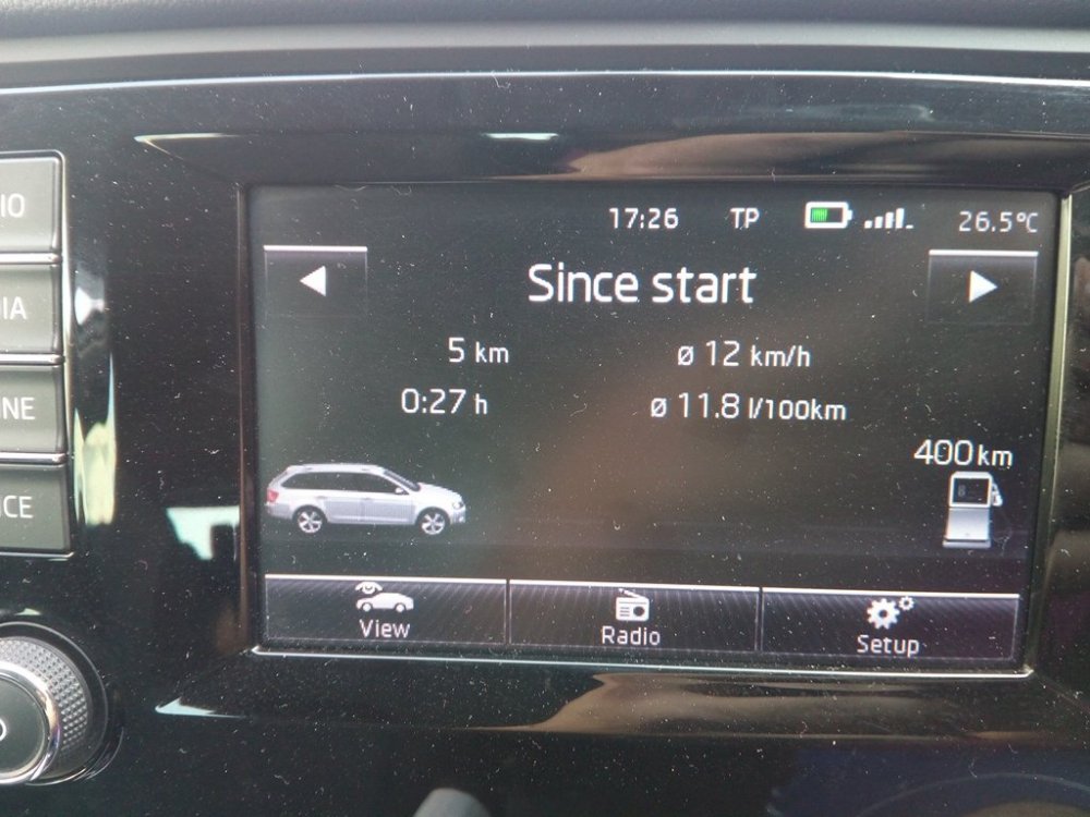

I have Octavia mkIII  2.0 TDI 2014 and the last 10 days I have wrong fuel consumption
I used to have 5.5 to 5.8  now is 7.5 and is the same driving
And when the car is switch on and the gear is on P the fuel consumption is rising up , can go up to 20 and sometimes more I used to do 750 full tank now is 650😵😌
Something is no good
And the rpm is normal
Can u help me please

I'm guessing the quoted consumption data is taken from the cars display? In which case they aren't always accurate.
Try making a manual calculation (fill the car up, reset the trip meter, drive until the fuel light comes on, note the mileage, fill the car back up, note the litres of fuel used to fill the tank, use this together with the mileage and calculate your miles per gallon, or kilometres per litre).
The fact you're now covering less miles to each full tank is suggesting something has changed recently.

Yes it's normal that your average fuel consumption will continuously increase if you are stationary with the engine running.
Think it through logically, it's a measure of how much fuel you use to travel 100km. If that would normally use 5 litres of fuel, you'll see 5l/100km. If you sat and burned 5 litres of fuel without moving first, then you've used 10l/100km.
As the cars display is live, it's updating continuously though, rather than waiting for you to drive 100km, so the numbers will look extreme and increase constantly if you aren't moving but the engine is running.

Were you looking at the long term figures before ?
5km at average speed of 12km/h is quite slow so you are likely to see high fuel usage.
