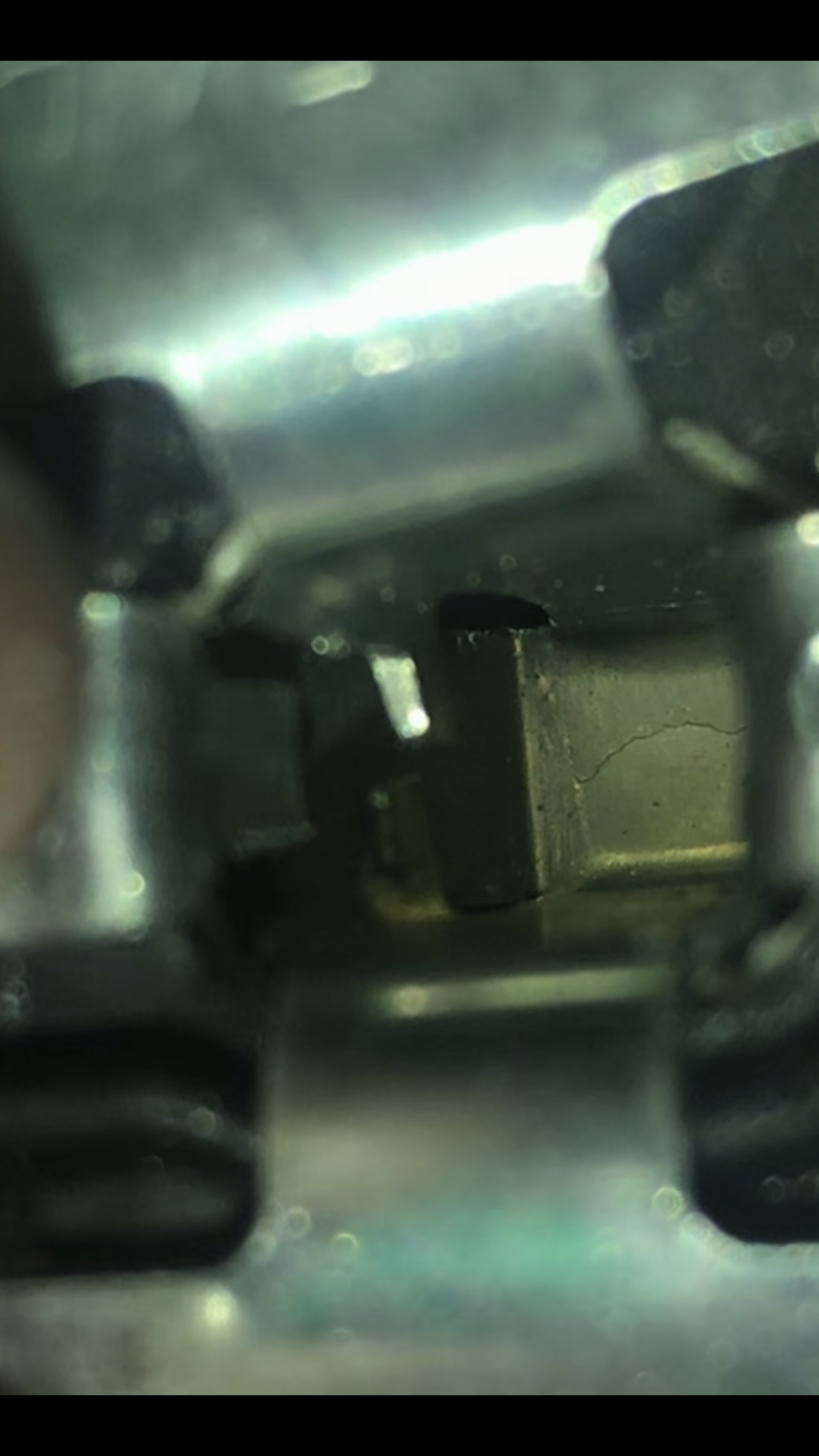

How do you remove Curtain Airbag Clips!
Tried to crimp either side inwards, no luck!!

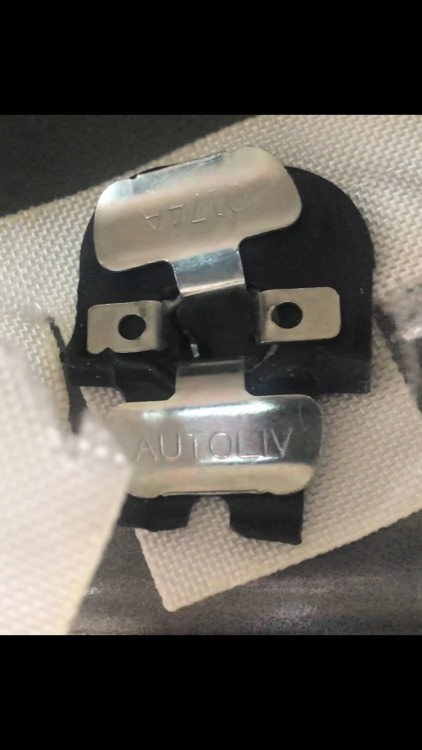

2nd pic is close up of inside the clip.
I mean it looks easy, but I’m must be missing something. Obviously they can’t be designed to just ‘pop out’ being a major safety feature.
Come on people. It’s just a clip.... 😆
I was told that on an Octavia II, the dealers have a toolkit with "special" tools for the removal of the airbag clips. A friend got a friendly breakers to remove them from his crashed car. There are tools you can find on the net for getting them out - this is just an example that claims it covers VAG cars and looks like what the breakers had. From what I remember, they had an angled thing that looked like a screwdriver. It had to be inserted, levered and then twisted to release either side of the clips.
Air Bag Removal Tool Kit - VW, Audi, Skoda etc
Just to follow up here. It was as simple as using long nose pliers inside the little circles, and crimping inwards & pulling outwards, which is not too easy in the space.
Now, I need 2 more of these retainer clip, or similar. Any ideas?
