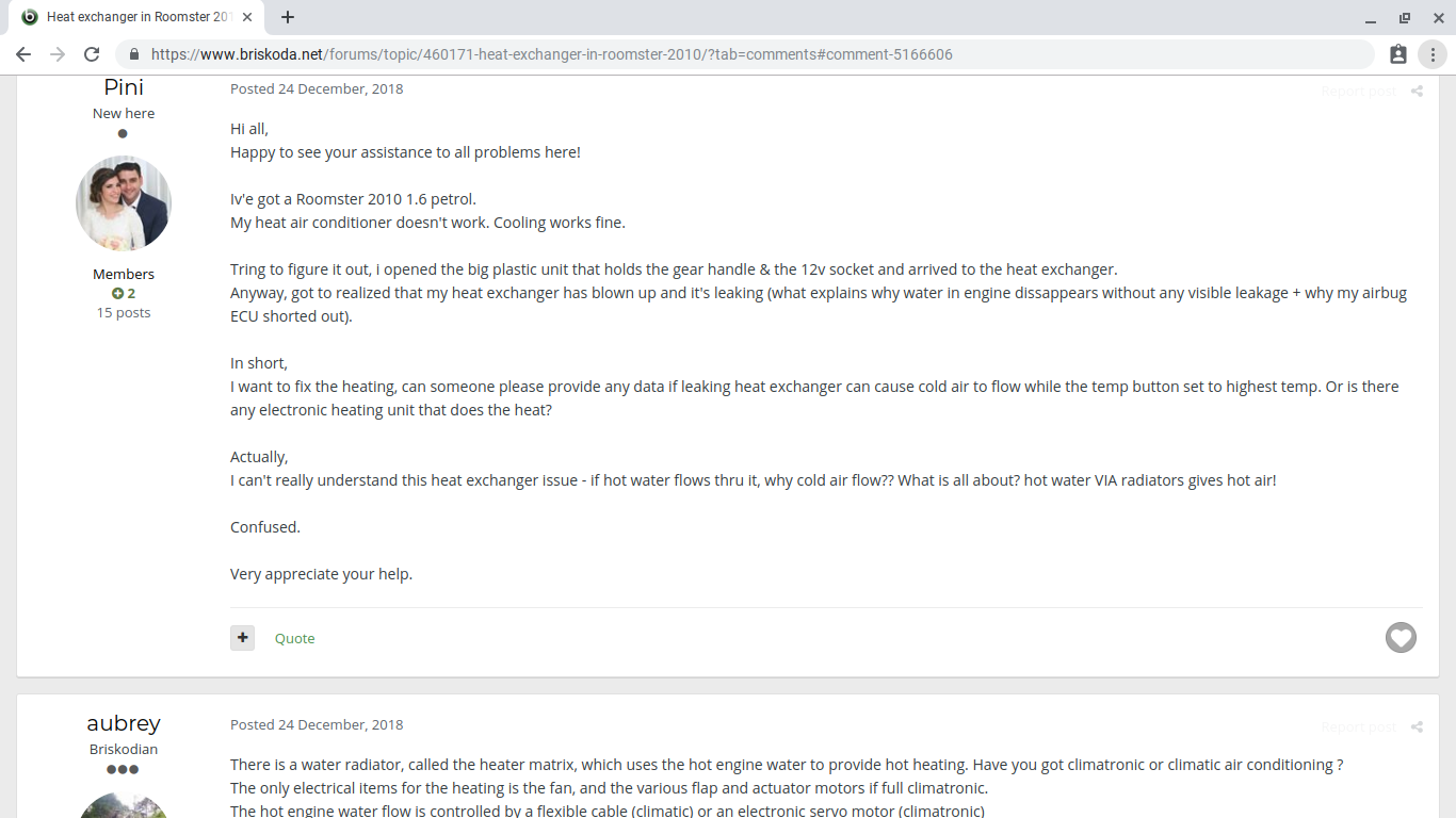

Yeah I would suggest you possibly have a few chaffed through wires. Finding them can be a nightmare as can repairing them. All the best with it.
