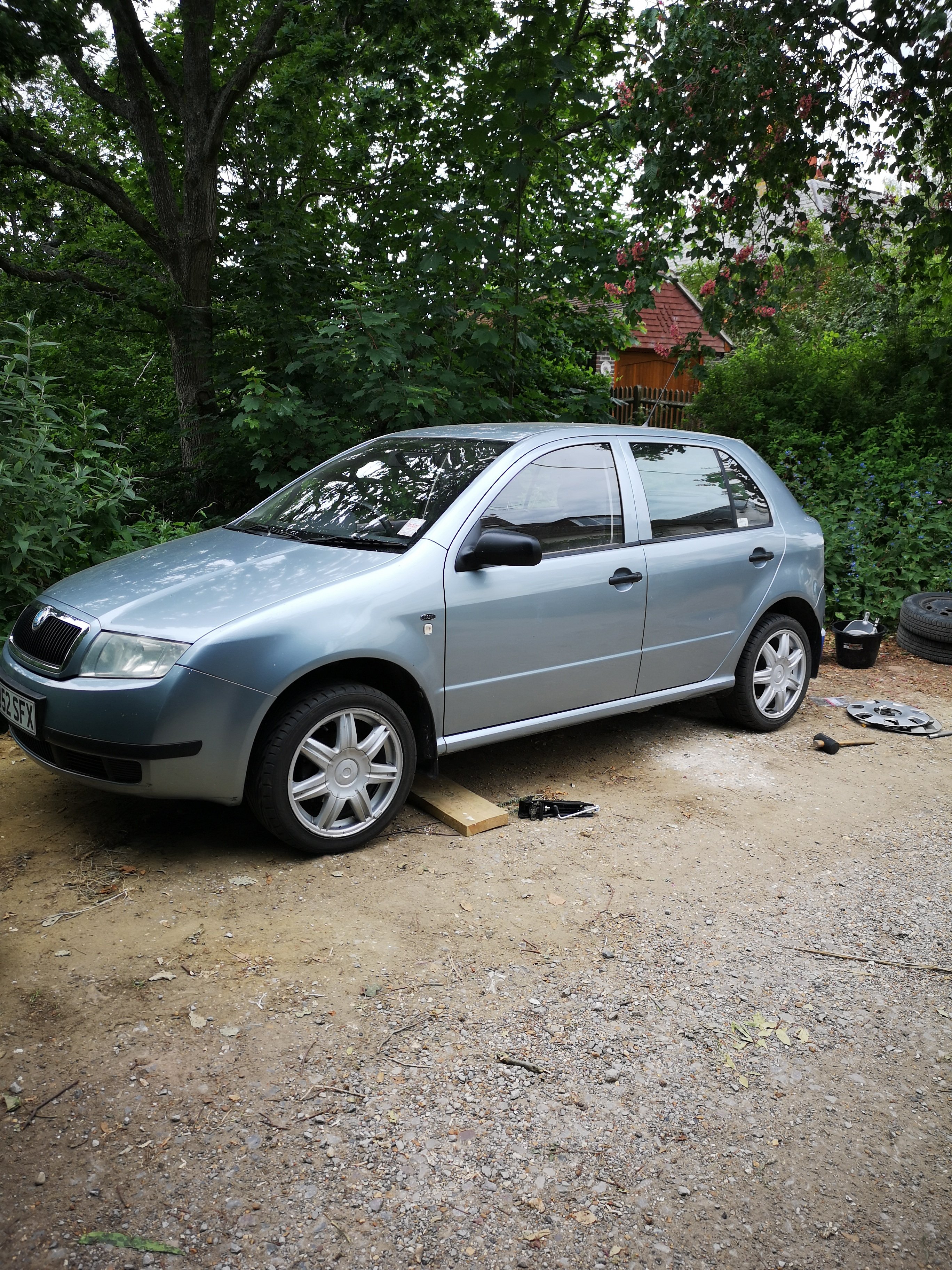

I have just bought a set of second hand alloys for my Skoda Fabia 2002 1.4. They are 16 inch alloys with 205/45/16 tyres. The alloys come from a SEAT LEON.
I fitted them to the car and on the first test drive I noticed a loud grinding and snatching sound from the front on braking, which becomes mainly presents itself when slowing to a stop.
The front brake discs have a deep lip to them. There is plenty of material on the front pads.
After a further test drive it was noted that the front nearside disc felt much warmer than the offside suggesting some sort of binding problem with the caliper maybe?
Any ideas if the fitment of the wheels has caused some damage to my braking system. Does fitting alloys to a car which never came with them from factory spec cause damage to the steering and suspicion set up/geometry, and would cause the symptoms I am describing. Seems more than a coincidence that my front brakes developed the problem so quickly.
