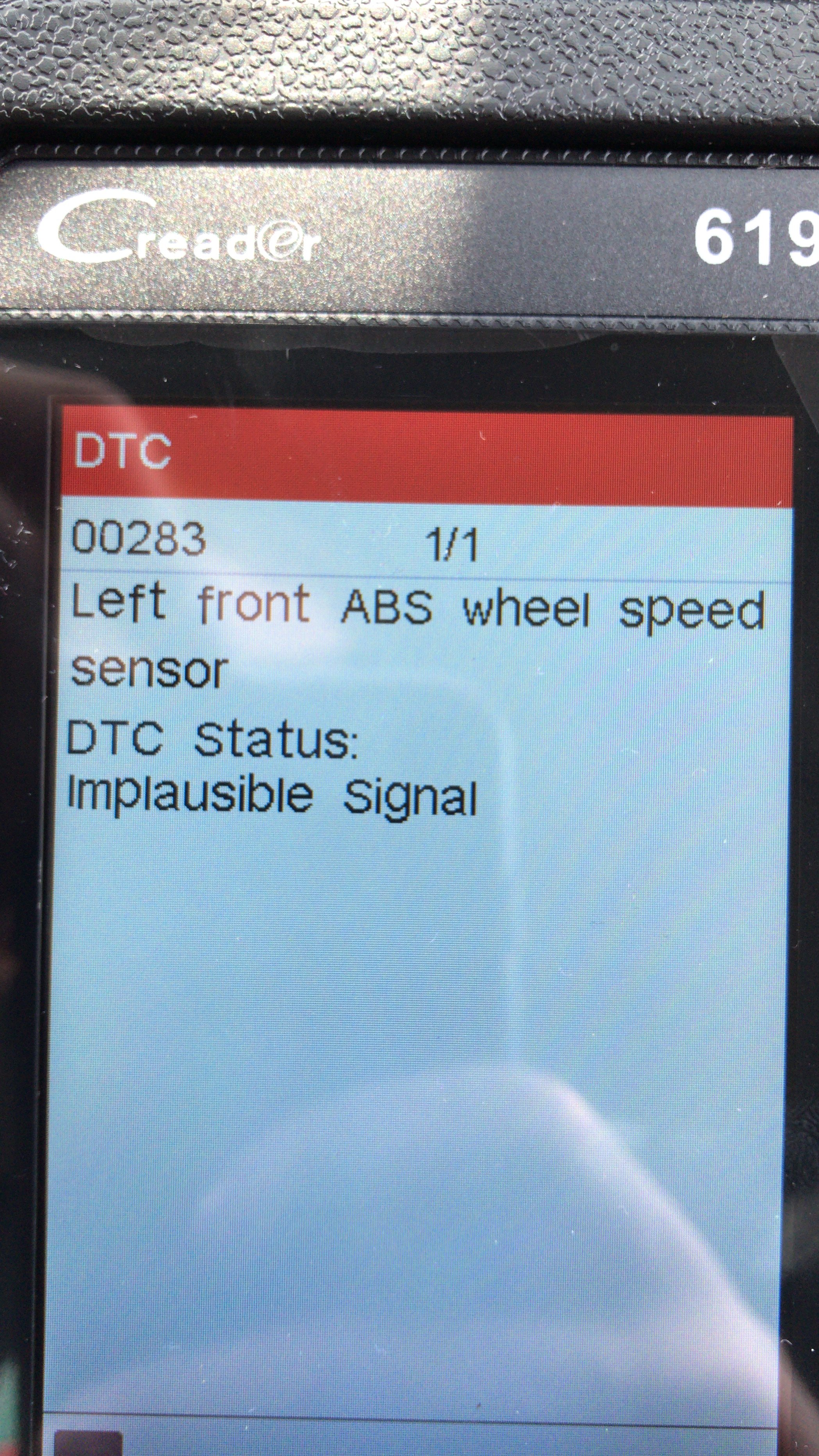

I’ve checked the fuse and it’s fine, coming up with front left abs speed sensor, does anyone know if the sensors from the vrs are the same as the 1.4tdi? If not then I’ll order a vrs one, thanks

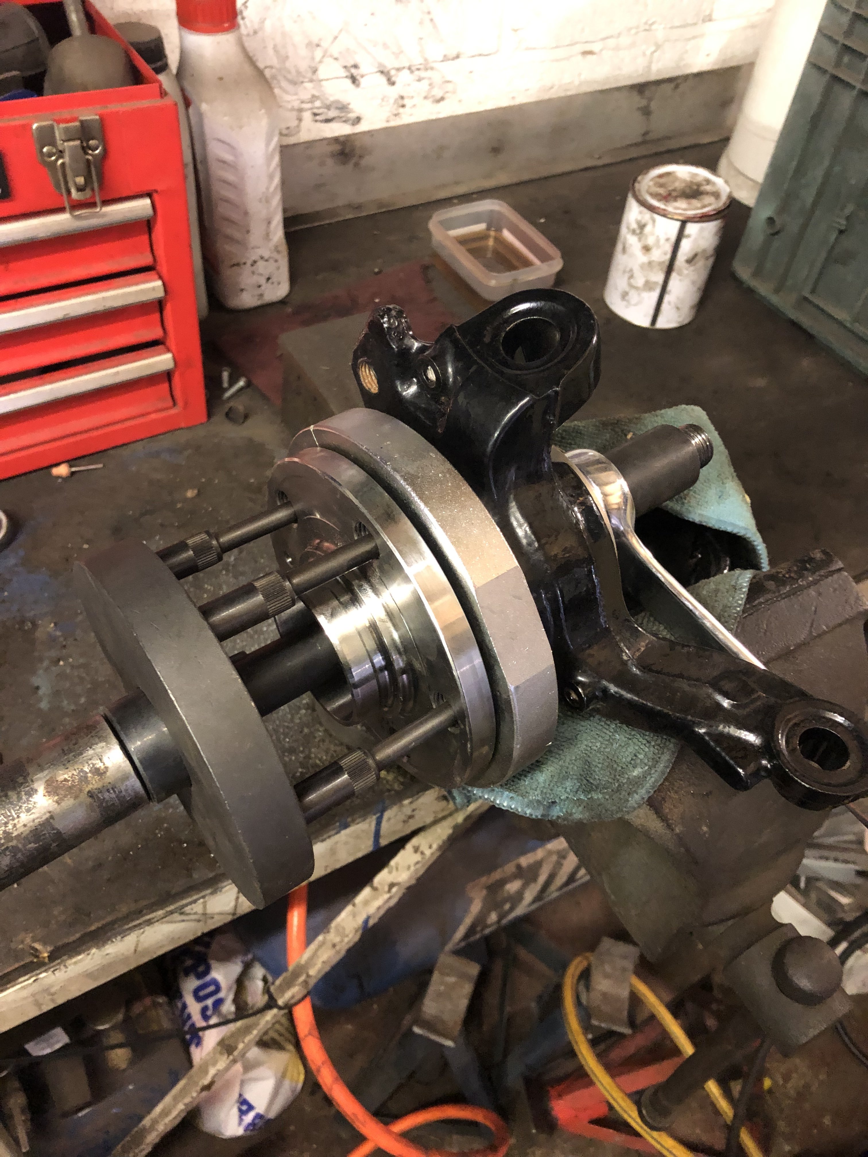

Can you please clarify what is now fitted to the car?
Secondhand vRS wheel bearing housings with the bearings and ABS sensors they came with? Or what?
I think what you are calling 'hubs' is what Skoda call 'wheel bearing housing', item 7/7A here? https://skoda.7zap.com/en/cz/fabia/fab/2006-453/4/407-407010/
It can get confusing because if you look at item 8, Skoda call that the 'wheelhub with bearing'. That's the part with the magnetic ring on the inner face, which the ABS sensor picks up.
This part must be fitted with tooling that avoids pressing on the front face, as that normally damages the bearing and/or fails to install it far enough into the wheel bearing housing.
Did your troubles described in the first post follow a 'wheelhub with bearing' change on the nearside front?
Said tooling...
Hub swap should be straight forward, nothing tricky.
Need to know what the fault code is.
It was the wheel bearing housing with the hubs and bearing in and they were working when they came off the vrs but I’m having the same fault code come up
Implausible signal is more than likely a faulty air gap or pick up.
