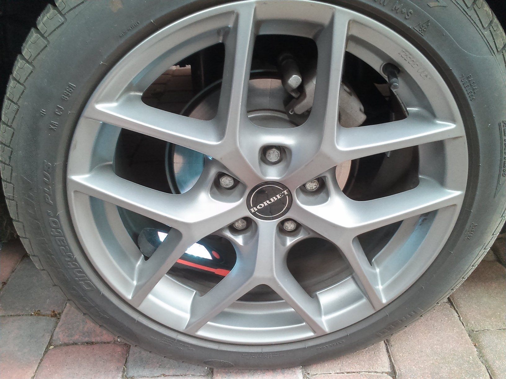

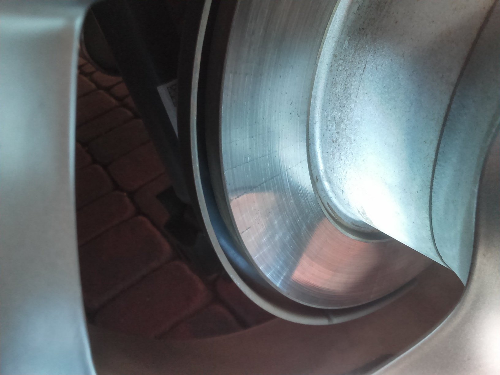

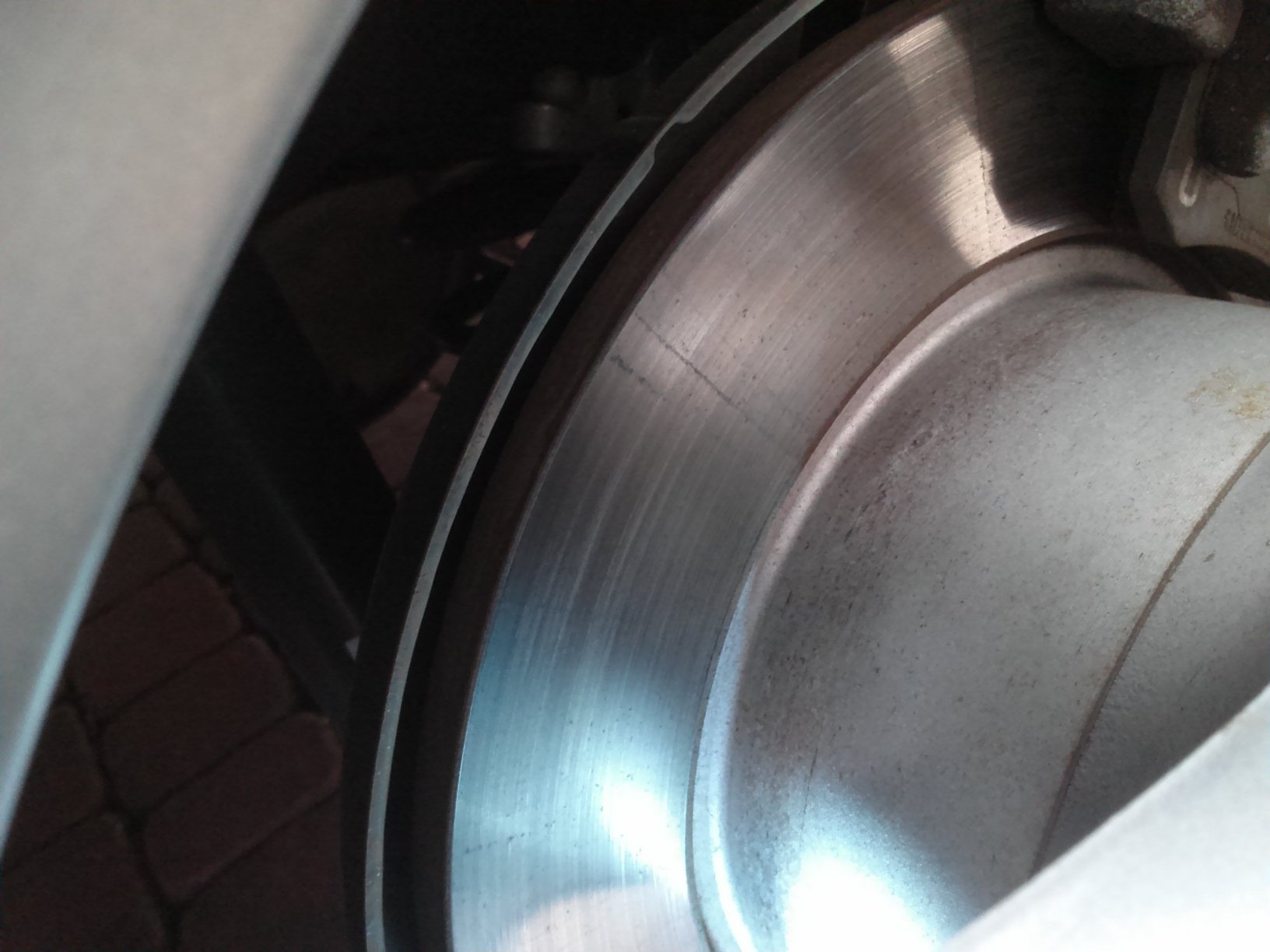

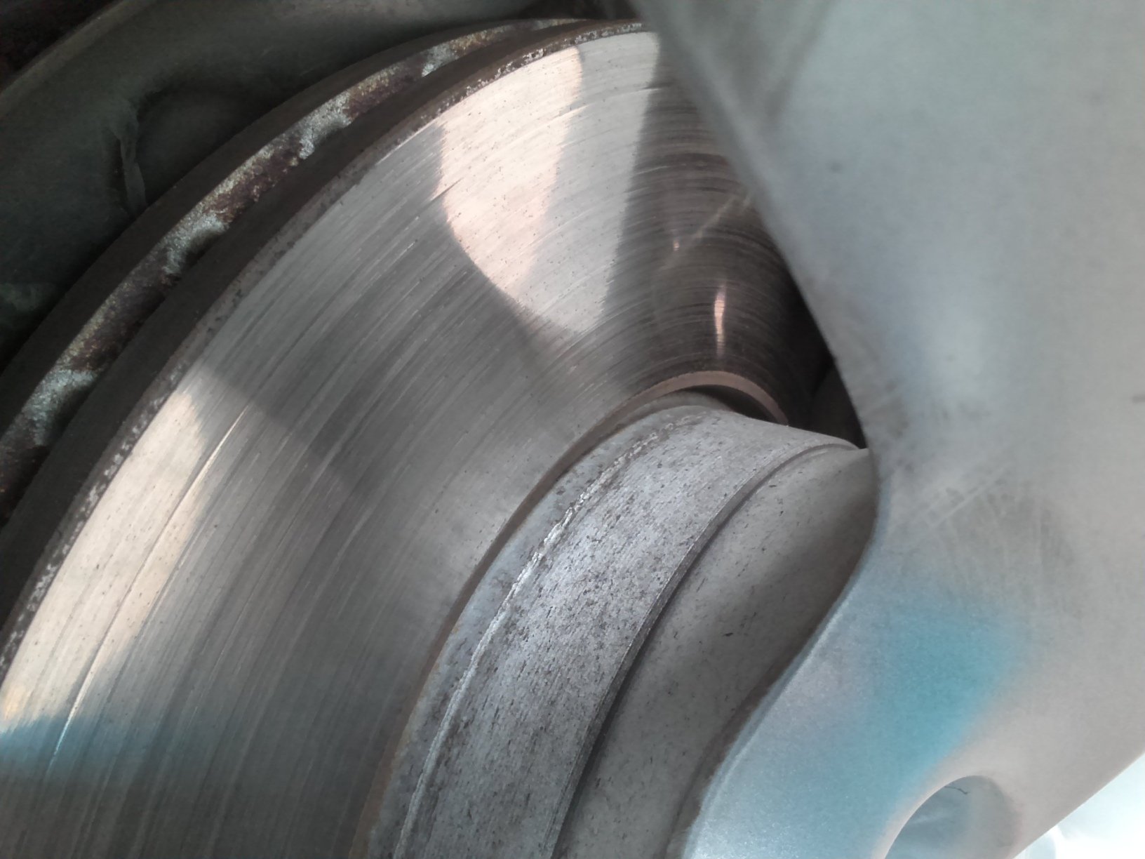

I was cleaning up the wheels today and noticed odd brake disc wear.  Does this look like anything to worry about? For comparison the first is of the front(changed order when posted)
No I didn't forget the light inside the rim! :)tmp-cam-339037482.thumb.jpg.8a4bc1b8eb17af14df5498cd8a264920.jpg
Edited by hirez
Pics wrong order
they look fine to me.
Great. I have just never seen radial stripes wearing on discs before.
Thanks
It’s just a mark left where the edge of the brake pad has been at some point.
Those discs are A1 perfect.
Edited by classic
Totally agree  with the guys - the disks are in good visual shape.
Radial marks are where the pad has made contact for longer time - i.e. on parking brake.
Thanks for all the positive feedback.  Now that I think about it it makes sense being that the hand braked is applied there... Some just seemed unusually deep.   I also wondered about the front (I see no problem) but I really hear them grind through the front at low speed.   This car just has really no sound insulation. ... But I has grown on me, but I wonder if I might have been better off in the long run with a bigger motor:)
