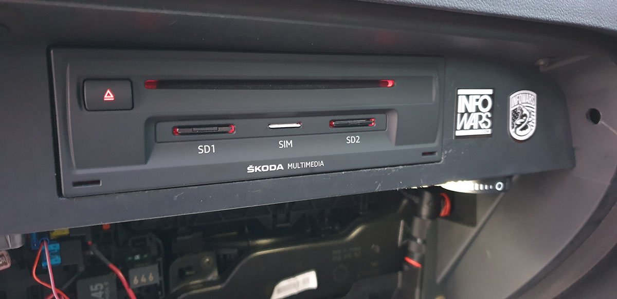

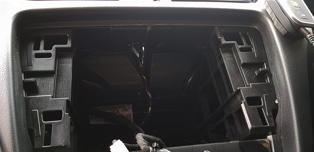

show him this... screen removed, nothing in there..

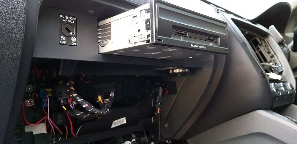

headunit half out, this controls everything infotainment.
back in situ
you dont need to remove the glove box to get the head unit (the brain) out. i do as i have added extra wiring at the back.

you only need four of these...
VW-AUDI-RADIO-CD-REMOVAL-PINS-TOOLS-KEYS-FOR-BETA-CHORUS-CONCERT-GAMMA-2-PAIRS
its very easy
